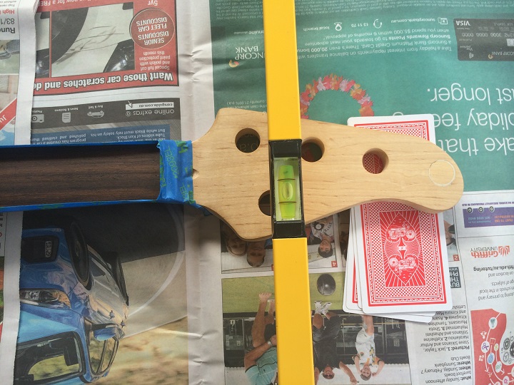

    Pic #1 & 2 – The FB level and ready for the pour. The playing cards were used to level the board. (The playing cards are a part of my tool box as I use them when I need a very thin shim. Hey, paper is made of wood and the cards won’t compress or deform)

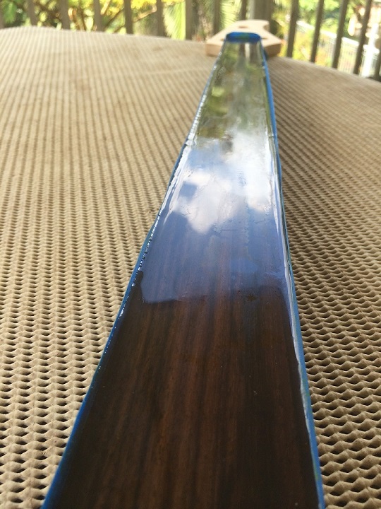

    Pic #3 – After the pour

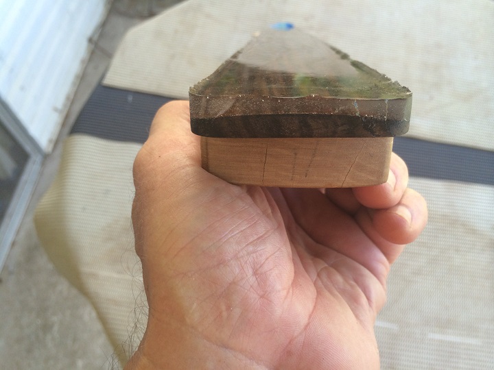

    Pic #1 – The thickness of the resin, you can also see the sharp edges of the meniscus

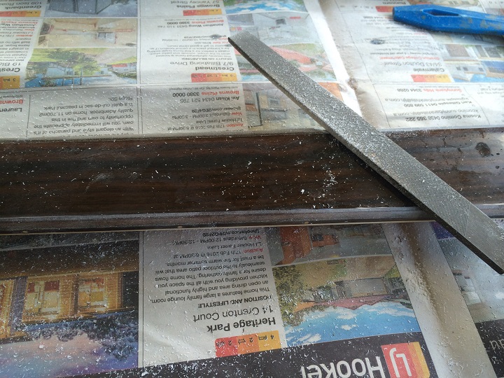

    Pic #2 – Filing down the edges
    Pic #3 – After about 45 minutes of sanding with 80 grit this is the result!!

    nice tutorial cheers Rob. Wow that epoxy looks up to 5-6mm thick.
    So when you sand with finer paper will it be transparent ?
    I'm very interested in how you prepped and poured the epoxy. I am using some epoxy resin for a different project. A new outdoor bar I am covering the bar top with beer caps and want to fill all the gaps with clear epoxy resin.

    Whoa. That's a whole lot more epoxy than I was expecting. Glad it turned out well, Rob.
    I'll ask some more questions when I collect enough lids !
    Thanks Warren, it will bit a little thinner by the time I have finished. I will be sanding through the grits to 2000 so I am hoping for a fairly nice finish.
    Thanks Pabs. I wanted it fairly thick, firstly because I needed to fix the bad radius job I did originally, and secondly, not knowing how it will last I wanted to leave enough resin to be able to re-dress the FB a few times if I have to. It might be over-kill, time will tell.
