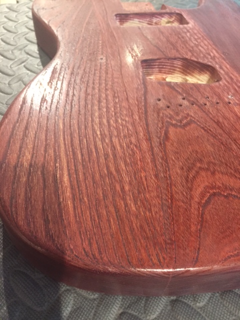

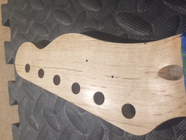

    Update
    I've decided the ding can stay. If i sand it back the edge is going to look wonky. If I fill it, I take the risk that the patch will look worse than the ding. It's important to me that I finish this guitar in DT. What the heck, its on the back, the build is only for me, the colour is dark enough to hide it and I'm not trying to win any awards with it.

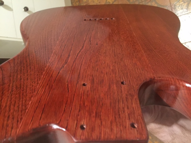

    Its been a week again and the humidity has been nice in Brisvegas, so it was time for another coat of DT.
    The last stain coat had dried with patches of gloss, so I gave it quick light sand with 400.

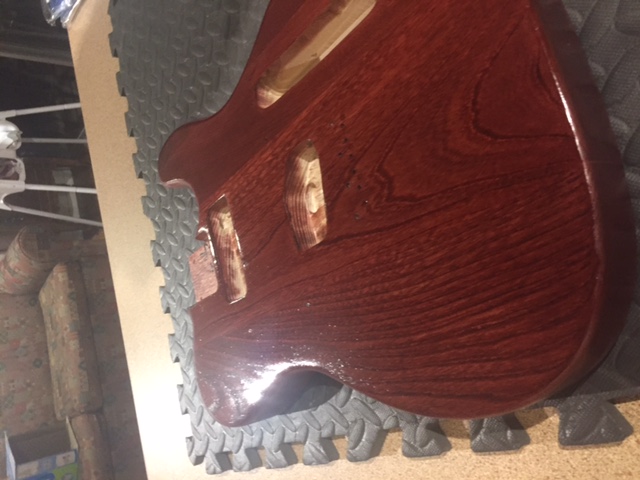

    And the final stain coat has cone on. Its still wet but you can tell that the stain has "matured".
    I may give this one a bit longer as storms are predicted this week. but nevertheless it will be on with the intensifying coat!

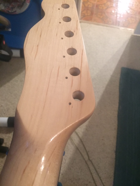

    The neck got another thin dose of neck finish.
    I think thats three neck coats in all. I know that's enough for DB, but I'll see how this one dries.

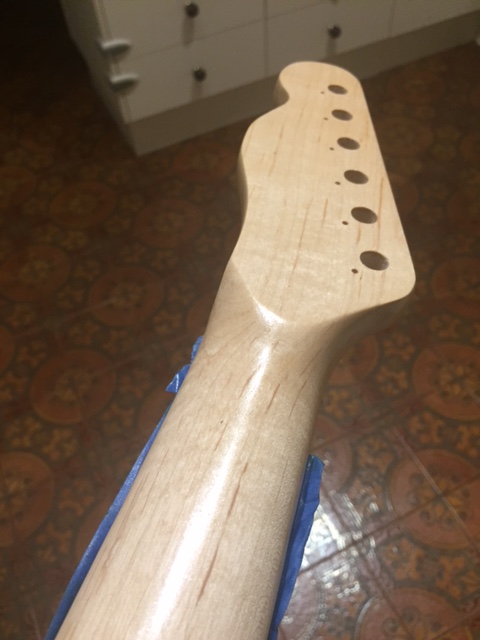

    Neck was peppered with dust particles....damn particles...not sure if you can see them in the pic.

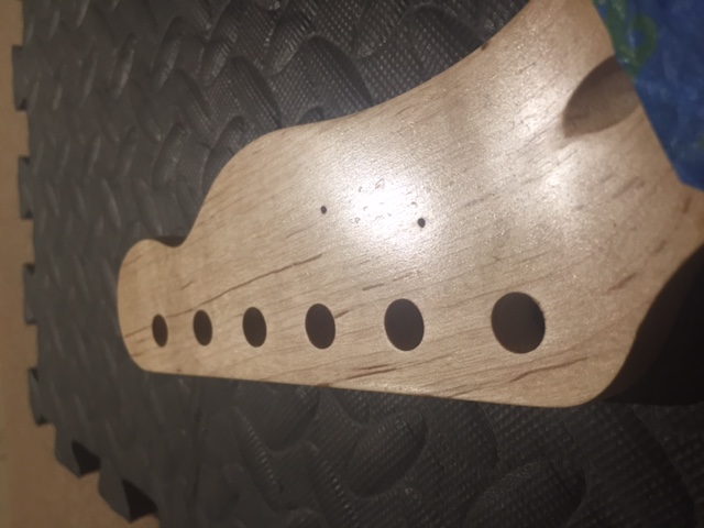

    0000 Steel wool applied gently, wiped clean
    new coat of DT final neck coat applied.....oops didn't take a pic, but she looks sweet.

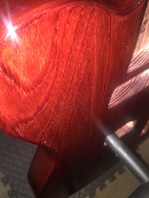

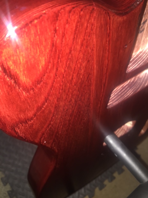

    The body wont be taking any more stain. gentle sand with 2000 grit to even out and first intensifying coat applied.
ID:	10587Click image for larger version.
    Looks good when wet. I think i accidentally applied too much. We'll see after a week.....or two....hmmmm

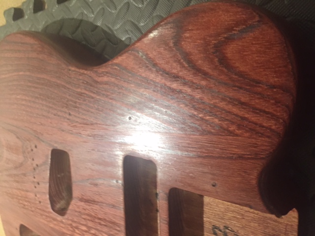

    Update

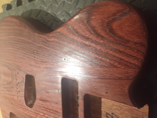

    Body
    Wet and dry sanded lightly with 600 grit, next Intensifier coat applied

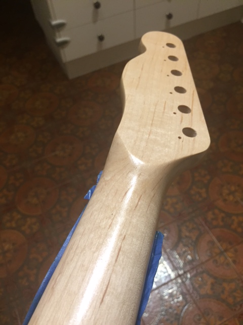

    Neck
    0000 steel woolled the bumpies out of it
    Applied another DT Neck coat
