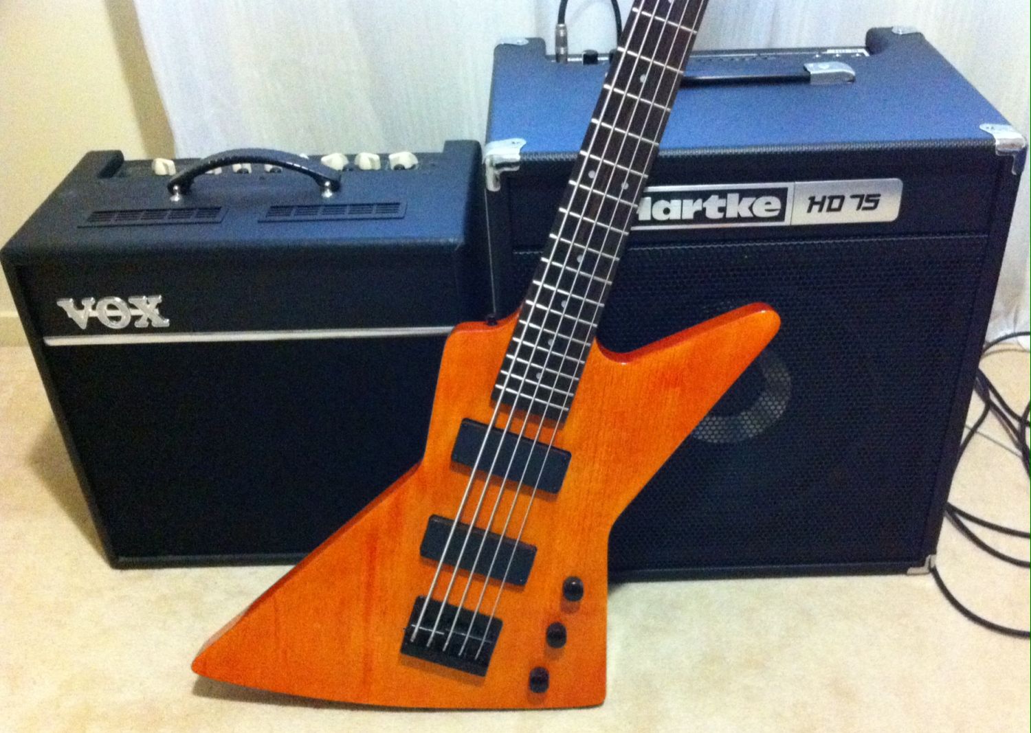

    Thanks Robin, may convert a few people yet. Once you get over the big angular look the shape fits like a glove and is easy to play sitting down or standing up plus the shape provides more balance when standing. Mind you this one is super long and therefore headstock heavy and being only 172cm tall it is a full stretch for me to reach the farthest tuning peg from a normal playing position.

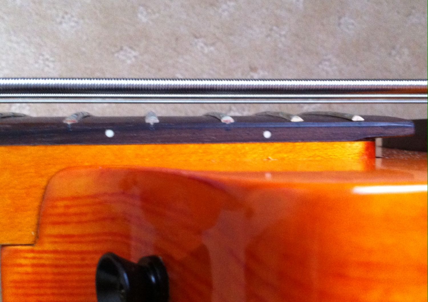

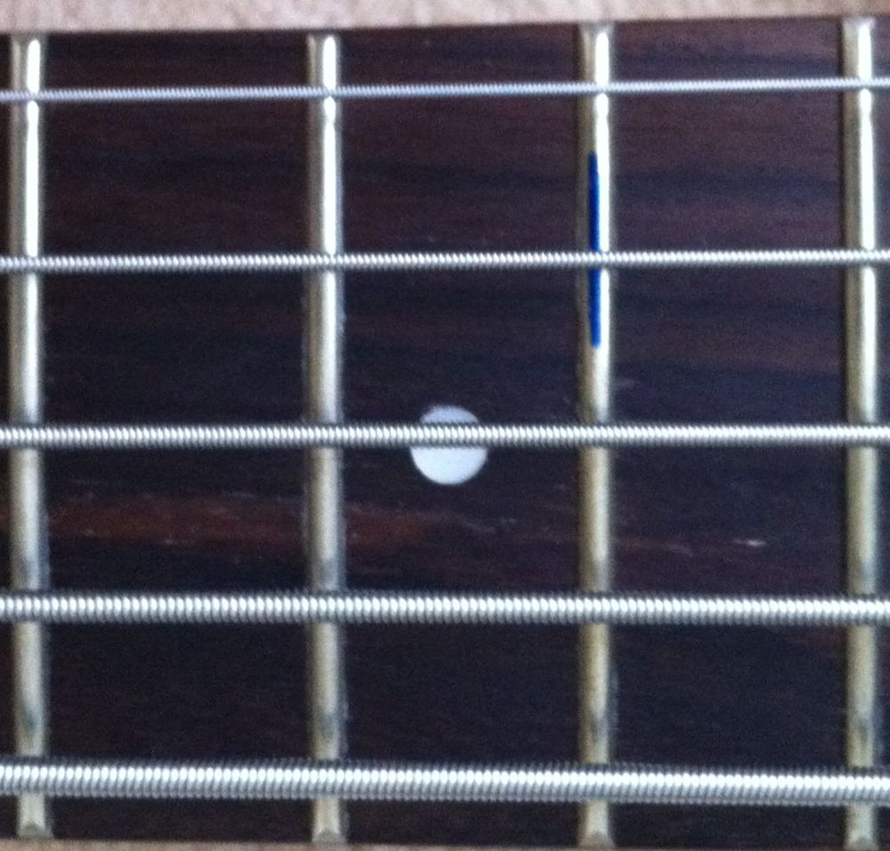

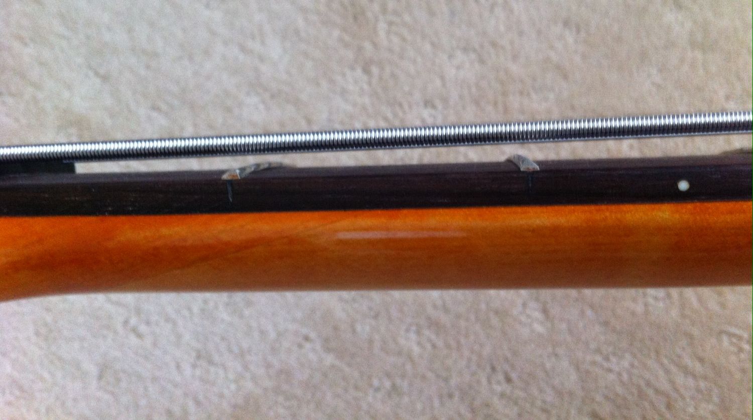

    Had DB do the neck setup on the EX-1 and highly recommend that service to everyone as that axe's neck & action are perfect. On this one there were a couple of frets sitting a bit proud higher up the neck and have given them a whack with a rubber mallet on many occasions that barely made any difference. The most annoying fret was around 15th where a note fretted at 13th or 14th on the D & G would buzz and ended up having to attack it with a file and sand paper to remove the high spot.
Name:	Fret to be levelled.jpg

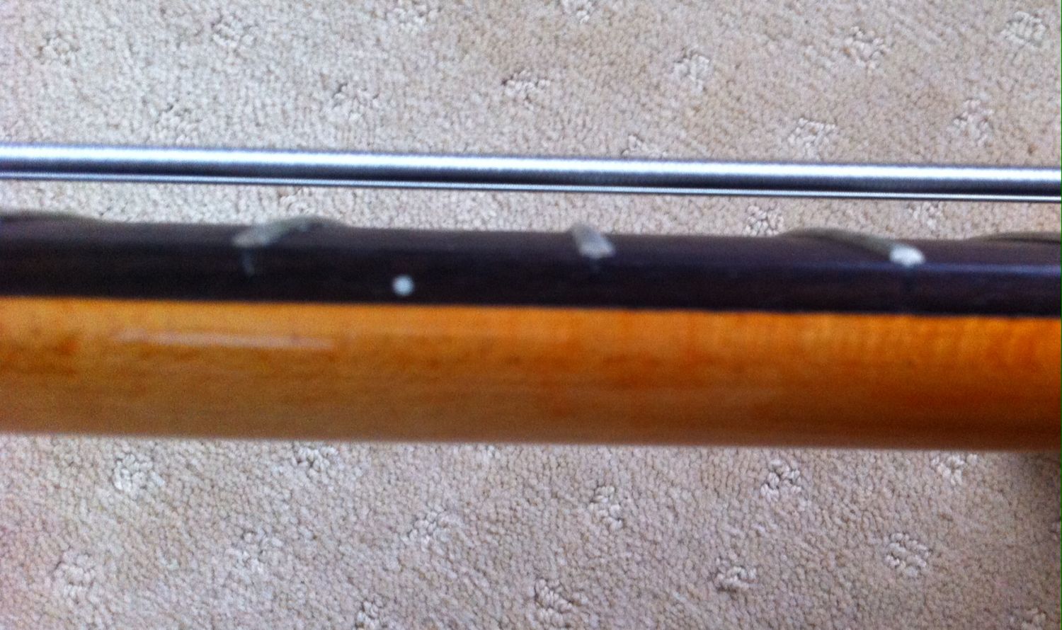

    Next job was to do something about the action as it has been a bit higher than my usual preference however truss rod had been tightened up as far as I felt it would go with breaking something. Time to loosen it off and let it sit for a few days then gently bend it back whilst slightly tightening the truss rod to bring things back to a dead flat deck.
Name:	Action at nut.jpg
ID:	14452Click image for larger version.
Name:	Action mid neck.jpg
ID:	14453Click image for larger version.
Name:	Action at the body.jpg

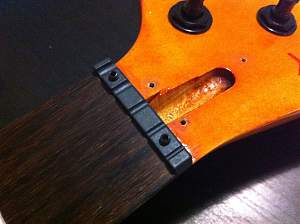

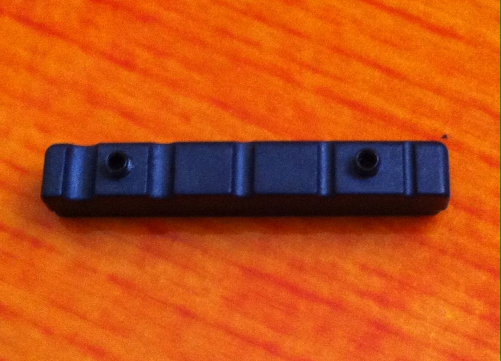

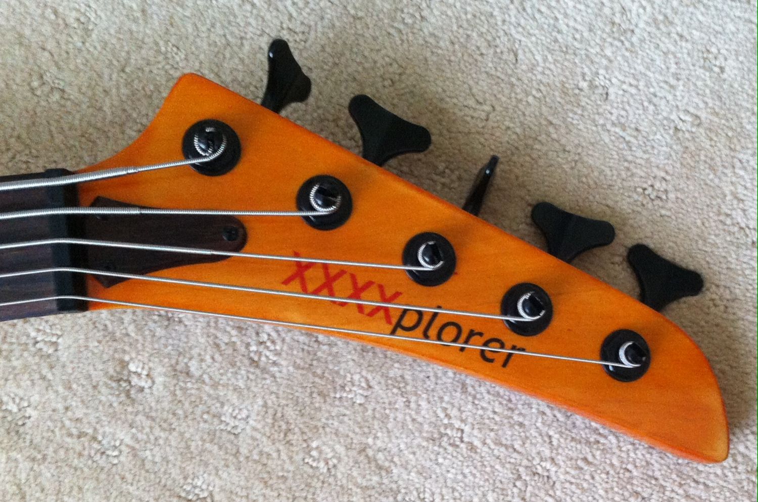

    Next Mod was to replace the stock plastic nut with one of those adjustable ones that I bought on eBay from an Aussie supplier. They are actually designed for a Warwick Corvette Streamer 5 string model and had change out of $40, bargain.
Name:	Headstock old nut.jpg
ID:	14455Click image for larger version.
Name:	Original plastic nut.jpg
ID:	14456Click image for larger version.
ID:	14457Click image for larger version.
Name:	adjustable nut installed.jpg

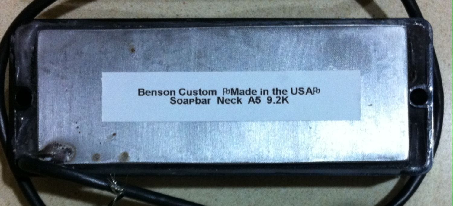

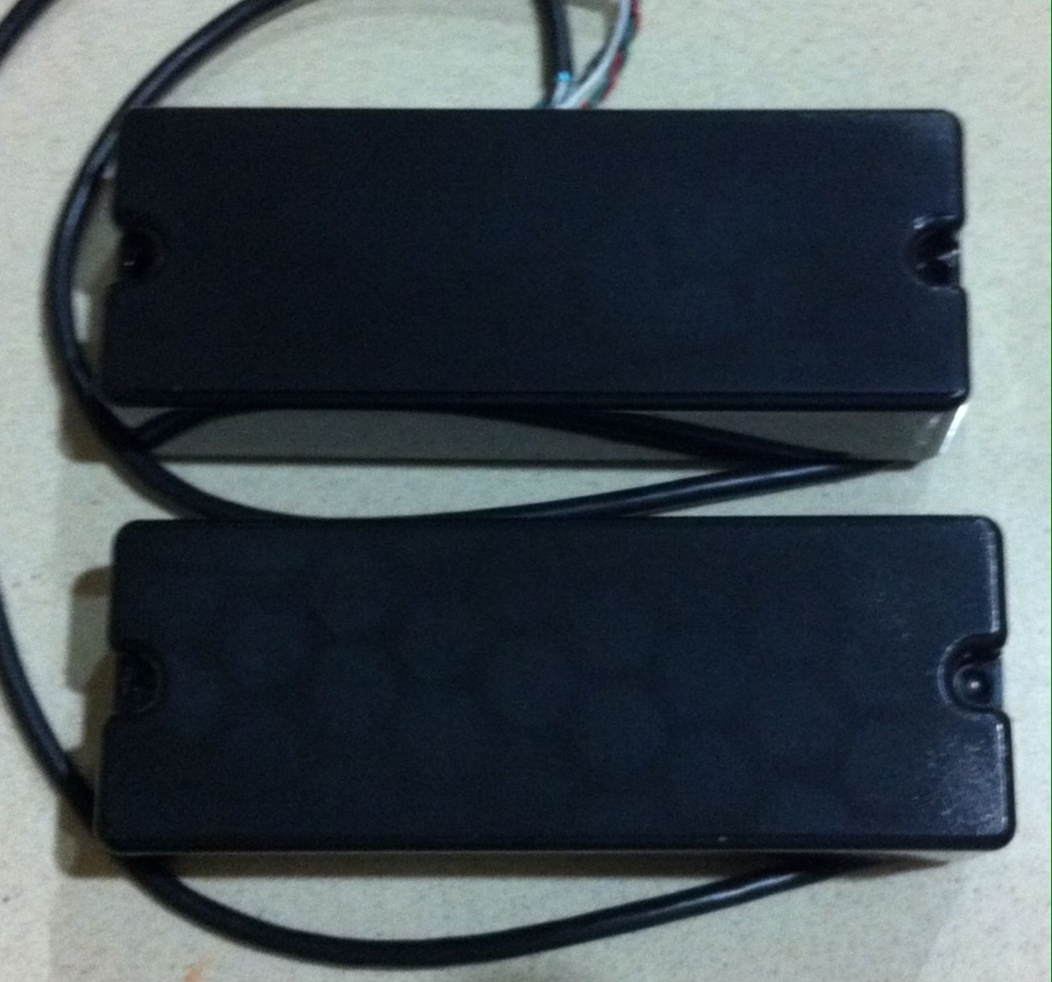

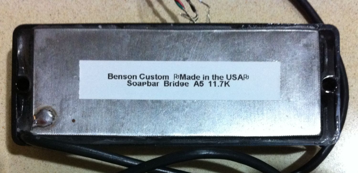

    Special delivery arrived from USA via PBG HQ in Perth today.....
Name:	Benson Custom Box.jpg
ID:	14487Click image for larger version.
Name:	Both PUP's (top).jpg
ID:	14488Click image for larger version.
ID:	14489Click image for larger version.
    Got Thursday off work and hope to get a 'before' sound demo of the stock Chinese PUP's then start the installation and re-wiring process.

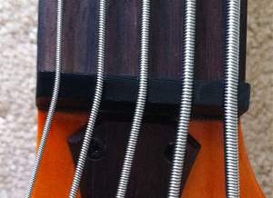

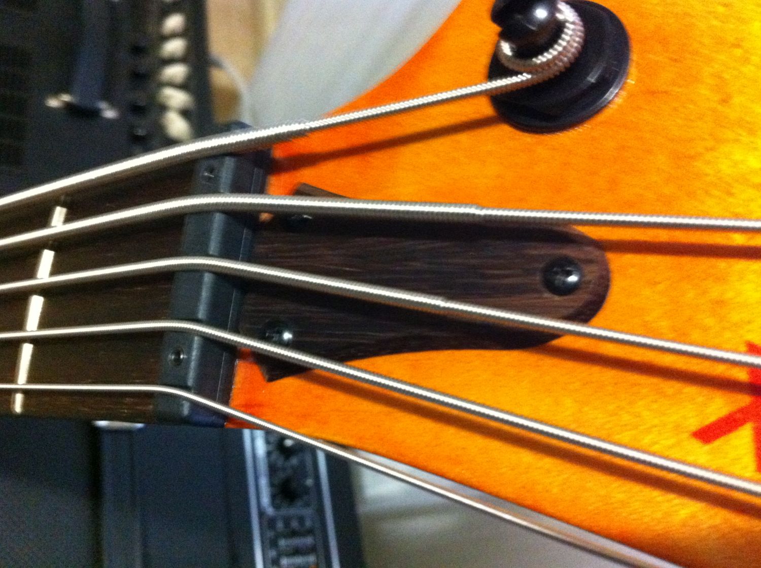

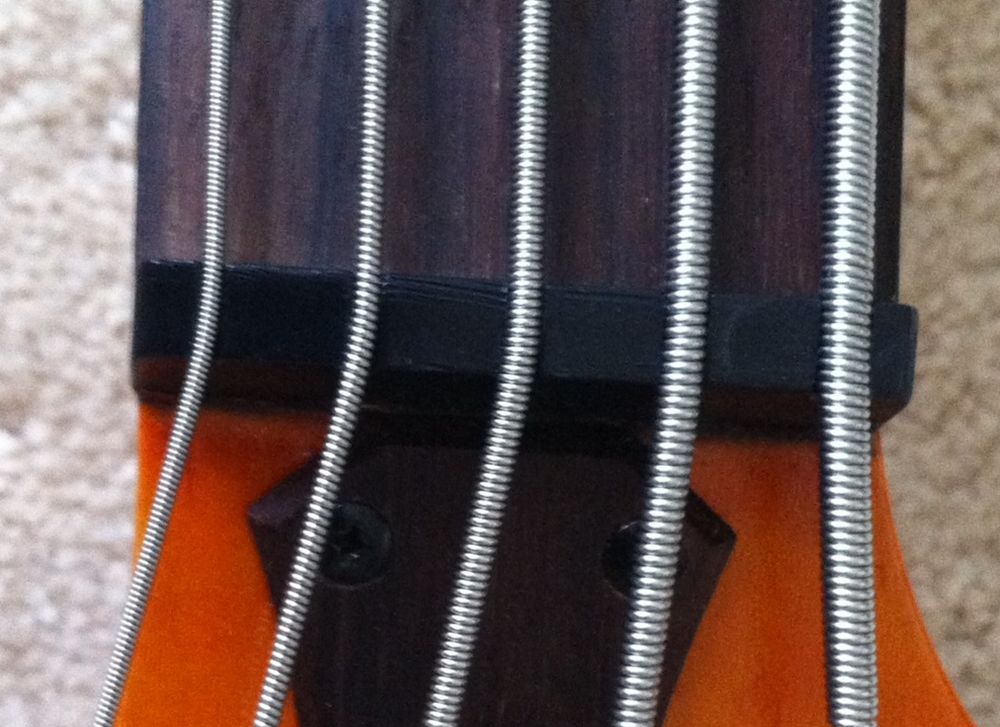

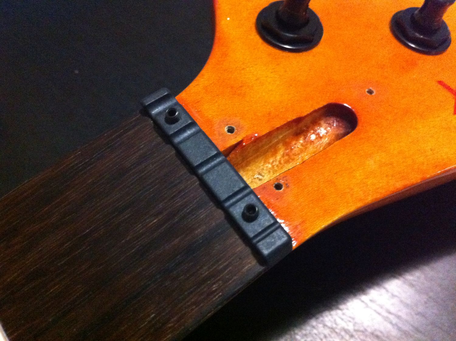

    Didn't get a lot done on Thursday other than playing around with setup and intonation. Installed the 'Just-A-Nut' and that is a great invention as it allows for the finest of adjustment with having to attack it with files and thus cause irreversible damage. Here is a shot of it installed...
Name:	Adjust A Nut.jpg

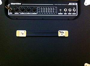

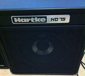

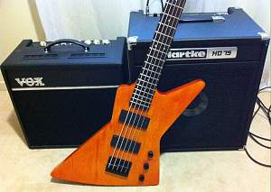

    After work this afternoon got myself all set up to do a demo video with the stock Chinese PUP's before performing the pickup heart transplant surgery tomorrow morning. I am confident this patient won't reject the new organs, err, transplanted PUP's.
Name:	Bass with amps.jpg
ID:	14555Click image for larger version.
Name:	Amp close up.jpg
ID:	14556Click image for larger version.
Name:	Amp settings.jpg
    As you can see from the amp settings Graphic EQ was flat and others at 12 o'clock with just enough volume to be heard and shall leave these in place for the next post operative demo video.
