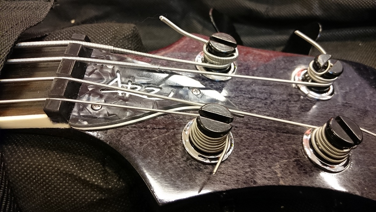

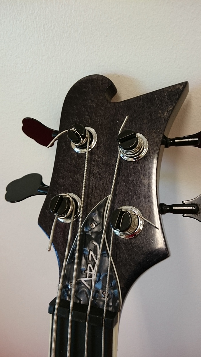

    Truss rod cover and guitar finished...
    Hi
    started at work today after almost 8 weeks of leave. Now had a bit of on call time (hobby time??) in the morning and did the truss rod cover.
    I tried to think of a logo for myself and didnīt come up with anything usable so i decided just to sign my work. Took a bit of time to design (google) my name in different letters and came up with this.
    I had to design the shape so that I could remove and put back the cover with the strings attached. This I could have not done with the "inspired by" shape. cut a piece of paper to fit in place and then dremel the plastic with free hand...
    The signature I drew with a marker on top of the shielding plastic and then after I carved a bit of lines on the surface - took the shielding off. Then it was just layer by layer slowly carving until I got to the white layer. Then a bit of diamond files, surgical knife, dremel bits by hand...
    3 hours later this is what I got. Put it on and now itīs all done.
    Decided to try september GOTM even though Iīm already taking this to band practice and itīs not all show piece anymore. Done and have my mind on the next one already...

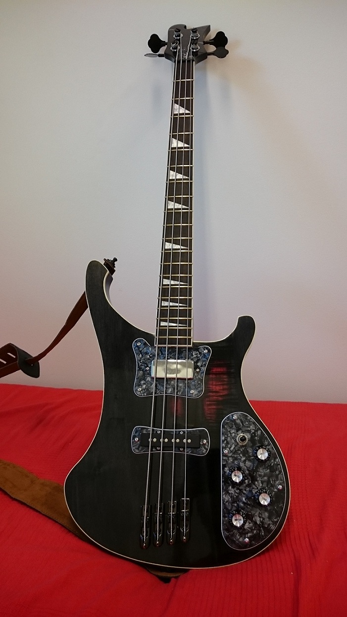

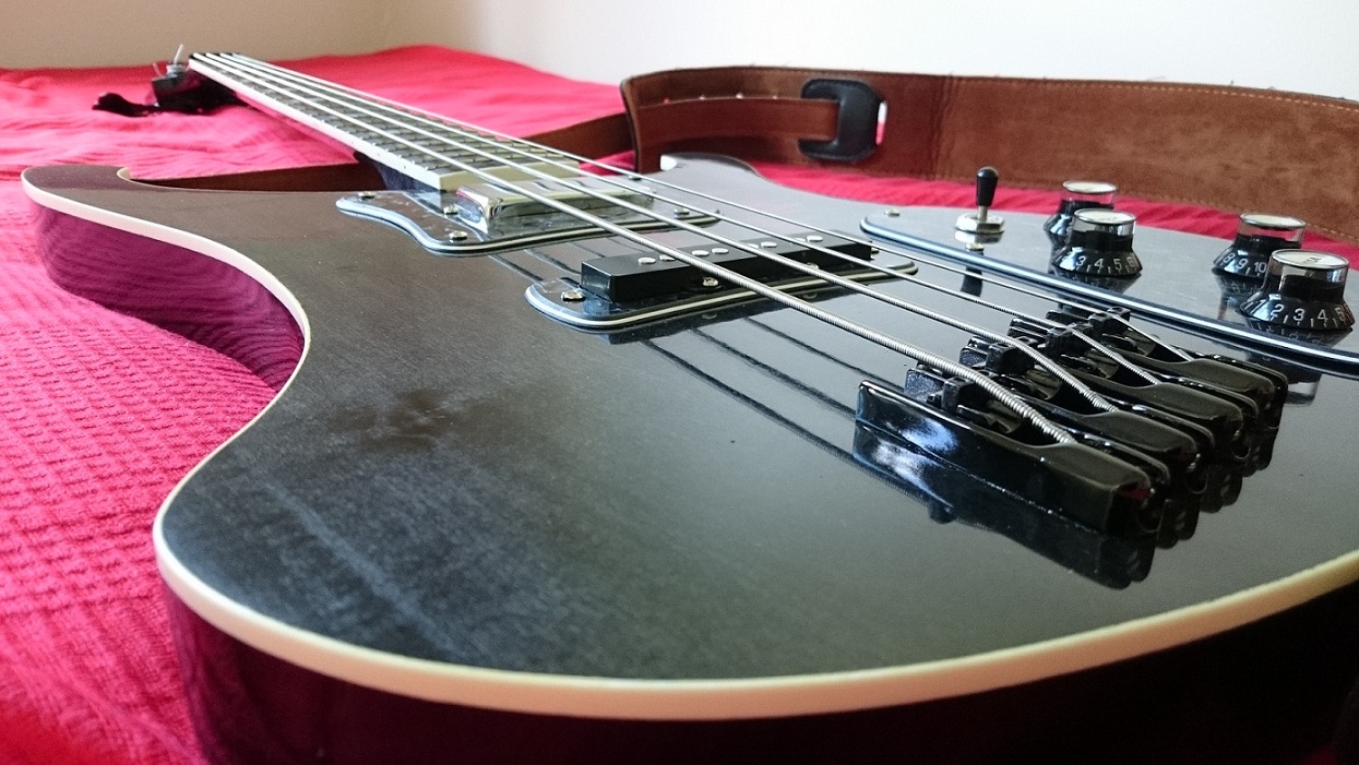

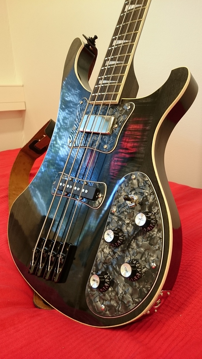

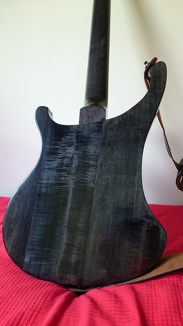

    Some pics of the whole thing
    And the whole thing once more
