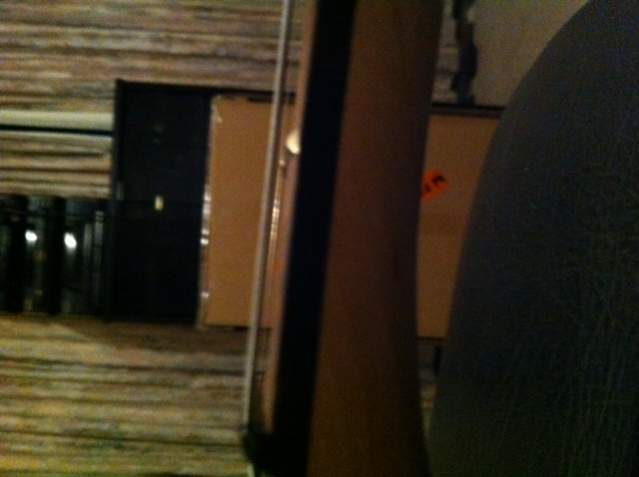

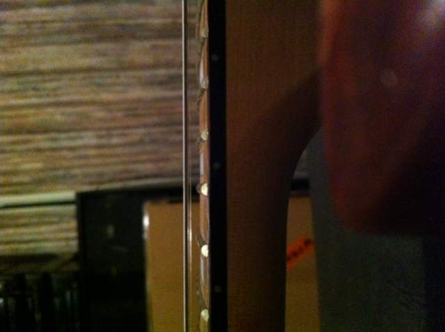

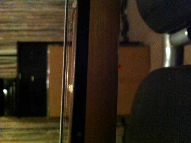

    Hi Guys,
    Sorry guys I'm not sure whats happening here
    I didn't level the frets at all - I didn't think I could fix them if they were out anyway (that's the spirit- ha!)
    I put a straight edge on the neck and it seems pretty straight - I couldn't really fault it?
    I have put some pics up but I know it is hard to tell anything from them
    I compared the action against my other electric guitar and it seems almost exactly the same - it actually looks like the action is lower at the nut end - and it doesn't rattle at all.
    And just to confuse things even more I'm not even sure what frets are causing the noise - it seems to be coming from the 7th to 8th fret now (from the 2nd to 3rd last night??) -mainly only E and A strings
    The strings seem to be "tinnier" than the other guitar - I just used the strings that were in the bag - there is another set in a plastic packet with Pitbull Guitars on them
    Maybe I try changing the strings over? - I'm just guessing now
    I agree with Stan and Fretworn it probably needs someone who knows what they're doing to have a look at it.
    An idea I thought of was if anybody was on Skype - maybe I could contact them and show them what is happening and let them listen to what the noise sounds like???
    I could get the guitar shop guy to have a look but I get the distinct impression he will charge me an arm or a leg for it - he suggested I should have just bought a 'proper' guitar from him.
    Might have to take a trip to Geelong and meet Stan - see how we go (thanks for the offer Stan)
    Any thoughts would be appreciated but I know I'm not giving you guys much to go on
    The guitar sounds sensational otherwise
    Alan
    Sorry guys I cant attach the pics - I will log off and try again

    Here are the pics - I hope you can see them - I think the last one is the first fret and then they run down to the bridge from the first to the fourth pic (I think!)

    Hi Alan. Have you read through Gavin's set up guide?
    http://www.buildyourownguitar.com.au...ead.php?t=1782
    This will help.

    Great news Guys, I worked thru Gavin's set up Guide as pablopepper suggested and the buzzing and/or rattling has disappeared.
    It sounds even better - there is a real resonance in the sound - the chords sound really pure and clear - just incredible.
    I didn't have any space between the string and fret at the ninth fret so I adjusted the trus rod
    That gave me just enough room to get a business card thru and I think this was what eliminated the buzzing noise.
