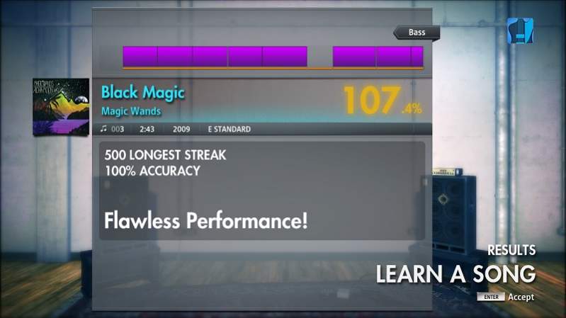

    Cold and rainy here today.....Sat 11 April....so dragged her out early and hooked her up to Rocksmith 2014.
    Still don't get how you can score more than 100% though??

    Great scores on Rocksmith too, btw you can get over 100% by activating 'master mode' (getting a certain number note streak). In 'master mode' it drops notes off the chart and you have to play from memory, therefore getting up to a possible 110%.
