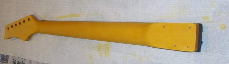

    I was happy with the depth of colour after just the two applications of the Dingotone intensifying coat, so it was time to get some colour on the back of the neck. I would be using a Dingotone clear neck kit but I wanted an old, smokey, vintage style yellow/amber to contrast with the orange so I would be first staining the neck with a SM Colortone mix in metho. I wanted to see how the DT would go over the Colortone, and I used alcohol rather than water to minimise grain raising and reduce the chance of it messing with the edge of the headstock veneer.
    Nice and smokey… the grain makes it look like it has a light and dark half.
    Attachment 255
    Attachment 256
    My neck mount contraption, using the neck mount screws, allowing full access and slots into my rotating painting rig.
    Attachment 257
    Attachment 258
    Attachment 259

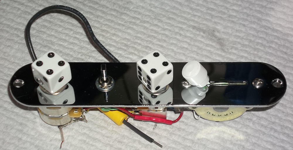

    Do I roll the dice?
Name:	TL_1TB - roll_dice.jpg
  10. #120
    haha nice control knobs Weirdy and matching white switch tip. What does the mini toggle switch do ?
