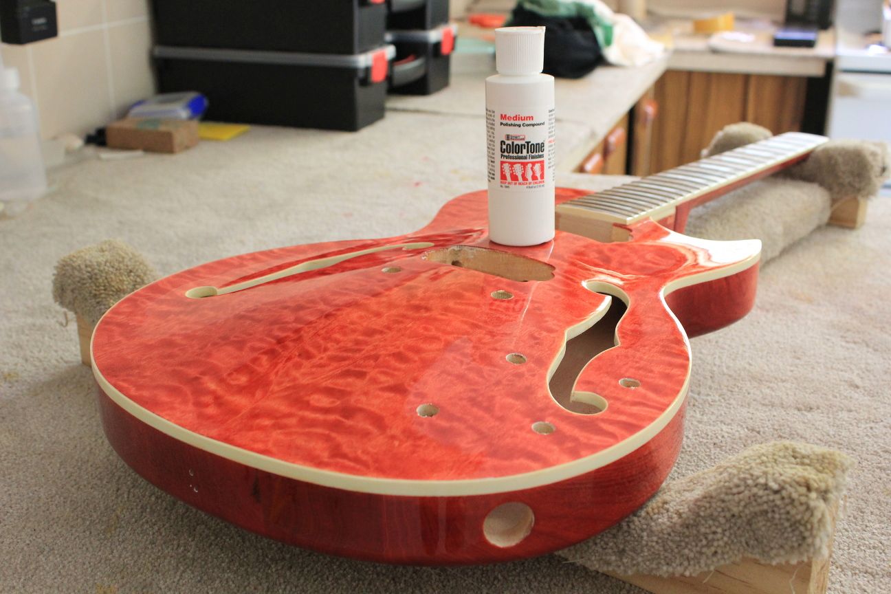

Well, my tru-oil has cured for a week and now it's time to start polishing with Colortone compound from Stewmac. Got it rubbed down with 'medium' grade today (my aching shoulders!) and have 'fine' and 'swirl remover' grades to go. I'm already happy with the level of shine.
Just a few more days to go and the finish will be done. Then I can concentrate on the wiring!
That's a nice deep reflection you've got happening there. Can you use Colourtone on Wudtone?
@Lawry - Thanks dude. Yeah I've used it on Wudtone and it shined it up quite nicely. It's like any other cutting compound - you just need a thick enough clear layer to begin with.
Cool. I may give it a try sometime. It sure has made the florentine shine!
