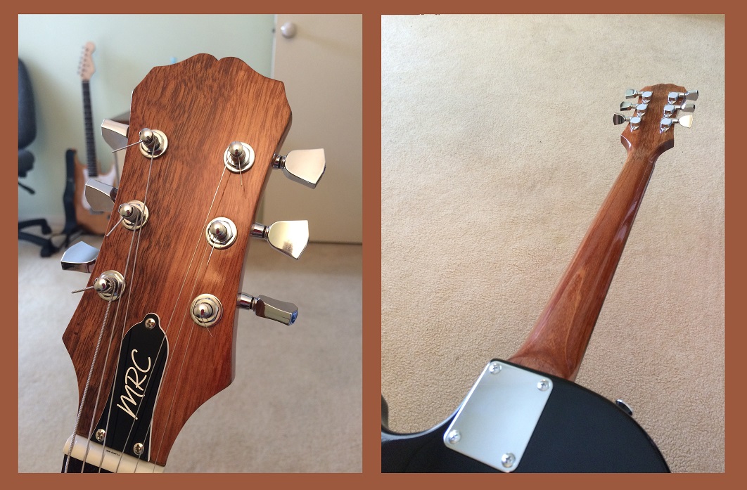

    This is a mahogany neck I grain filled using the slurry method:
Name:	Mahog TOil 2.jpg
    It is a Tru Oil finish.
