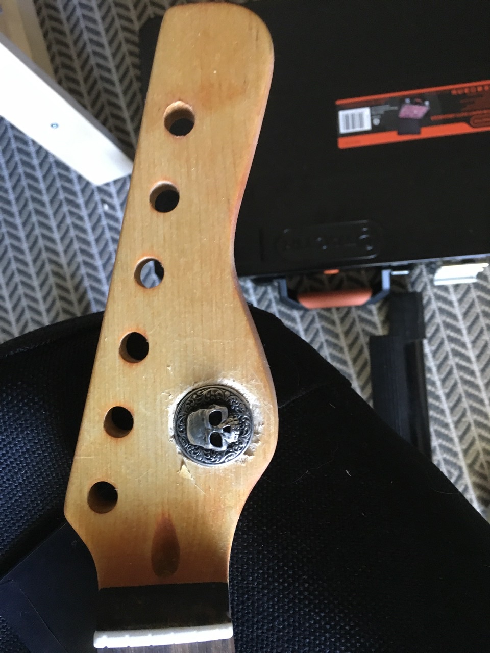

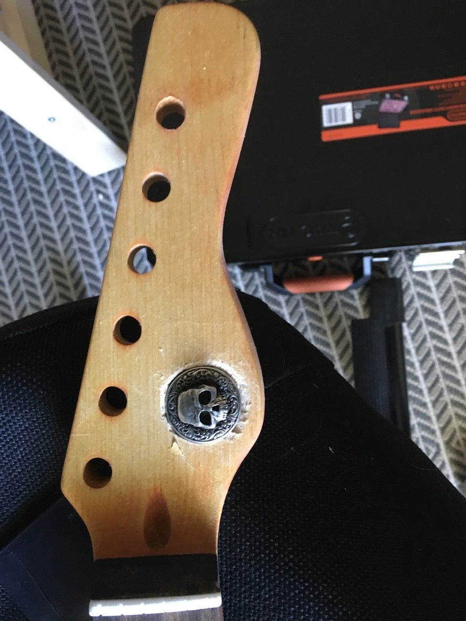

    While I haven’t put anything up for a while, I have been doing things. I had been waiting for some things to come in..namely, my topcoat and some retarder and the spray gun kit I ordered. The spray kit is apparently in Australia but tracking doesn’t seem to be working properly, so I’m hoping it will turn up next week.
    In the meantime, I have worked on the neck, fitting my bling, which is epoxied at the front and screwed in from the back. It won’t be going anywhere. I’ve also installed the tuners. I haven’t set the heights properly yet (they are variable height) to get my break angle over the neck properly done.
    The neck is looking like this.

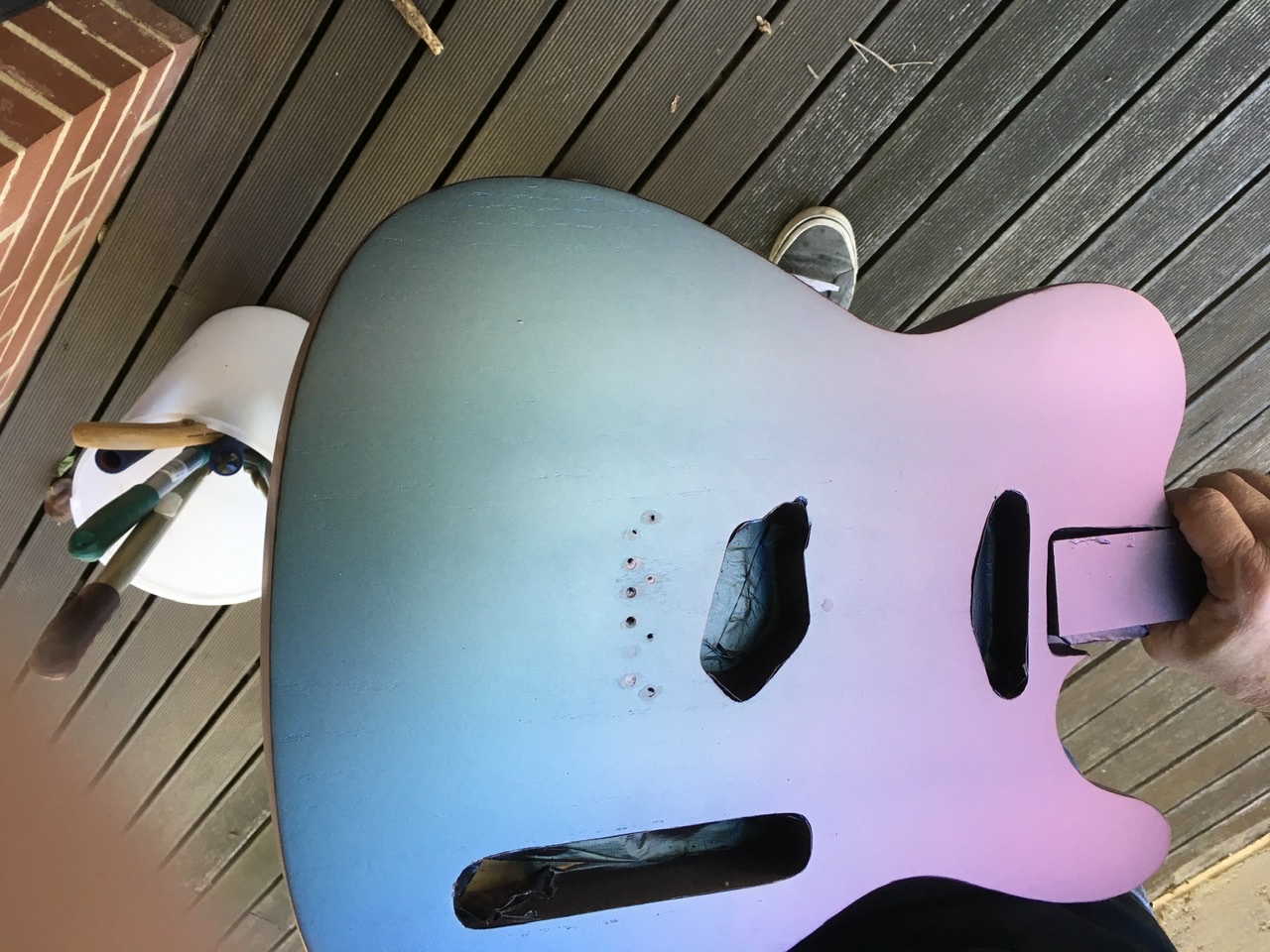

    In the meantime, I had another can of the colourshift paint, so I decided to give it another coat to do a richer finish.
    It now looks like this.

    Oh man, just when things were going well .... that's usualy the way. Until you have that clear on and cured you have to be so so careful, because base coat is fragile. Once the clear is on the colour shift effect and pearl/metallic will realy pop. Pics of bare base never do the finished effect justice. It's gunna look killer when it's done!
    Look on the bright side, when House of Kolor first introduced colour shift paint (they called it kamelion kolor), it was a grand a litre!
  7. Liked by: Eponymous

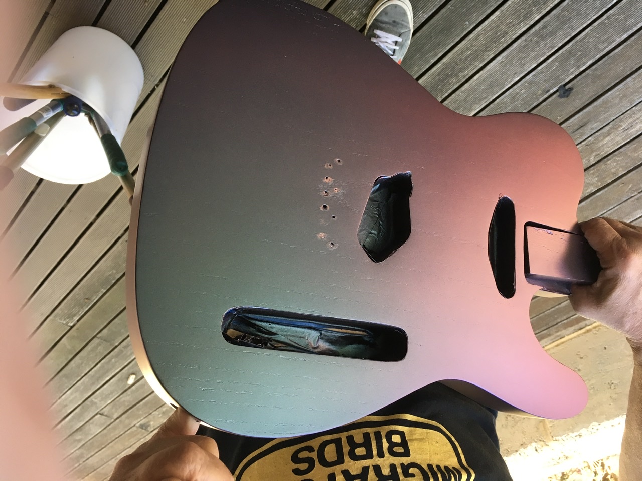

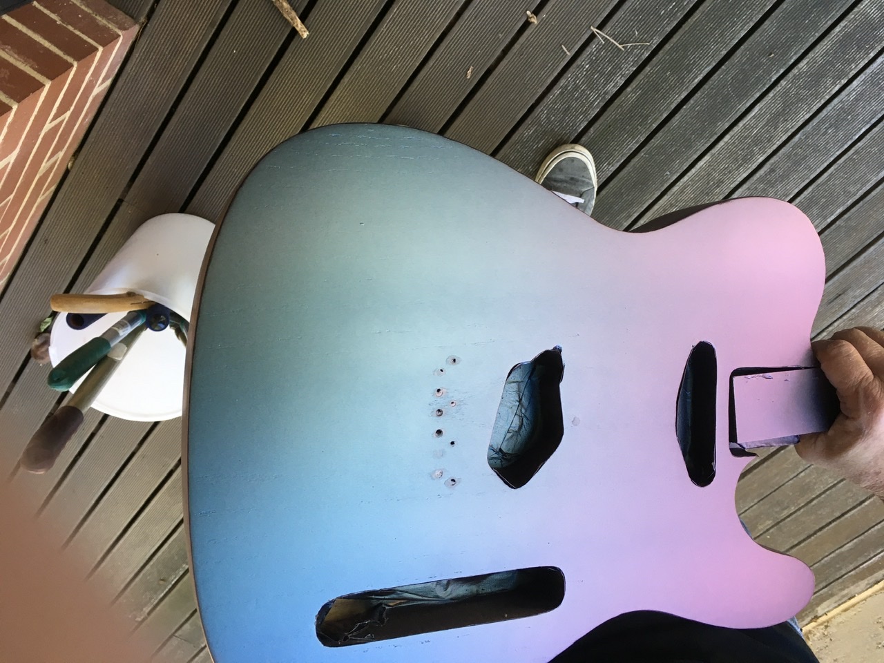

    Just walking into the workroom and seeing the light fall on the guitar like this
    Attachment 40070
    Maybe this will work out.the colourshift is certainly working.

  12. #8
    Quote Originally Posted by Eponymous View Post
    Yeh, you can see the pink in the light and brown in the shade. Trust me, the effect will be more dramatic when you get the clear on. You will have more depth, of it's a pearl shift the pearl effect will be more visible, if it's a flake colour shift, the flake will pop more, and assuming it's a gloss clear you are using there is also the way the light plays off the shine. To give you an idea, check out some of the Createx YouTube vids. they often show you examples of different basses before and after clear.
  13. Liked by: Eponymous

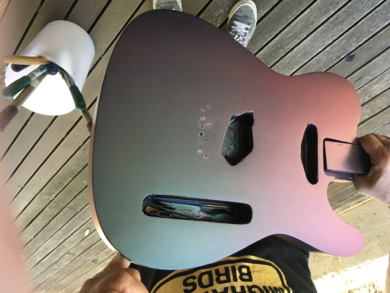

    After a week down south, I’m back to start the repair job..well...finish, maybe.
    After the drop incident, I sanded back the affected areas, put some wood filler in to bring it level, then sanded back and painted the black base coat.
    It looks like this.
    Attachment 40283
    I have a new topcoat can and hopefully, it will all blend in...maybe.
    Should have that finished this afternoon.

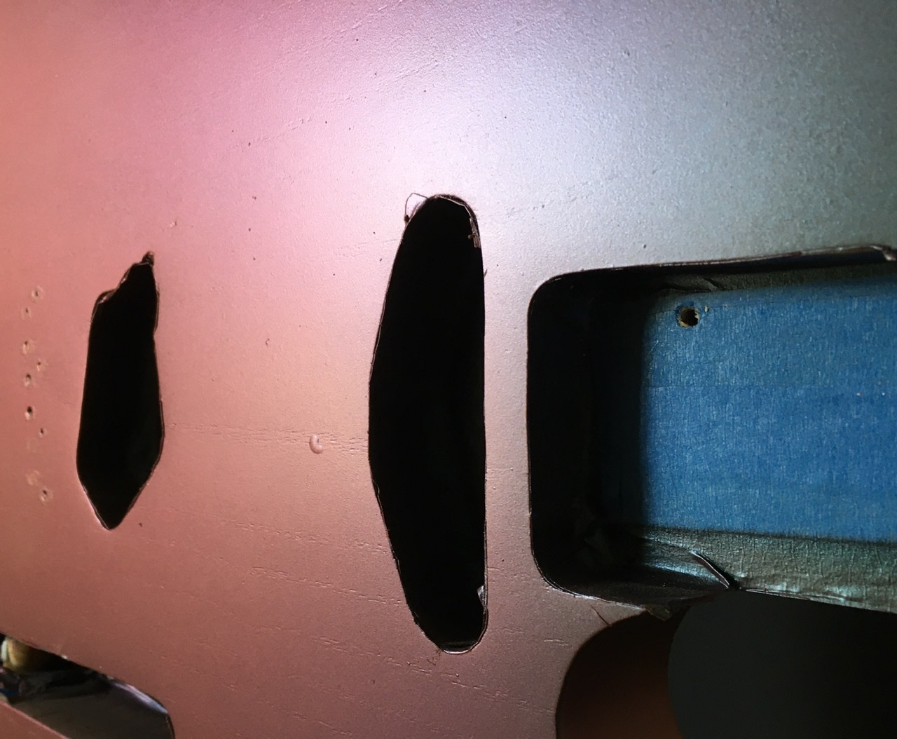

    Don’t let the perfect be the enemy of the good

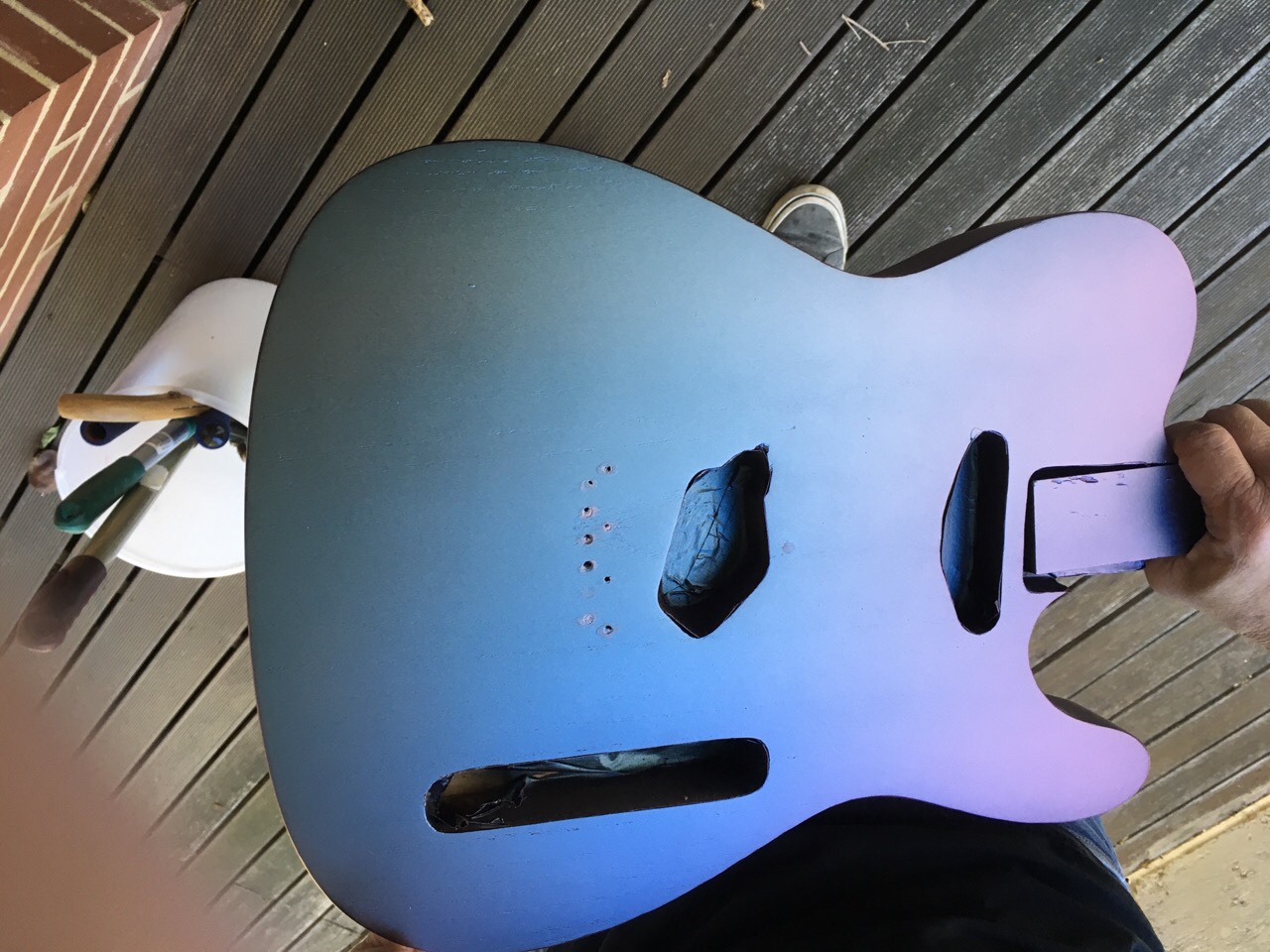

    So, painting is now done. You can still see the back repair but the front seems to be relatively ok.
    The back was a smaller repair area but it still shows up. Mostly, it will be covered by the backplate for the neck screws (and it is also the back, so meh), so I am going to leave it as it is.
    Will be using spray polyurethane on Wednesday. Aiming for about 6 coats..that is going to take me into the weekend.
    But, it looks ok, to my eye.
