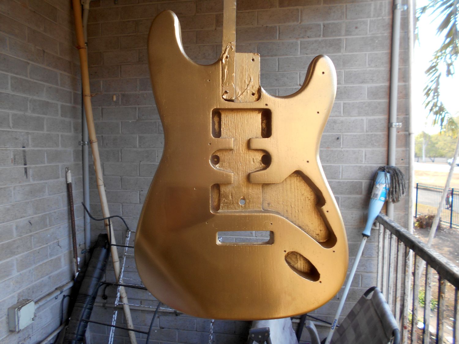

    Here's some more pics of the Gold Strat body as it is now:
    Firstly the front of the body, hopefully you can see where I had to do a re-touch spray:

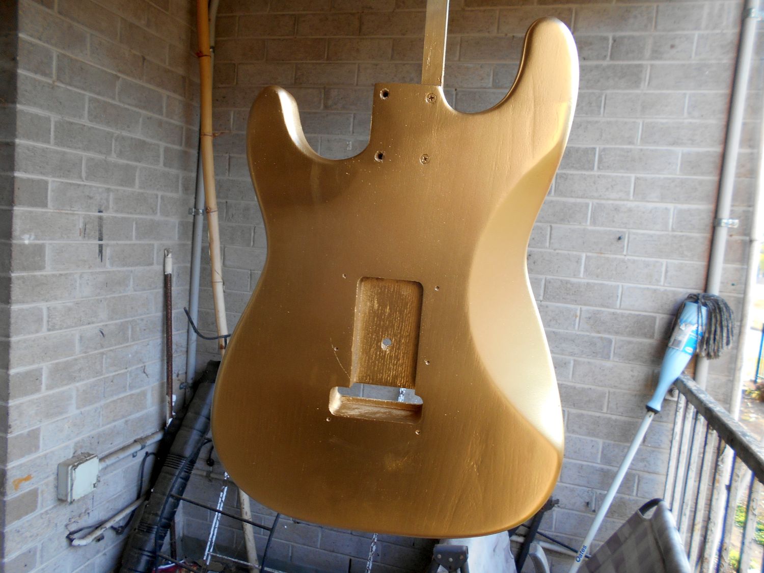

    Next the back of the body:

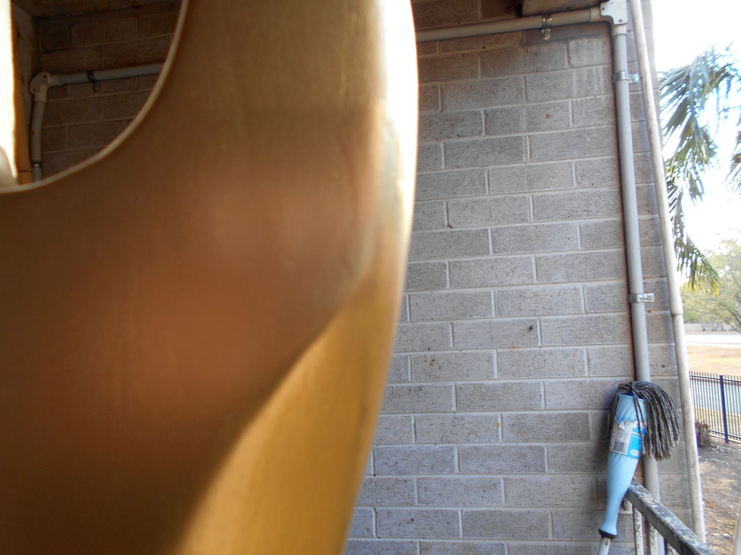

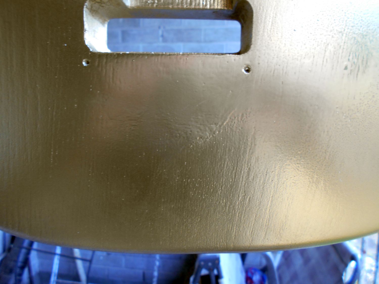

    Next the two areas I had to fix:
    Here's a close-up of the area where I had to scrape it back to the grey primer, using a sharp Stanley-knife blade, I gave it a touch-up spray afterwards:

    This was where the Gold paint had discoloured because the primer had not completely dried, I think I did a pretty good job of fixing it and it doesn't look too unsightly.
    And here's the other area I had to fix, this was where I had a paint-run that needed to be sanded smooth with some 800 Grit Sandpaper, the paint-run happened when I tried to touch-up an area I missed just inside the bridge-route, and I accidentally sprayed too much paint, fortunately I fixed it and it looks okay now but it looked pretty unsightly before with the paint discolouring a bit:

    So, before I go and do anything else, I'm going to let the paint have a decent amount of time to dry, I think it's about ready to be clear-coated, remember that the clear-coat I'm using will dull the shininess of the paint a bit so that those areas where I did touch-up sprays won't be so noticeable.
