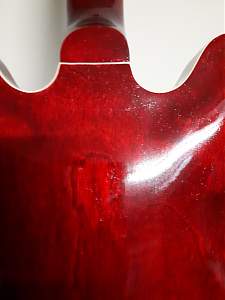

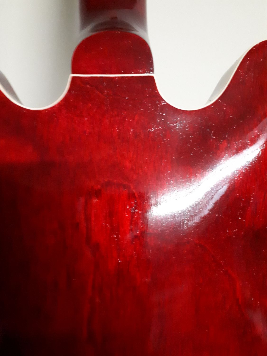

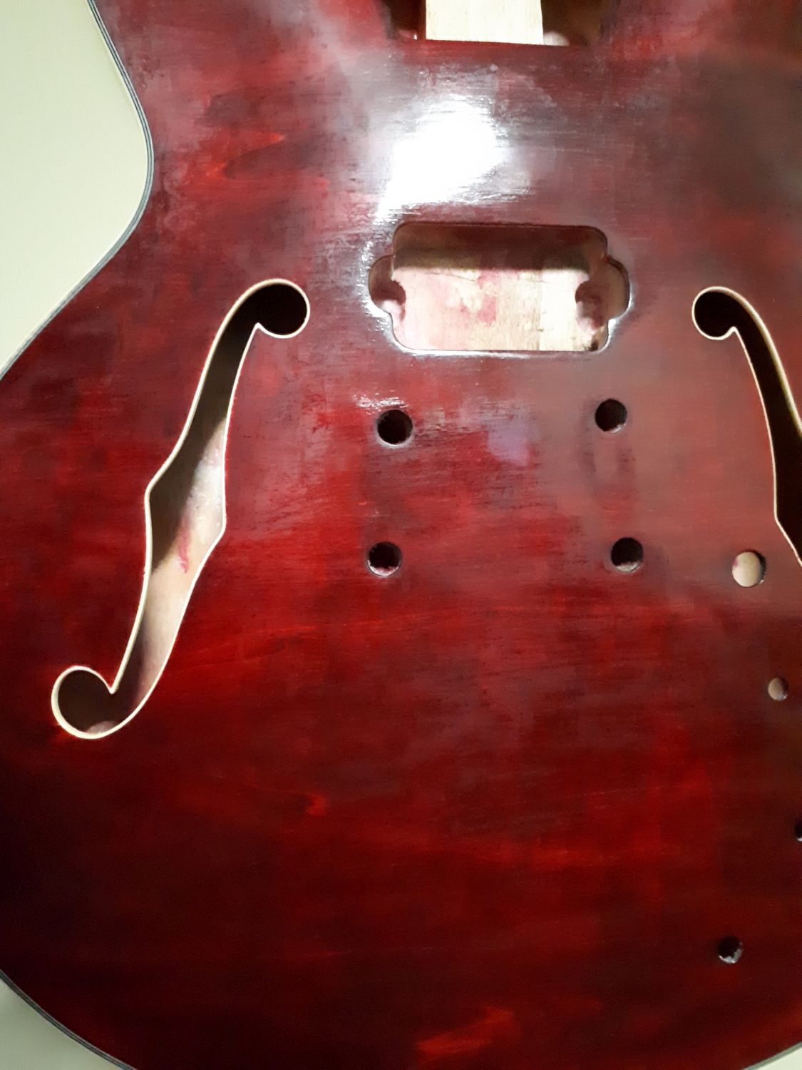

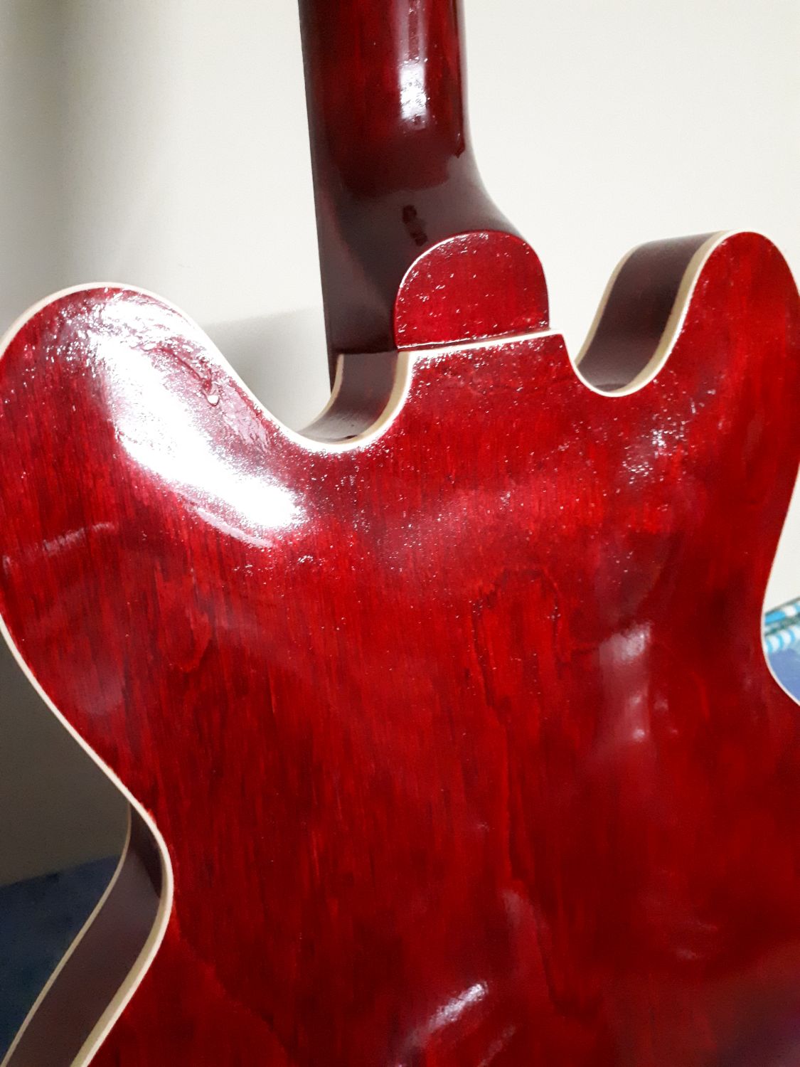

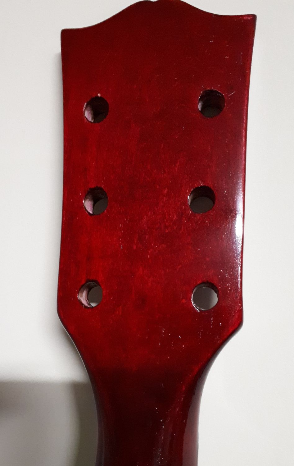

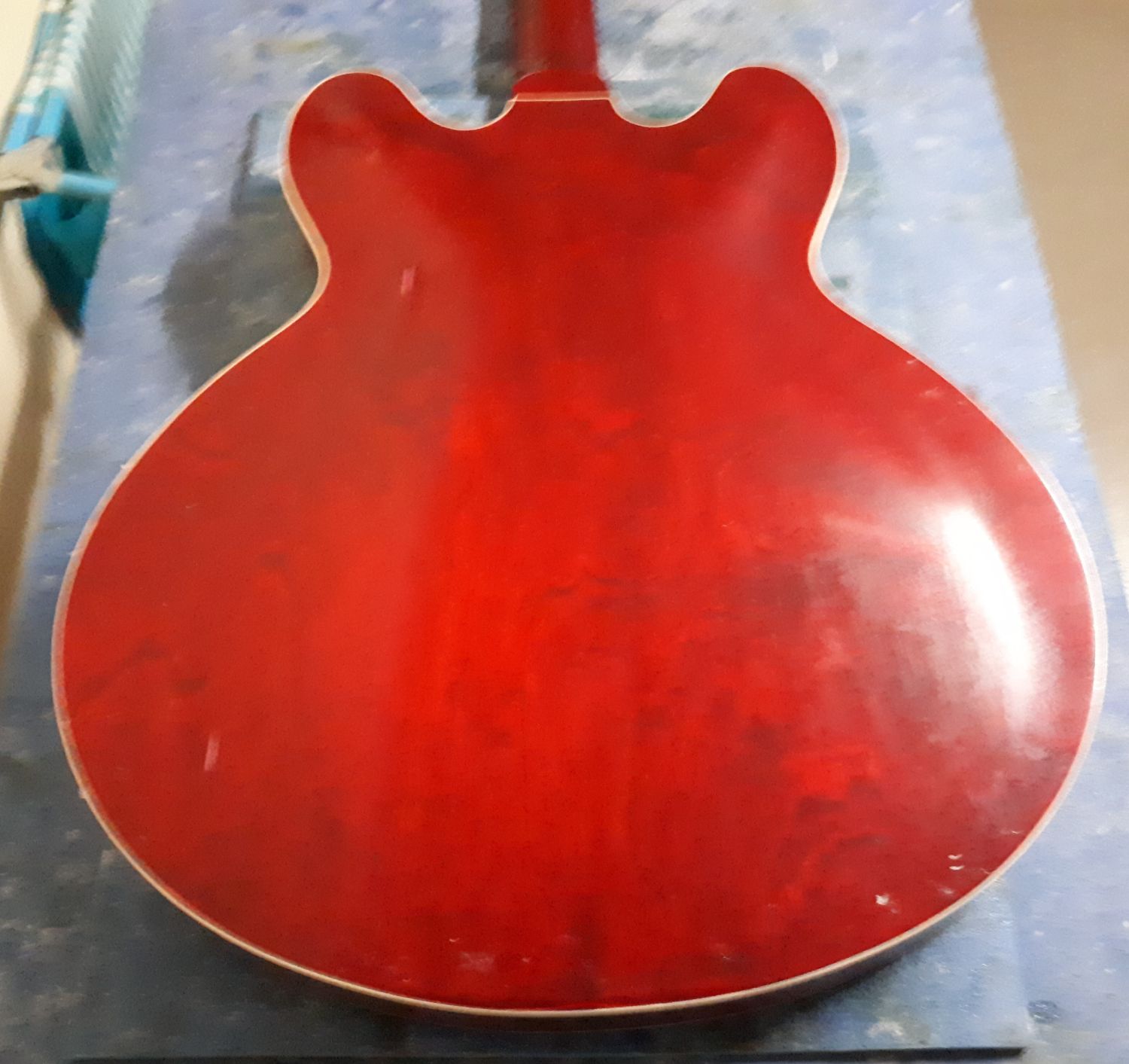

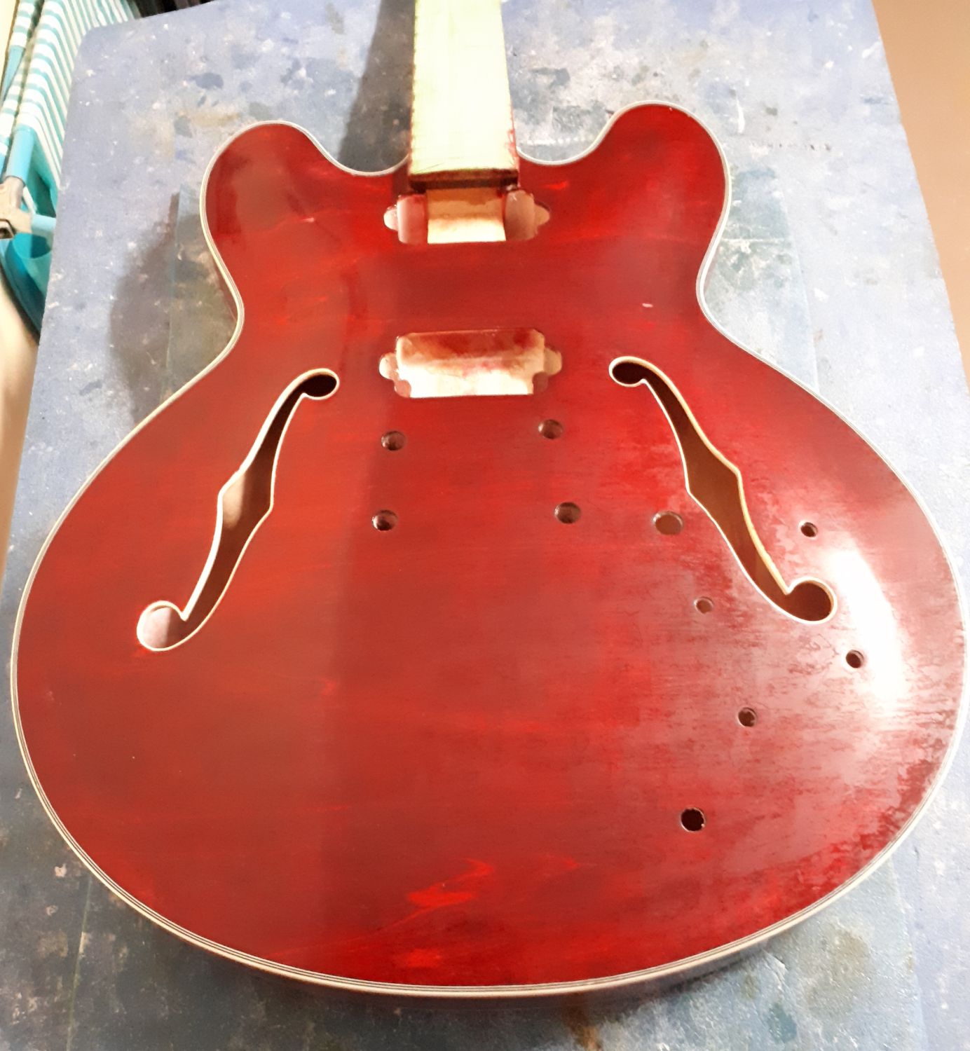

    Already lost count on how many coats of TO and reckon it could be around 15 but not 20 yet. It has had 1 x 1200 wet sand about 7 or 8 coats ago, followed by 2 x 1500 wet sandings after a further 4 coats between sanding. Below shots show some of the blemishes that need to be knocked down every few coats to make sure end result turns out good....in these we have dust particles, probably fibre particles from the small rag used to apply finish, plus the dreaded runs, all of which disappear with a solid sanding session.

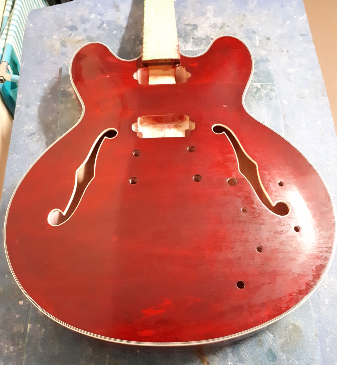

    Next shot is just after spending 90 mins doing a thorough 2000 grit wet & dry sand all over. Yes, the wet sanding does dull the surface a little bit and when doing this tonight it felt like I could have kept going with micro mesh pads all the way up to 12000 grit which would have polished things back to to a glossy shine.
Name:	body front after 2000 wet sand.jpg
    Still needs a few more coats though as the final polishing process strips quite a lot off. From here I may need to do 2000 wet sands after every 2nd or 3rd coat just to give it some tooth otherwise subsequent coats don't want to take hold as well which leads to runs and blemishes. An easy trap to fall into.

    All good DarkMark.....the trick is in how it feels whilst still quite wet. Weird how the smoother it gets small bits like fine grains of sand appear but having done this many times that is quite normal. Just need to stop and rinse/wipe things down once you hear and feel the scratching happening.

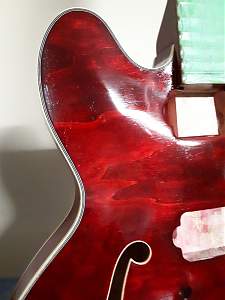

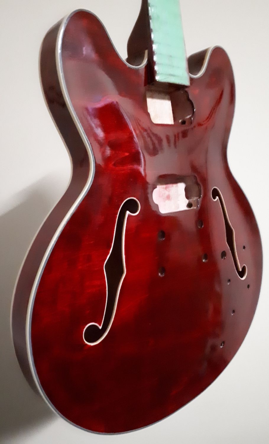

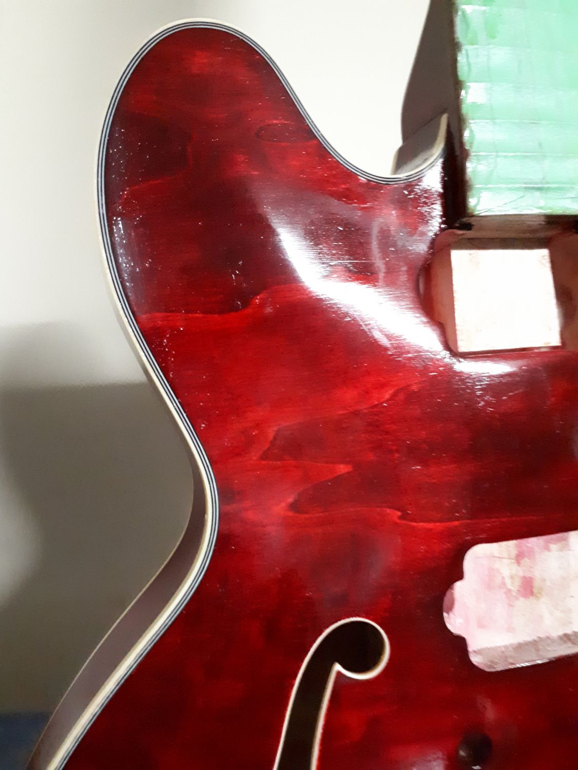

    Last night wet sanded from 2000 grit then switched to micro mesh pads 4000, 6000, 8000 & 12000.....

    Smooth as glass but unfortunately went through in a couple of spots that required touching up with a bit more colour. Put another coat on today but discovered a few runs missed in the wet sanding and will have to wait for this coat to harden up a bit before sanding back those runs. All good as I can now just gradually build up a few more coats to sacrifice for the final polishing.

    2nd coat just applied after the ultra heavy wet sanding which makes a huge difference in helping to bring on the glassy shine.

    Colour still hard to capture as this was taken in a darker corner of the garage where all the guitars get hung up to dry.
