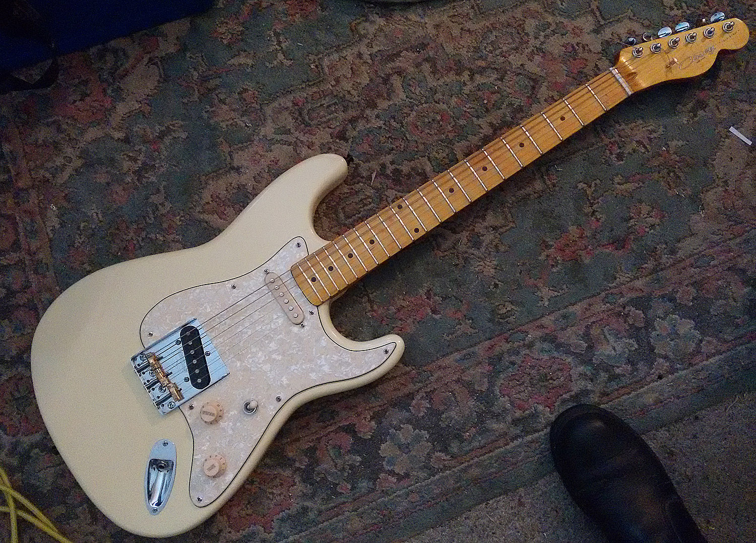

  7. #107
    Well time has certainly passed and I have done some slight modification.
    Wasn't happy with the bridge location. I was within intonation, but set too far forwards which meant a severe angle for the low E string.
    Decided to relocate the bridge 5mm further back.
    Upgraded the potentiometers and installed an orange drop capacitor that was laying around.
    Relocated the volume and tone, and installed the 'Gibson' style pickup selector.
    edit: Oh, and made a different scratch-plate.
    cheers, Mark.

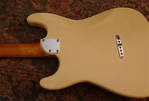

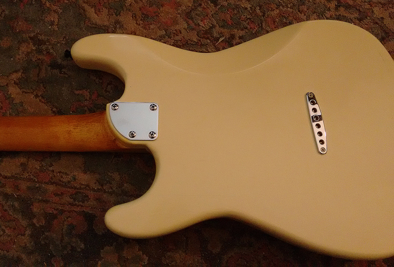

  8. #108
    Oh yeah. Furthermore, I added an 'asymetric' neck plate, and 'Grant neverwas' transitional neck mod.
    cheers, Mark.
