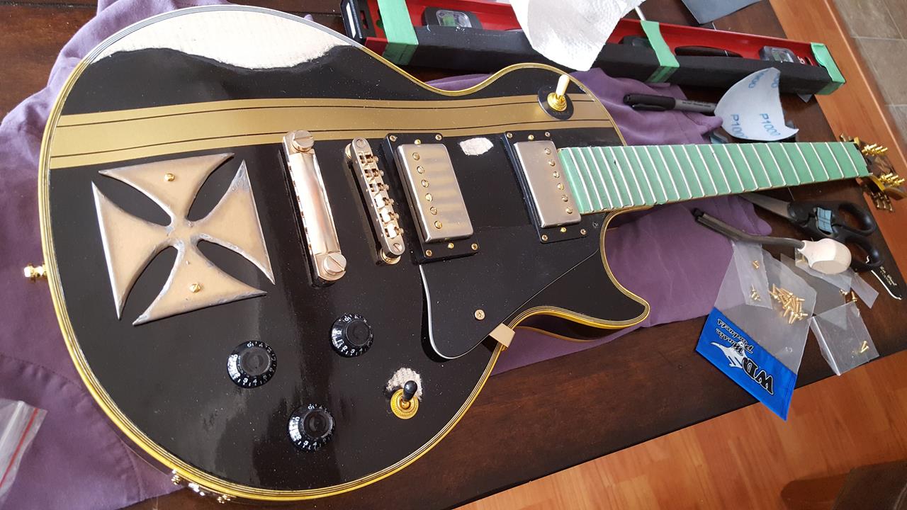

    This monster lives...
    After too long a hiatus from guitar projects I've finally managed to scrounge a bit of time, replacement fasteners, and favorable weather to reach the finish line on this one. It's been a long time coming but the end is in fact near.
    The iron cross turned out pretty well. After cutting out the shape and carving the edges from a pickguard blank, I submerged it in very hot water for about 15 seconds and then pressed it against the guitar body to match the contours of the carved top. Then I layered on the spray paint as follows: hammered steel, satin clear, brilliant gold (sanded around the edges for a worn look), then more satin clear.
    The frets are now leveled and polished. I just want to roll the edge of the fretboard binding then I think I'm good to go.

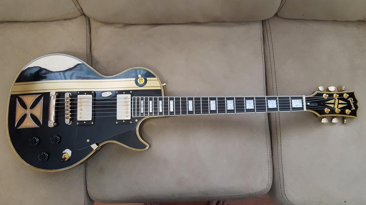

    Thanks guys! It's finally alive. Last night I filed the nut slots and threw some strings on to start the set up. But when I plugged it in to tune it up my heart skipped a beat when no sound came out. Suddenly I worried that my butchering of the EMGs went too far. I pulled off the cavity cover on the back and was relieved to realize that I hadn't put in the 9V battery yet so in it went and viola, it worked!
    I adjusted the neck relief and got the bridge height roughly in place, but stopped half way through the set up because I was having too much fun just playing it. The rest will wait but hopefully next week I can do the rest and put up a sound demo. Here's how it's looking now, just need to put the truss rod cover back on.
