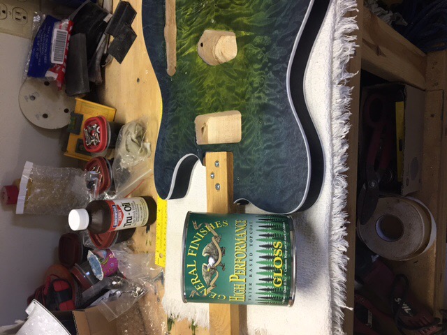

    Thanks guys for the kind words.. the knobs I found on Guitar Fetish. I also got the pickups there.. very reasonable prices.
    The poly is a high performance polyurethane from General Finishes..

    Wow, ton of depth in that finish. Looks absolutely stunning.
  3. #103
    Thanks Waz....
  4. #104
    Love the finish man. Wish I could get a shine like that from poly! Great job.
  5. #105
    Thanks Gav.. that was my first time using poly and I sprayed it light coats with about an hour and half between coats with light sanding between. I did 6 coats then let sit for 2 days and level sanded and then started over with a little heavier coats with sanding between. Then I level sanded and wet sanded going up to 2000. I used Naptha instead of water. Then I used 3000 grit on a drill attachment and that really gave a pretty good finish. I waited almost a week and used 3m finesse it to cut the finish further followed by zymol wax and buffed with buffing pad on the same drill attachment. I think I am going to build a buffer. I had to replace my heat pump so I kept the blower motor. I think I can use it to build a double head buffing station. I know you probably know all this stuff looking at your builds but just thought I would share for some newbies like me.

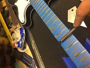

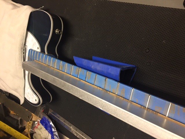

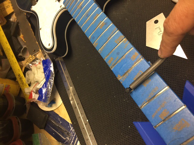

    Well still waiting on my decal so I went ahead and started the fret job. Leveled with a beam with sand paper 180 grit on one side and 400 on the other. Then re crowned, sanded with 600, 800 and 1500. After I get the last few coats of TO on neck I will end dress and then use the dremel with a polishing wheel and really polish the frets and then the set up.
