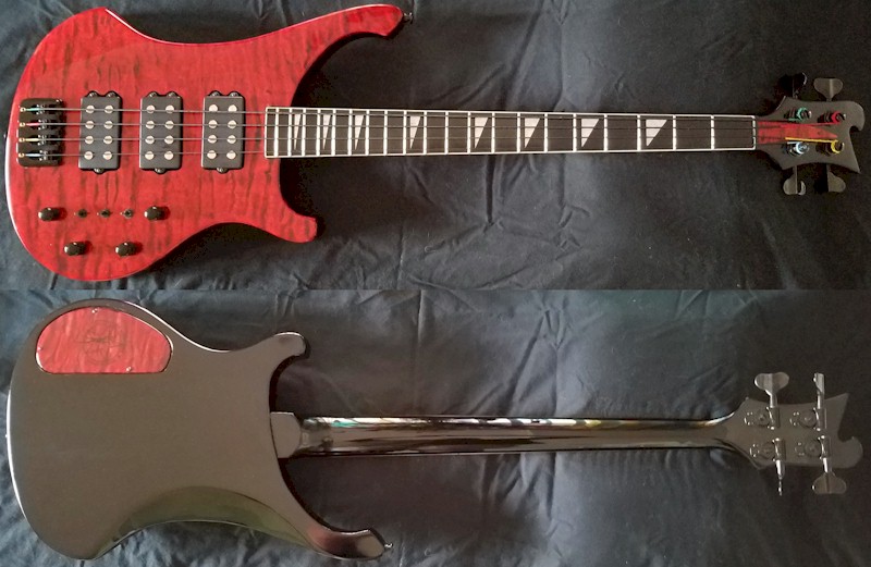

    The Gedenbacker Model 2112 (Made in SPACE)...it is accomplished...
    Okay...so this project started about a year and a half ago. It started out pretty quick out of the gate, and then slowed a bit as I tripped over my own feet and child-like enthusiasm here and there, but overall I was pleased and excited. All the mods, the maple cap, the finishing, etc. But then...
    But then I had to figure out (1) the wiring, and (2) all the fine-detail stuff like the setup so it didn't play like a chunk of butcher block (which it did when I first tried to play it).
    I honestly took a year to just ponder just the wiring. Hell, I've never wired a bass. I know how to solder, but come up with a wiring design? ...whatever. The bass just sat in it's case while I dealt with my feelings of intimidation and inadequacy. Every once in a while I would look at it...and look at it some more. Eventually people stopped asking about "the bass project" and my wife even stopped throwing me dirty looks every time she walked by the unfinished project in my office.
    Finally, I decided to just go for it, and this past week I finished the beast.

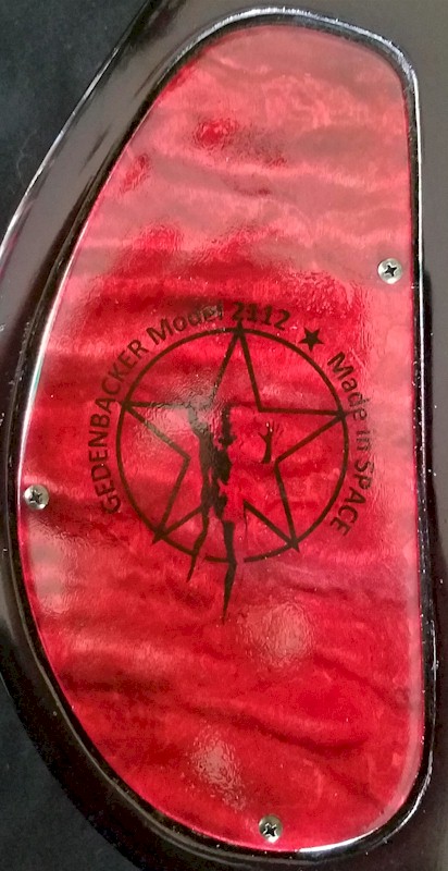

    Wiring-wise, I combed a wiring diagram from a jazz bass (it was simple enough that even I could figure out how to add the third pickup) with some info I found on using a on-off-on SPDT switch for coil tapping. The goal was to get 3 volumes (one for each pickup) going to a single tone, with a switch for each to make it possible coil-tap each GFS MM-style bass pickup. Of course, I had to deal with some issues I'd made for myself.
    First, the cap I'd put on the guitar was about 1/4 inch thick. Way too thick for the cts pots and switches I bought from StewMac. Buy new pots and switches, or make the wood thinner? I decided to make the wood thinner. I was using a little Bosch Colt router, and given the size of the cavity, this meant a lot of that routing was more "free hand" than I would have liked. I was shooting for 1/8", but I ended up with 1/16". Yikes. I could have probably broken it with a finger if I really tried. So, I spent about a month trying to figure out what I should do to make the wood over the cavity stronger. Solution: Bondo fiberglassing kit. I ended up doing about three layers of fiberglass and resin in the compartment, which worked great. Super strong now. Re-drilled the holes and everything looked great...except now one of the pots and one switch no longer fit because it changed the clearances a bit. Bust out the Dremel, start grinding. Eventually everything fit as planned. Painted the inside with conductive shielding paint, installed the pots and switches, and wired it all together.

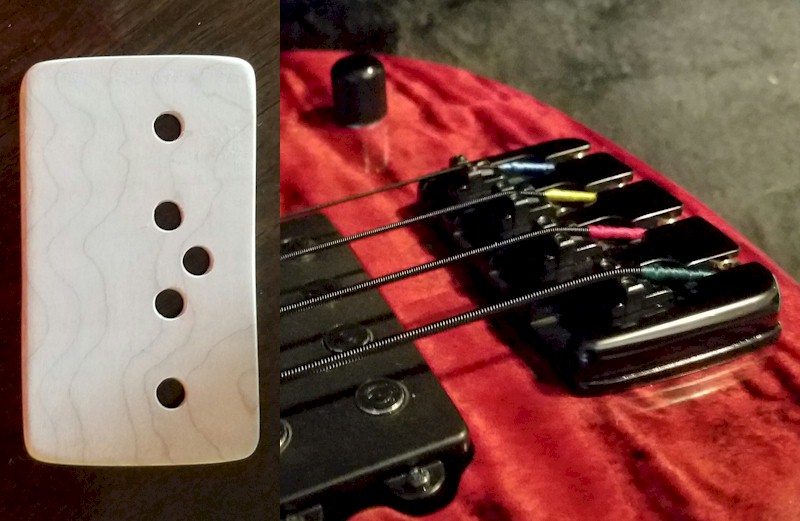

    Next, I had been putting off dealing with a problem with the bridge that I knew I had. When this all started, I really thought hard about getting one of those black Hipshot Rickenbacker bridges, but I just couldn't swallow the price tag. In the meantime, I found a bridge that I liked pretty well on the All Parts site for $35.00. Solid...modern-ish...nice-looking...but one problem. Mounted, it was about 1/8" too...short. As solid as it is, the profile is just a lot lower and it couldn't be adjusted high enough to provide the correct clearance over the fret board without things getting really wonky. Solution: I had a piece of the maple cap I'd planed down to 1/8" for the control cavity cover and truss rod covers I made left over, so I made a spacer that I cut to size, sanded, and finished with the same black finish I used for the guitar. Slipped it under there, screwed everything down, and honestly, it looks like it's part of the bridge...and the height is perfect now...
