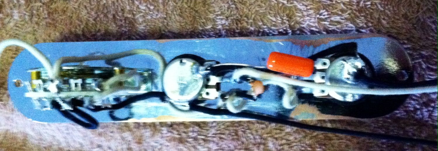

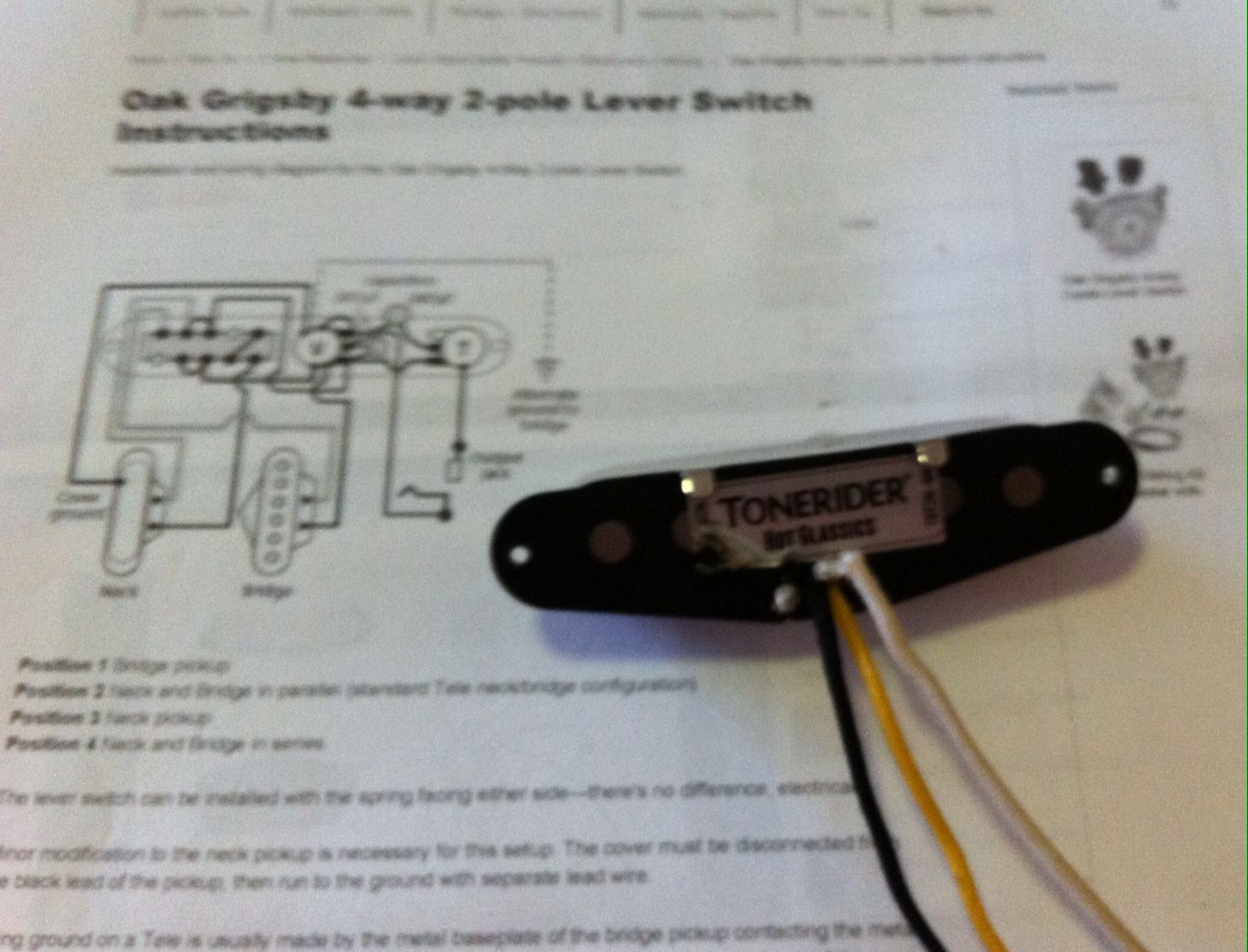

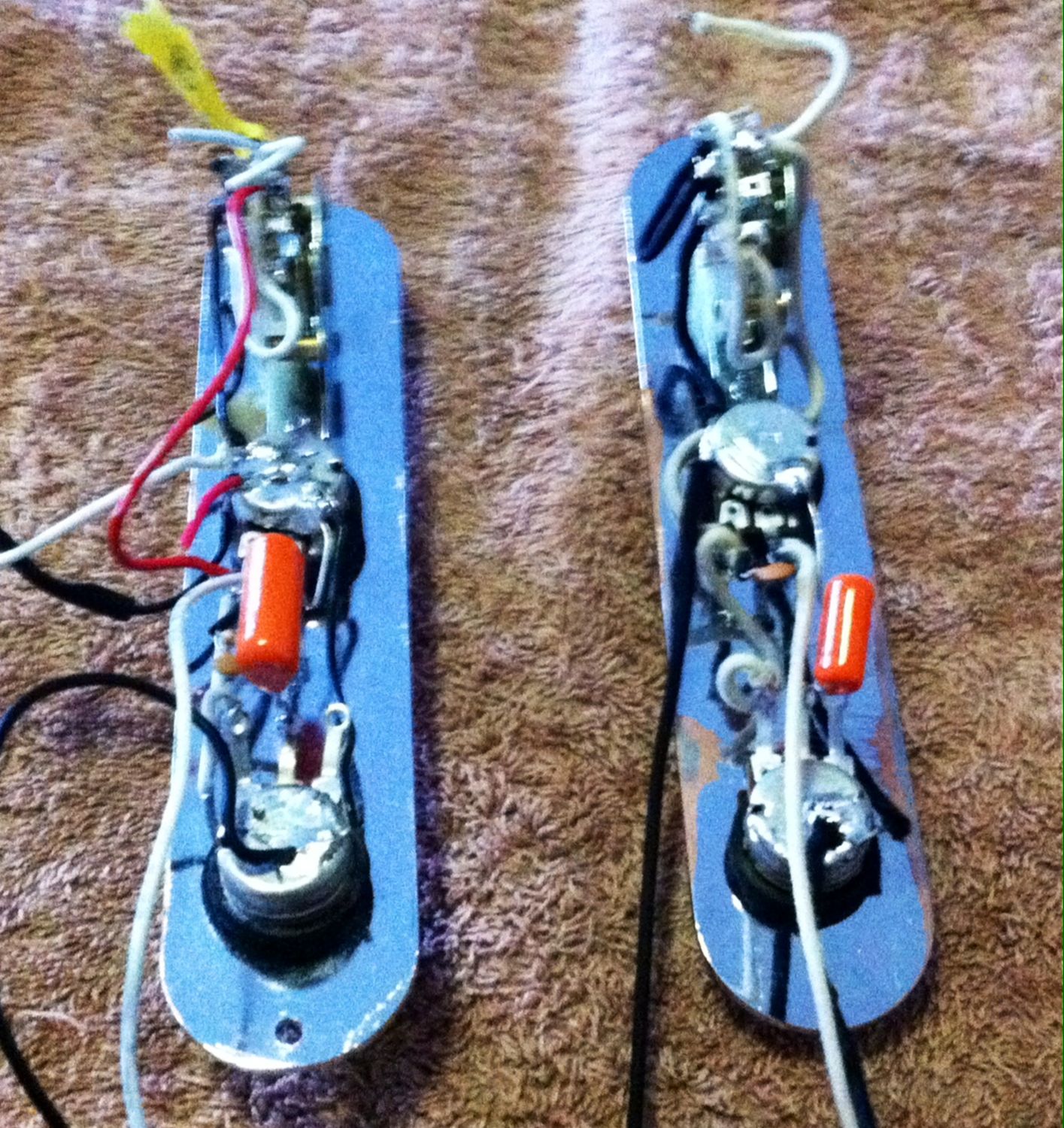

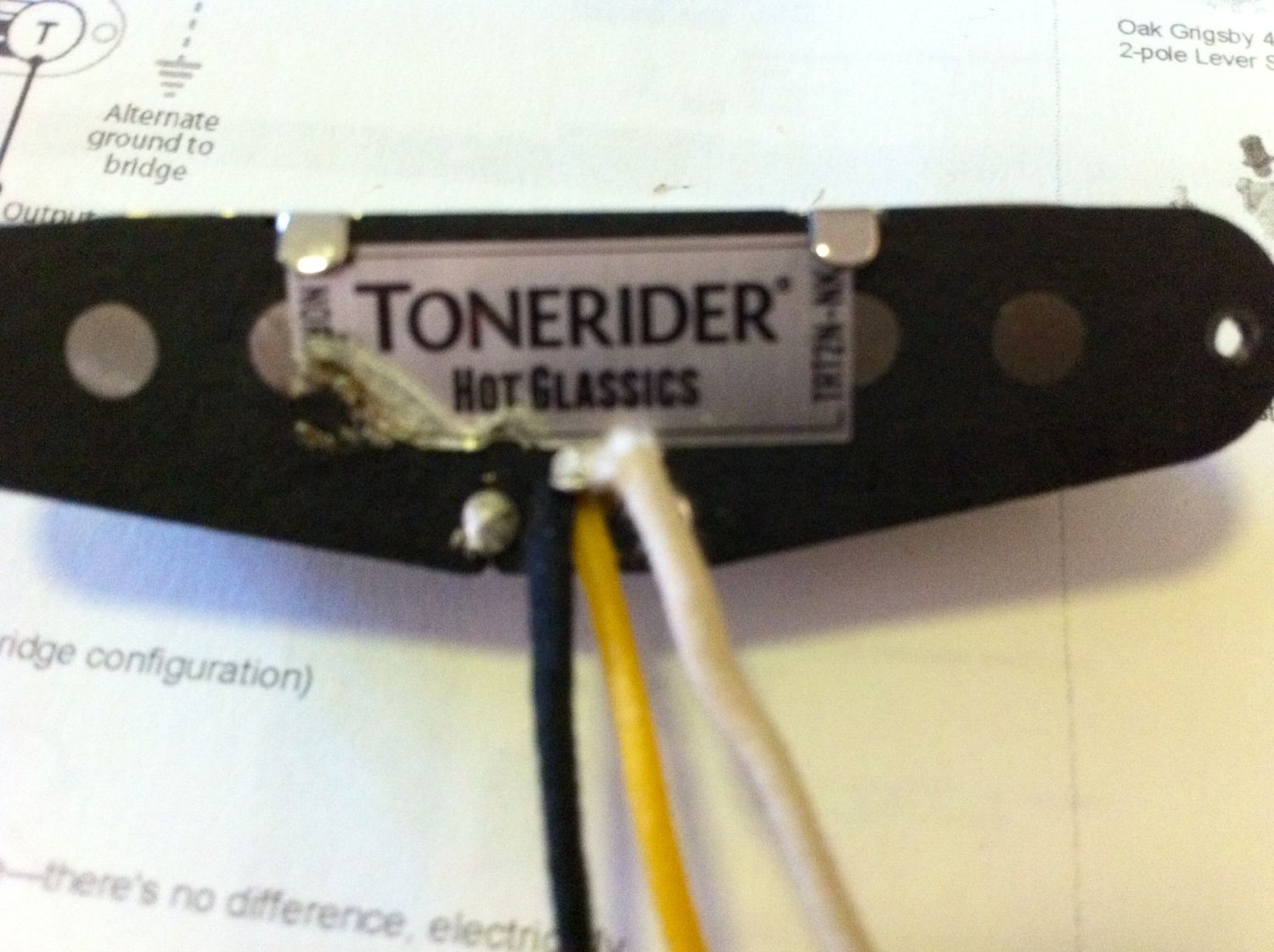

    Meanwhile back in the workshop/garage 3 coats of TO have been applied several hours apart. The missus clued on late this afternoon as she recalled hearing something fall last night and was waiting for the commotion which didn't eventuate. She reckoned I should have left it as it was thus providing a distressed timber look which we guitar folk called reliced. Too late as I had already sanded back and want the front to match the back.
    Anyways, the other non PBG Tele was ready to reassemble so I took the opportunity to wire up the control plate for this one whilst the soldering iron was hot. Also doing a 4 way switch mod where you have to de-solder the earth on the neck PUP and run a separate earth wire through to the controls.
