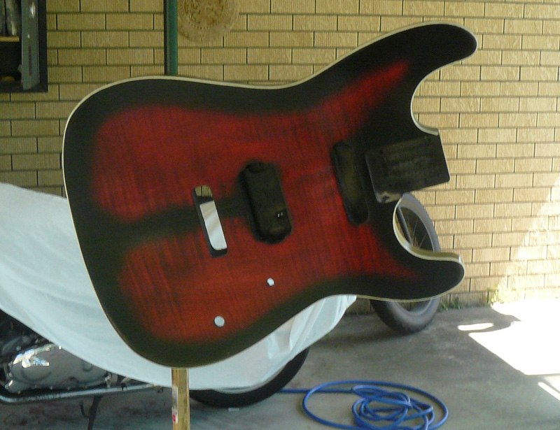

    yup very thin border to hide some glue I couldn't shift. Red is already done
  2. #102
    ok look forward to pics after the burst is done Dedman !

    first clear coats are on

  4. #104
    looks great Dedman, is that black strip around the centre to cover more glue ?
  5. #105
    yea, it was pretty thick, by the time I'd dug it out I had to fill it with timbermate
  6. #106
    fair enough Dedman, looks cool anyway. How did you clean the binding did you mask it or clean/scrape it after the burst ?
    glad you cover your motorbikes, would hate any overspray to land on them !
  7. #107
    I masked it then had to scrape it anyway there is always some that gets under. I just use a bit of 800 grit paper folded down to about a centimetre square and us my thumb as a guide on the edge.

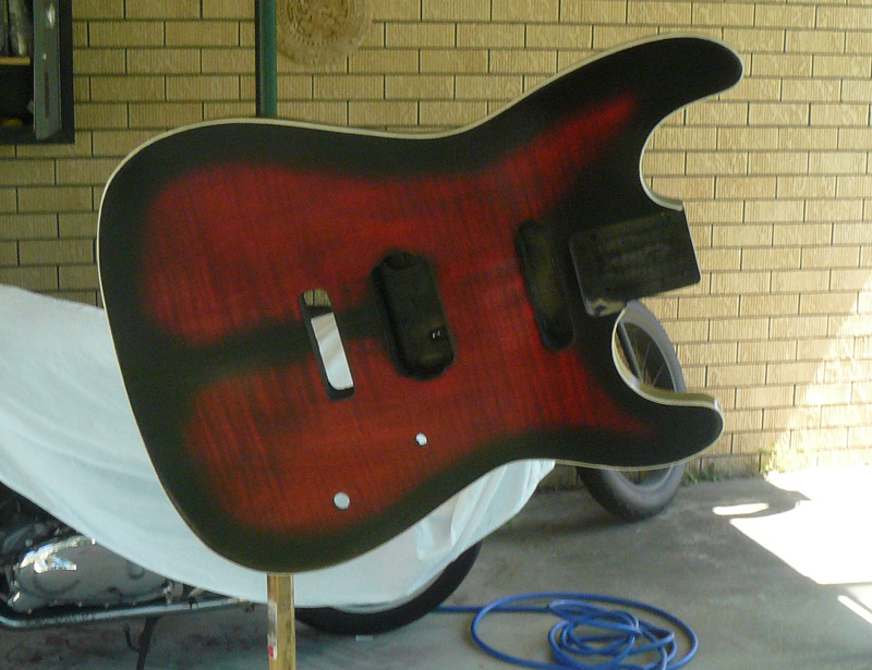

    Quote Originally Posted by dedman View Post
    me likey!!

  9. #109
    stunning day here today, I sanded and put 2 more coats on, so that's it, just final sand and polish to go on the body. Bad news is my 1k push pull pot arrived...but it's not a push pull, the idiots sent a normal one.
