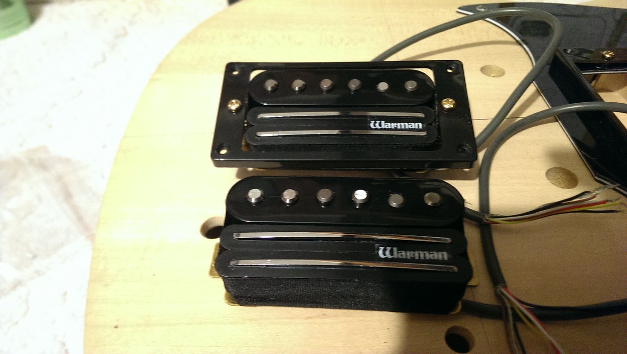

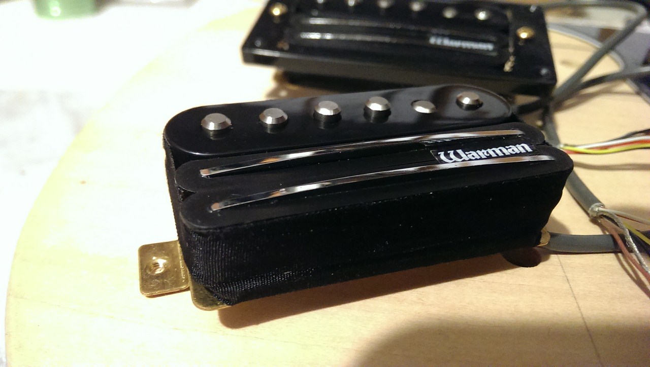

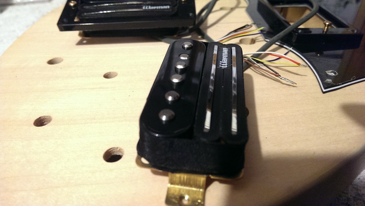

    Pickups
    Pickups arrived last week, been out of it for awhile due to sickness and work back injury, not serious just painful.
    They look pretty meaty

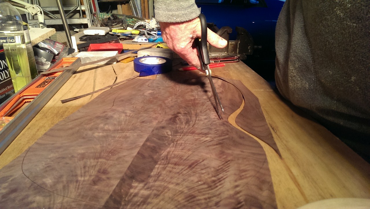

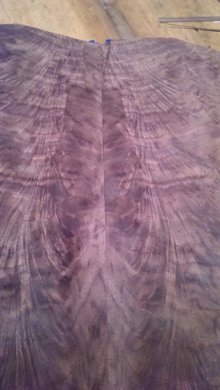

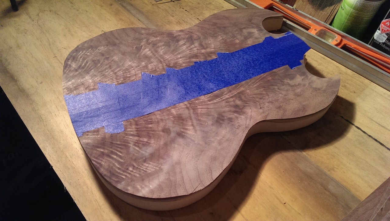

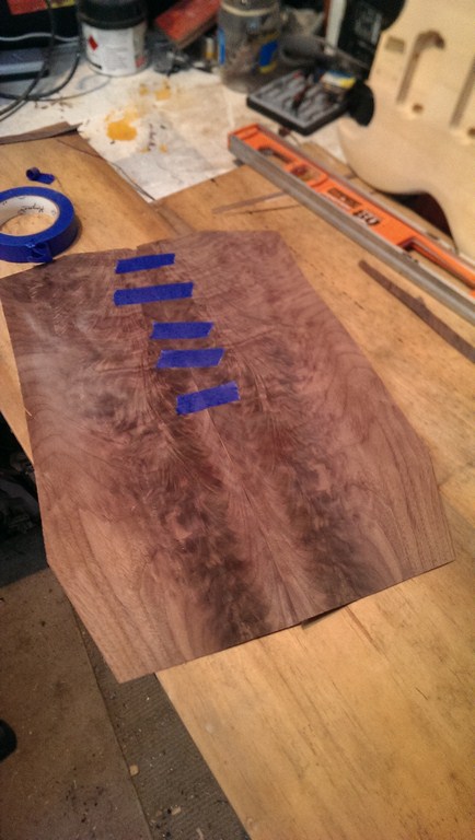

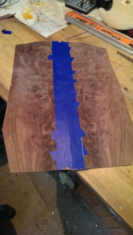

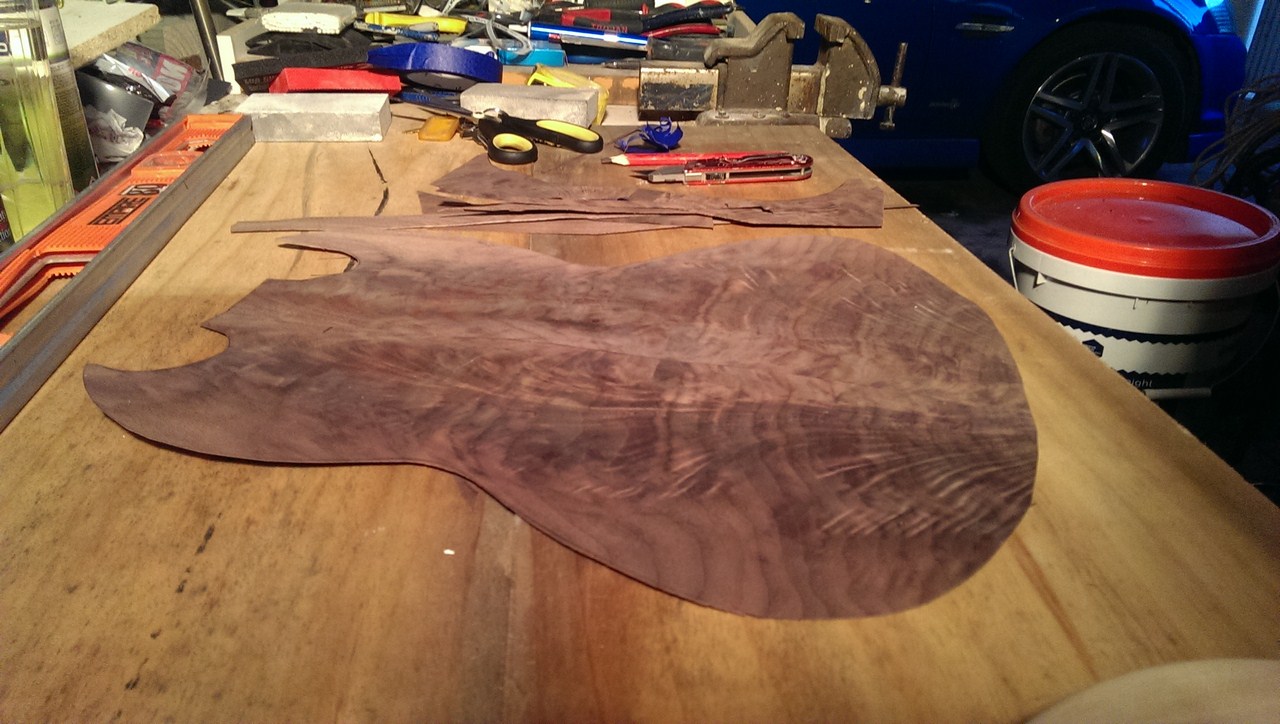

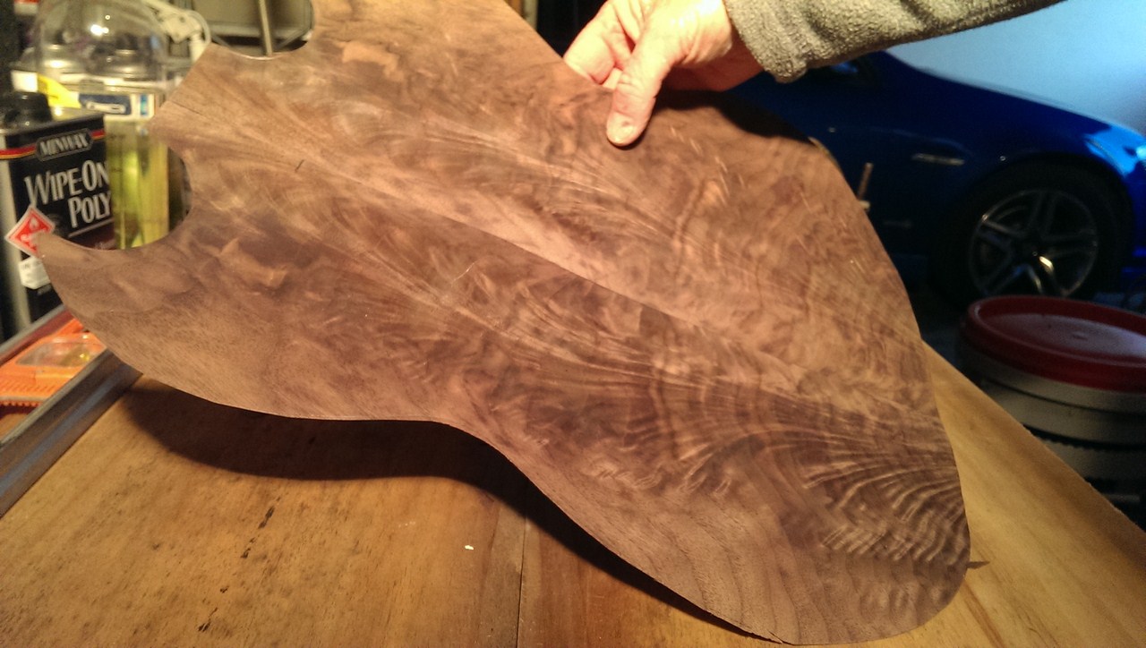

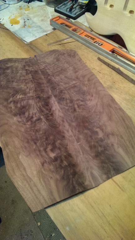

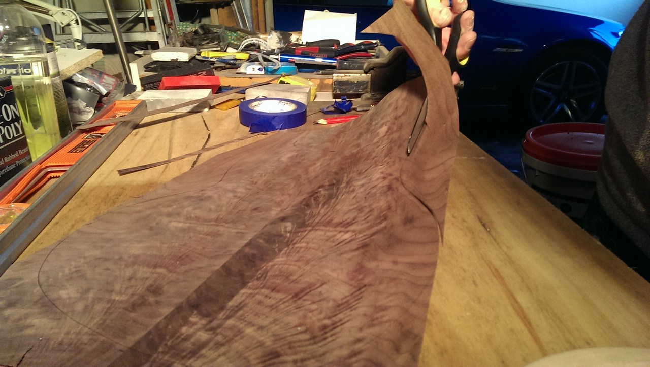

    Starting Veneer
    Veneer was a bit warped so i did some research and wet them and sandwiched them between two bare bits of timber then weights on top of them, it worked, nice and flat now.
    Measured them, lapped them and cut them, taped the edges together ( credit to youtube) then cut them out to guitar body shape.
Name:	IMAG2669 (Copy).jpg

  9. #109
    thats gonna look SWEET
  10. #110
    Jun 2016
    Mount Gambier Australia
    1,171

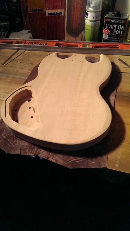

    next set of pics and question please, will i have to cut out the humbucker holes before i glue on the top??
    Thanks again in advanve guys...
