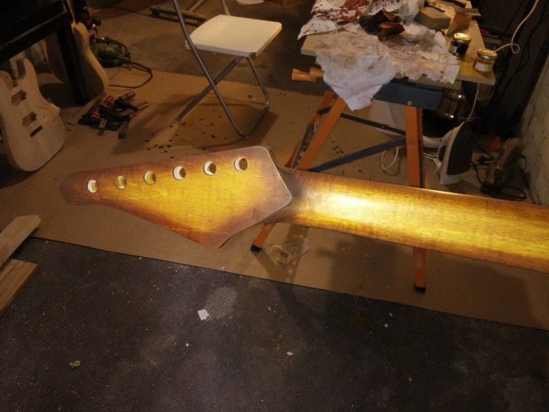

    Anyway, I attempted a bengal burst/tiger burst/tobacco burst, whatever the technical name is. I've not done a hand-rubbed burst for a long time but it was quite fun. I'll probably make some more adjustments tomorrow.
    I initially wanted a lighter brown but as I applied more (By accident actually! I spilled my jar of stain all over my table so I had to mop up the excess with my rag.) I grew to like the darker brown burst.

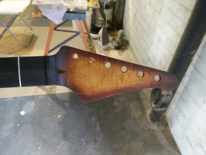

    Here's the headstock, without flash.
    With flash:

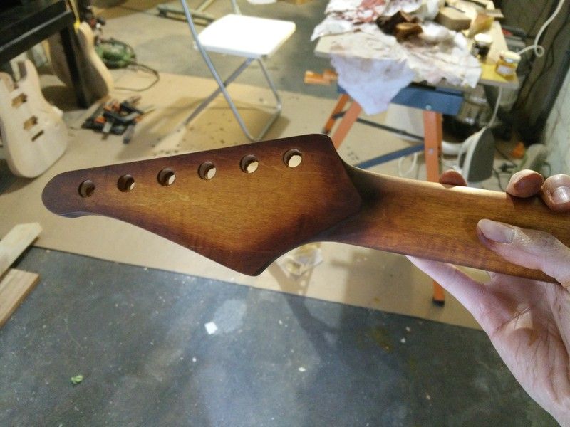

    The back of the headstock:
    I'll probably stain the entire back of the headstock a uniform brown because I think I want the burst to only be in front.

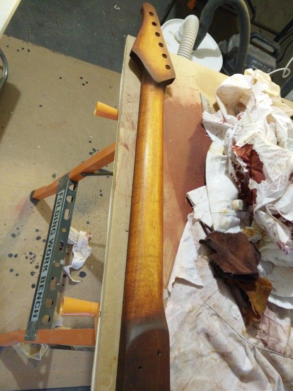

    The neck.
    Again I was rather disappointed with the lack of flames on this flamed maple piece. The top has stunning flames, but a pity this doesn't.
    You may notice that I also added some dark brown to the volute and the heel. I was trying to go for the vintage Les Paul jr type sunburst and it turned out quite well. Actually the real reason was because I forgot to sand the end grain to a higher grit so these were the parts which soaked in a lot of brown stain. I was tired of sanding back the brown so I decided to use it to my advantage. Turned out pretty okay!
