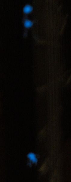

    the side markers in the dark
    Back
