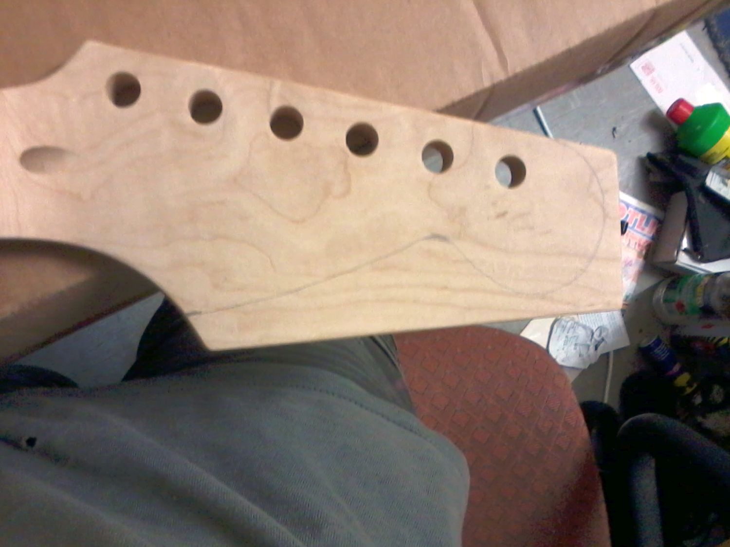

    I almost forgot to add that I'll also be going with the traditional Strat headstock shape for this build, I happen to have a spare Mighty Mite Strat neck that i can use to make a template from.
