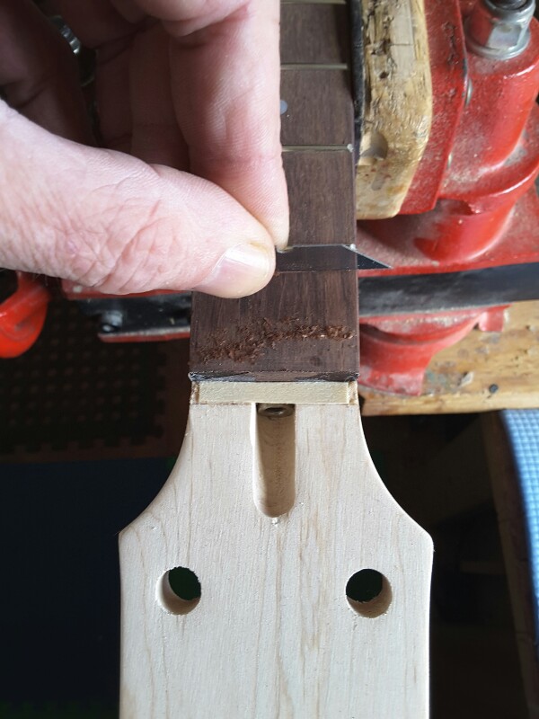

    Is that the only way? I would've thought going across the grain initially would've knocked the high bits off with less effort?

    As for your rough fingerboard, you can use a Stanley knife blade as a cabinet scraper. Easy to get right up to the frets.
