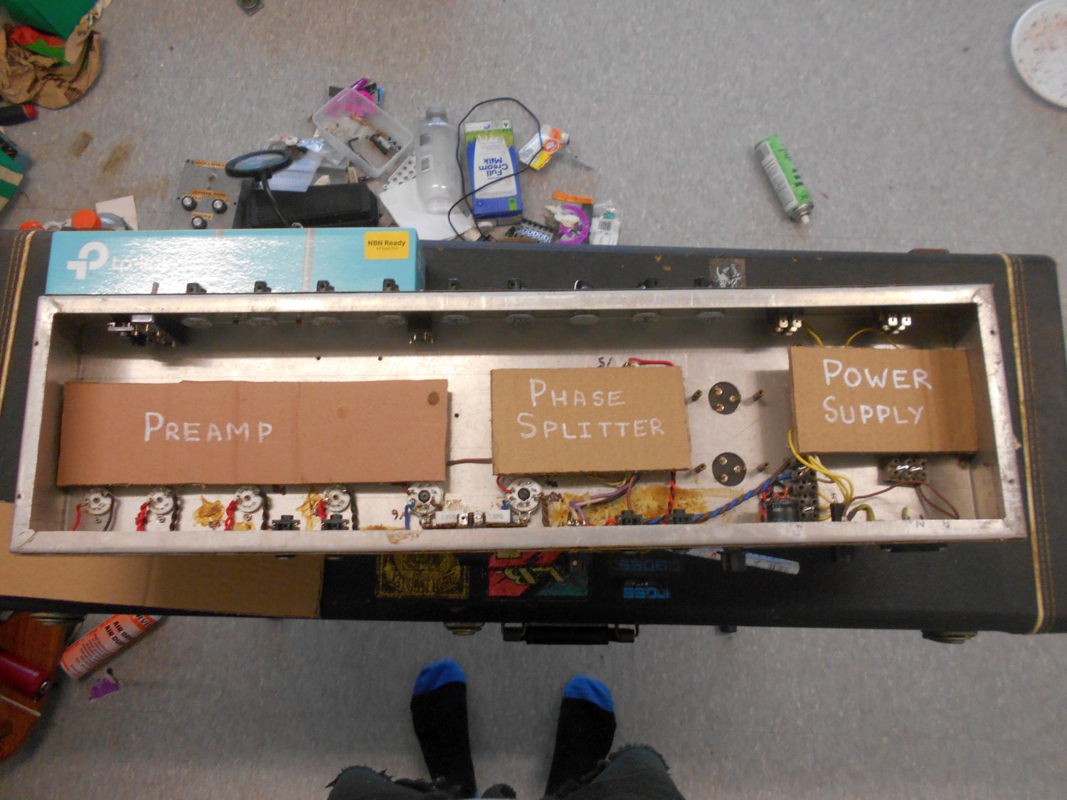

    It's a bit of a quiet and rainy day at home today, so I thought that it would be a good excuse to do some work on getting things organized with regards to the parts and bits and pieces needed to complete my Sloclone 50 amp head rebuild, to start off, I'm in the process of evaluating how many sheets of blank fibreglass turret board, and turrets I'll need to order from Evatco to make the turret boards for the amp, Evatco stock two different thickness of blank fibreglass turret boards, a 2mm thick board and a 3mm thick board, you can order them as a 300mm by 60mm sheet, or a 300mm by 80mm sheet, I'm going with the 2mm by 300mm by 80mm sheets because they are closest in dimension to the specifications in the pdf layouts I'm working with, the only issue is that the length is a bit short but I'm going to get round that by building the majority of the preamp circuitry on one 300mm by 80mm board, and then build the phase-splitter circuitry on a shorter board, hence the reason why I need to work out how many 2mm by 300mm by 80mm sheets I need to order, also, I decided to go with the 2mm sheets because that will make it easier for me to cut them to length.

    What I've done so far is to cut a couple of pieces of cardboard roughly to 300mm by 80mm and a couple more to 150mm by 80mm (these will represent the phase-splitter and power supply boards), and then I'm going to use the pieces of cardboard to do a test-fit evaluation to see how it's all going to work out with regards to turret board positioning in the amp chassis, might see if I can take a pic or two so you can see how they are going to be arranged.
    Here's a pic of how the turret boards are going to be roughly arranged, although I may need to tweak it a bit later on, this does seem to work though:

    It looks like I'll need to order a minimum of two 2mm by 300mm by 80mm blank fibreglass turret boards, but I'll increase the quantity to four, that way if I somehow make a mistake on one of the boards (lets face it, in the real world nothing ever goes exactly to plan according to Murphy's Law), I can simply cut a new piece and start again, hopefully I'll get it right the first time.
    In the above pic the piece of cardboard labeled "Preamp" represents the turret board with the majority of the preamp circuit on it, likewise, the piece of cardboard labeled "Phase Splitter" represents the phase-splitter turret board, and the piece of cardboard labeled "Power Supply" represents the power supply turret board.

    The only spanner flying through the air with your design method Doc is the spacing of the turrets on the boards from Evacto. If you have included that on your cardboard cut outs then all is sweet, if not then Murphy is still possibly in the mix...
    Good point, I was assuming that the turrets are spaced 3/8 inch, or 10mm apart from each other (I think that's the standard spacing), the graph paper I'm using to create the layouts is 5mm square, so, if I space the turrets out every two 5mm squares, then it should be fine, hopefully Murphy doesn't throw a spanner in the works.
