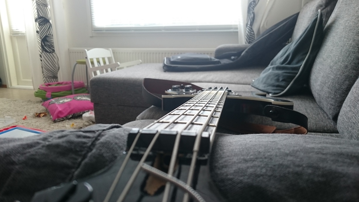

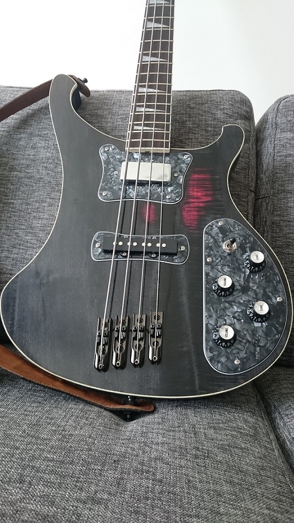

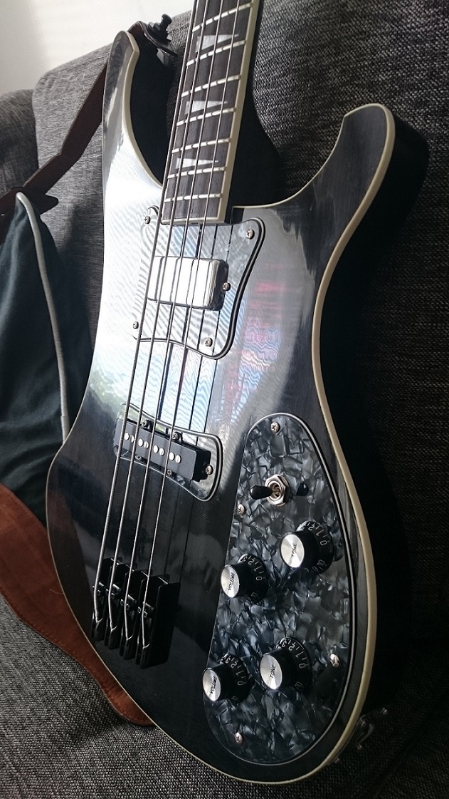

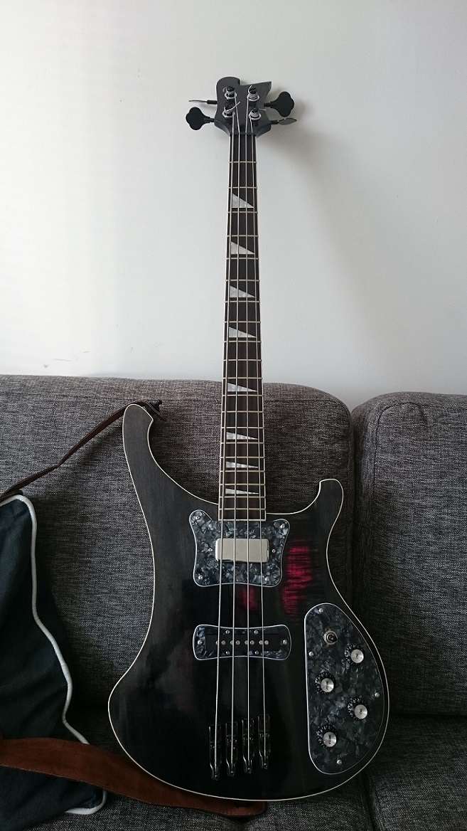

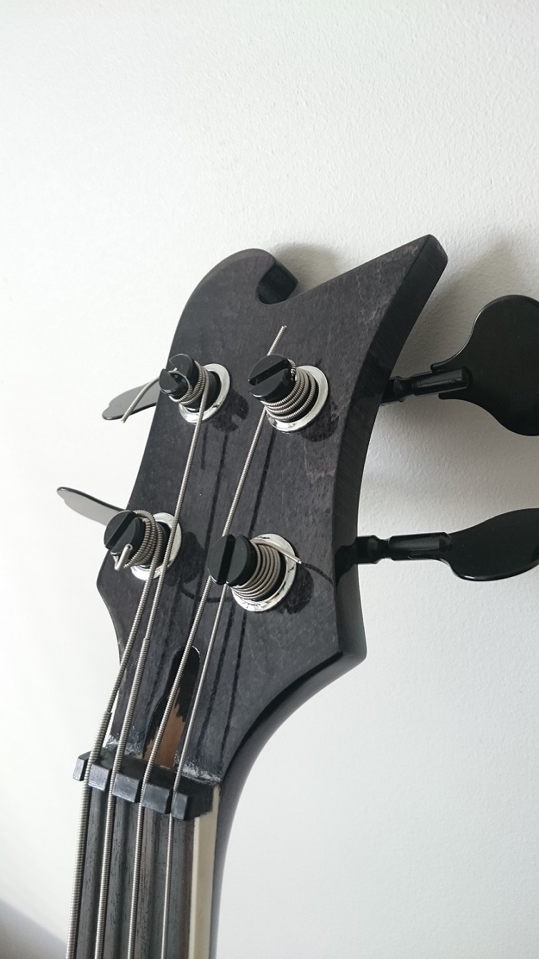

    HI,
    so here are some pics for you. One shows the "poor manīs fret levelling beam" I developed. I was not ready to pay almost 100 euros for beam and adhesive papers. I walked to a near by hardware store and bought a 20cm "bubble beam" and regular hobby paper glue my kids use to make their own "cut and paste" postcards. I cut some wet sanding paper strips and glued them for about 10 minutes with a clamp and voila - had a sanding beam. Worked perfectly and the paper was easy to change as you could just peel the old one off. Cost me 4,90 euros total cause I had the paper already.
    The individual bridge saddles at the end were about 1-1,5mm towards the E-string. Still the strings are perfectly in line with the neck so I donīt know what caused this. Could be the bridge pickup cavity is a bit off but it doesnīt matter cause it does not affect playing. String spacing is even 20mm at the bridge between all strings.
    The neck of course is somewhat wider than my jazz I use at the moment so feels slower of course.
    The nut was ridiculously high as you can see in the pics and I still have some filing to do cause itīs still too high for my liking ( about 0,35mm at the first fret when pressing 3rd fret down). I might still put the bone nut on later cause as you can see the strings go too deep in to the nut. MIght also file this one down - donīt know yet.
    The truss rod works fine and at the moment Iīm about in the middle of all positions at the adjustments so have plenty of wiggle room left. Intonated great.
    So here you have them. Gonna do the truss rod cover after I get my logo designed.
