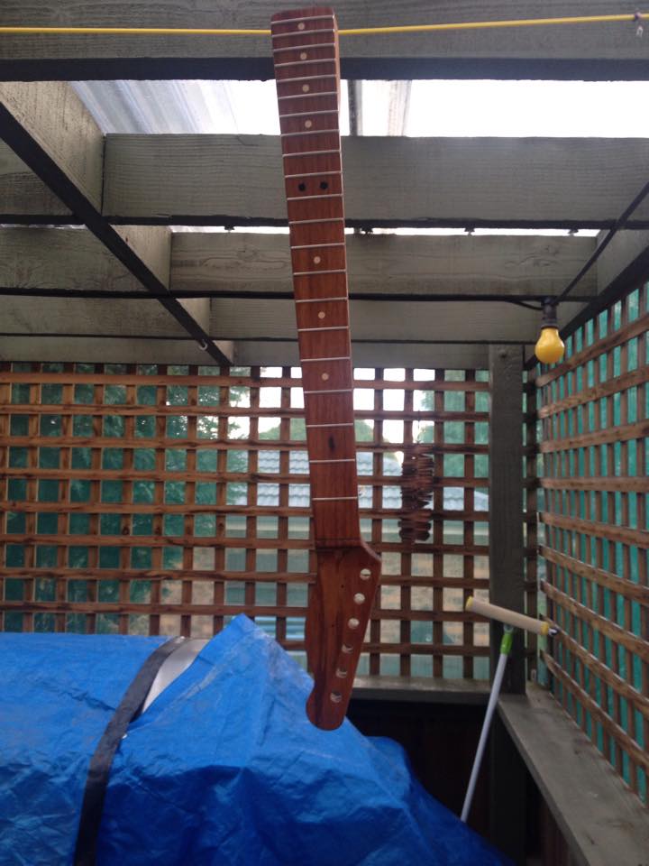

    Update!!!
    So I finally got some finish on something!!! The pictures are right after hanging the neck up with a coat of linseed oil on the neck and fretboard. Looks so nice in person, has a shade a lot more like mahogany than blackwood which is really cool!
    Also note my super high tech drying system, just a portable washing line thingo with a 3.5mm brass hook screwed into the neck joint screw hole, also works for bodies if you do it in the strap button holes and it taps the holes too which is an added bonus!!!
    So I have decided I will go with the DT burst and my top coats will go as follows (body and neck will be the same)
    Coats 1 and 2: Linseed oil
    Coats 3 and 4: 50:50 Linseed oil / turpentine
    Final: DT wax
    Hope to get better pictures up tomorrow arvo, the neck is now hanging in my room in my wardrobe as it has been touch dry for a bit, having it in my room now makes me room smell nice, I do like the scent of linseed oil
