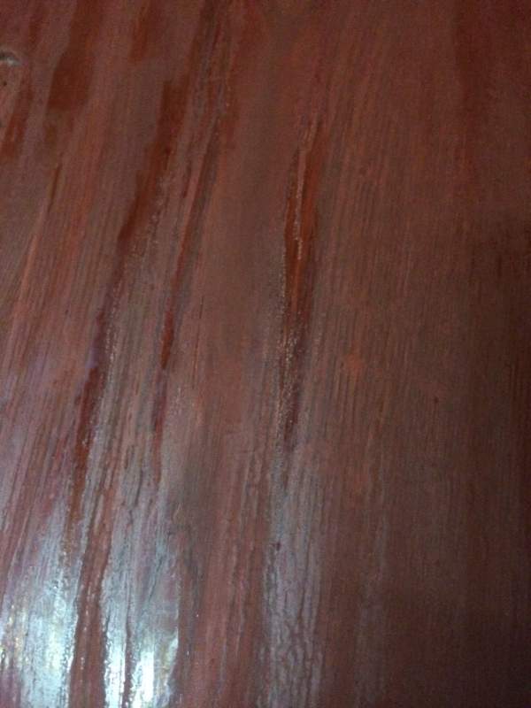

    Second coat of the body top coat has been settling for 4 days now. (Dingotone final coat)
    From it's appearance I'm wondering if there's something I'm doing wrong.
    The shiny sections are smooth like one might expect a top coat to be. The duller parts feel like wood.
    This was applied with a cloth, swipe following the grain, then swipe next to that and so on across the body.
    Am I putting it on too thin or are the shiny parts too thick? Are they what I should expect as the finish?
    To be clear, the dull area far surpasses the shiny area. This is the back, most of the front is dull.
    - Sam
    IB-6S - done.
    it could be just a combination of thin coats and varying permeability of the timber: it is soaking up differently across the body. You might simply need to keep going.
    DB recommends fairly generous curing time too, as there are no curing agents in Dingotone
    I'm with Stan, I would keep going with maybe superfine wirewoolling in between coats and see what happens (with ample curing time between each coat)
