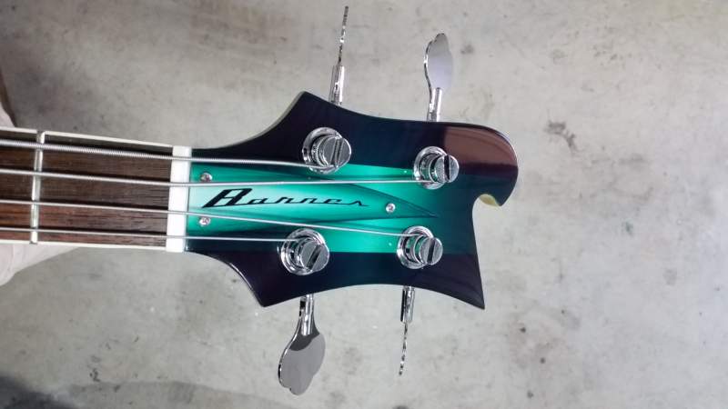

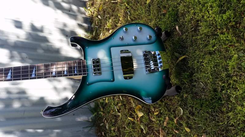

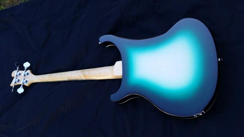

    To complete the diary, the pickups used are an Entwistle JBXN neck pup used in the bridge position - for pole spacing, although its still a little wide - and wired with reverse polarity and 250k pots and .047 cap and a Fender Fideli'tron with 500k pots and .022 cap. The tone for the humbucker may need a different cap as it doesn't make a lot of difference, might sound better thru a bass amp. There is a 'modified' wiring diagram for it using 250k pots and a .068 cap, maybe this would work better.
    Some more pics

    There are some marks in the finish I wasn't sure if there was enough thickness of the naughty oil to sand them out, will get more marks from use.
    Thanks again
    Grant

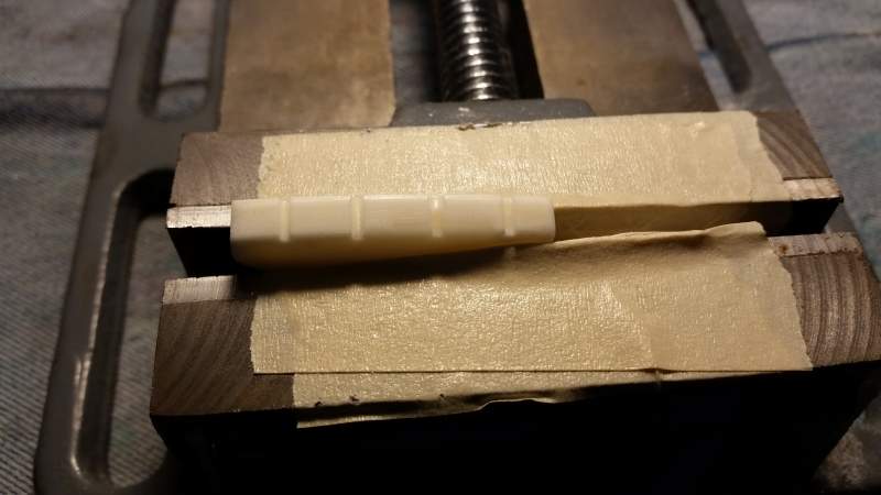

    Be prepared for t-oil to mark easily mate. My strat's covered in little marks here and there. It's not exactly a tough finish but it will wear very nicely if you're into the 'used and abused' look.
    What's the deal with the nut in the vice? Looks like it has a very heavy taper

    Just the angle of the pic.
