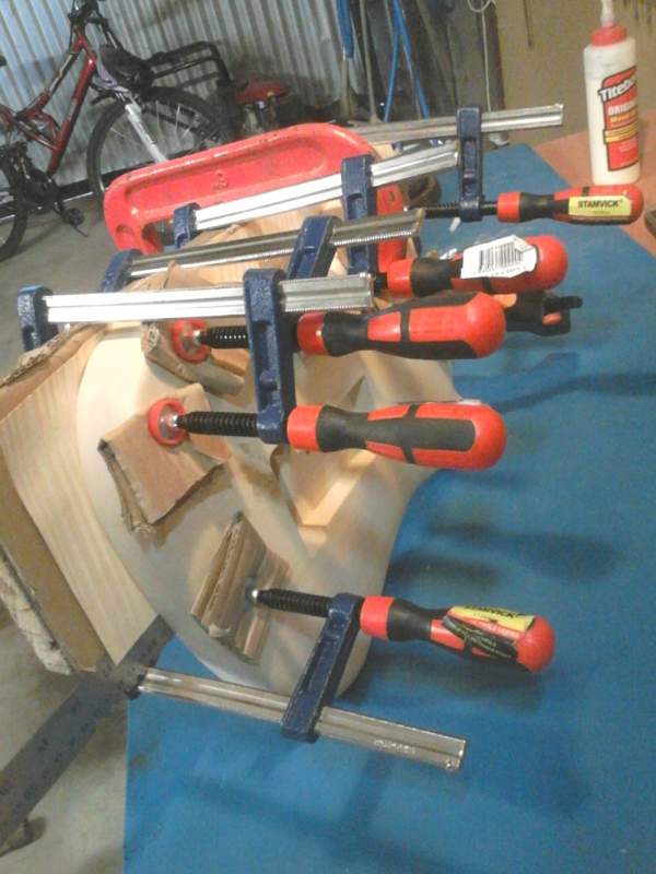

    Hey cheers for tips @Wokka,Weirdy, I followed your suggestions and managed to get a really clean join between the two halves and they book match up nicely.
    I've decided to do one half at a time, reason being I want to be able to eyeball the joint on the second half to make sure it's butted up perfectly, and eliminate (or at least reduce ) any movement when putting the clamps on.
    No looking back now...

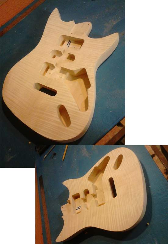

    One flame maple cap...done.
    Had one chip out when cleaning out the cavities up the tremolo end, (of course it had to be one of the only spots not hidden by the pickguard), other than that it went fairly well, I'm happy.
    My biggest concern now is getting tear outs on the cap when routing the binding channel, if I can get past that stage with no dramas we should be home and hose (famous last words).

    That is looking very tasty, really nice job Barge.
