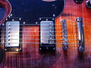

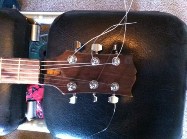

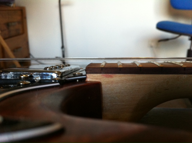

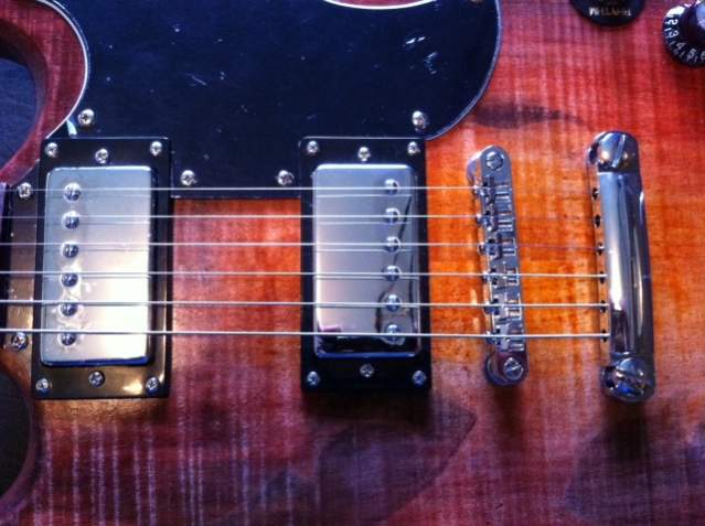

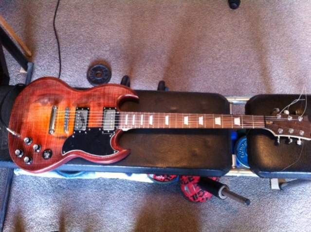

    Hi Guys,
    I got the pickups earthed and strings are on
    I tried to intonate it but it sounds awful.
    I adjusted the action and it looks pretty good
    I tuned it basically to a clip on tuner and then checked the intontation on the 12th fret and each time I pressed down on the string behind the 12th fret it seemed it was on the flat side but the saddles are wound all the way forward so I think you have to shorten the length but there is no adjustment.
    On the video they end up too sharp and he winds the saddles back where you have plenty of adjustment to bring it back to the same note octave equivalent (I think?)
    I think I must be doing something wrong.
    I wound the strings too tight but didn't want to go too far and break them
    There was some awful static thru the amp and I checked all my earths and connections then changed the power cord over and it cleaned up nicely.
    I think all the controls work O.K. and the neck seems to have straightend up also.
    Adjusted the pick ups to about 3mm below the strings
    Any suggestions would be appreciated
    Thanks heaps,
    Alan

    If you are still struggling with the intonation then it may pay to check your scale measurements again. I know you checked then here and it looked ok, but now that everything is glued in and strung up check again just to make sure the numbers are where they should be.
    Post your results (nut -> 12th fret crown, 12th fret -> high e saddle, 12th fret -> low E saddle) and then we can work through the intonation process and sort out if something is wrong.
    Btw, the SG looks great.
    Clip on tuners aren't as accurate as plug in tuners. Use your ears and compare the fretted 12th fret with the 12th fret harmonic. The harmonic is correct.

    No strings have a buzzing noise but when I strum them they tend to rattle which I think is because the action is too low but I have raised it about 3mm off the 24th fret so I don't want to lift it up any further.
