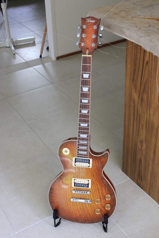

    Anyway, glue spots and machining marks not withstanding, I got the kit together for a mock build in next to no time. With the neck straight in the pocket, the bridge and stop-bar posts have been positioned correctly (phew) and the E strings travel straight up the fretboard. At it's lowest bridge height the strings are on the deck at the 22nd fret, so all in all she's looking pretty good for a straightforward assembly!
