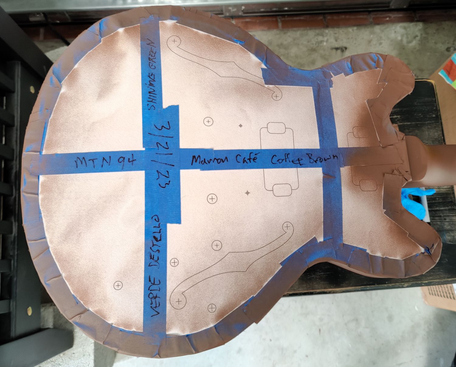

    I also wanted to know how do u choose the colour of the back & sides of your guitar build and back of the neck?
    I tried a few stains yesterday which i though could go well at back. These were all natural wood colours like teak, Rosewood and Redbrown.
    Redbrown turned out to be as same as red stain. The other two are sort of OK.
    I also have this problem. There is colour seepage despite me using a fineline tape. You can see it in above pic if you zoom.
    Is there a way to get a fine line or workaround for it?
    I may choose rosewood if I stain the top orange and the teak one if I choose the olive green.
    Top could be one of these
    I have finally masked the top and sides of the body and neck. So that i can start staining the back of the body and neck. Is this OK?

    The sides of the FS-1 kit is sandwiched between binding on either side. I really hope it doesn't seep through that. I have been reading from forum and other groups telling me to apply a thin quote of clear over the binding before staining so that it resists stain. I will have to try to do that. I am staining the back first and then the sides and I am keeping the top for the last. The tape I have used is low tack. I really hope I don't have to keep it much longer. I shall try to remove it as soon as Possible
    I went to the timber shop the other day. In india they don't have basswood samples. Seems They are not native to India. So they gave me 3 slabs of Steam Beech wood which looks similar in Colour to the veneer and back. Now I have something to try my colours on to see how exactly the shade may look.
    Edit: I did try the colours now. Tried Pinks and Purples and couple of them are pink and purple mixed in different ratios. Tried Green, Green and yellow on top, Orange and Blue.
    I am still unable to make up my mind on which shade to stain. I like the blue but I have 3 blue guitars already. Orange and olive green and pinks too look good. I may try to dilute the purple today and stain again today.
    What do u guys think?

    Finally tried all the colours on the Steam Beech wood.

    I do a lot of agonizing about color choices. However, I think I have evolved a sort process. I start with "things I can't/won't change" and things I want to highlight. I also have a bias in that I generally want my electric guitars to look more like a hot rod than like a piece of furniture. So starting from there I just see what emerges.
    With my "hybrid" (Fender neck on an ES body) the pickups really drove the color choices. I had cream colored pickup bobbins. I googled cream pickups and looked at a lot of images of guitars that had then. I ended up liking "surf" colors. I had messed up some parts of the top, so it was going to be a solid color. I had also accidentally drilled through the headstock installing the tuners. BUT I loved the grain in some parts. So I painted the top a color like the old GM Daphne Blue, and made a two-tone headstock (part blue, part bare). I thought the grain looked good on the back and sides, so I started looking for stain colors that would go with it...and then realized that the sides and back already looked really good with the Daphne blue without doing anything to it...so I left it bare and just clear coated.
    My ESB-4 started as red...trying to emulate the old red Epiphones of the '70's. The paint never worked well, so I have stripped it will start sanding clear coat soon. I wanted it to be a color a but more appropriate for playing with a bunch of folk/bluegrass guys...but was not ready to abandon the hot rod aesthetic... So I painted the top and back of the body cream colored and the sides and neck cream. The colors of the first car my father ever bought new... A two tone Chevy Bel Air. In my memory it's a 1956...but I only remember it from pictures...
    To me, if you like the color, blue or whatever, go for it. It does look good ;-) BTW I am guessing that the beech should be a good test bed, since it is a closed grain wood like basswood....at least that's what I read ;-)
