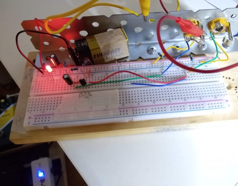

    Still haven't recorded anything, but I built a mosfet-based boost on breadboard tonight. It's sort of a modified SHO (Soulsonic Crackle Not OK) set to max gain (no gain pot). Sounds quite good with guitar, and gets the level of the speaker transducer up high enough without too much noise despite being on a breadboard.
    No bassy thump, but I haven't added a tone circuit yet. I think it would make an interesting boost pedal for guitar with the addition of tone and volume controls.
