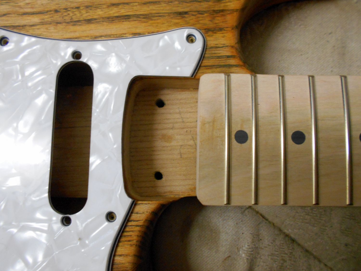

    There's a bit of an issue with the neck, I'll post a pic of the neck for you, see if you can spot what the issue is:

    Is that last bit of the fret board on an angle?

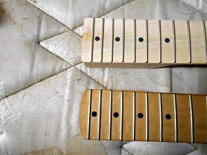

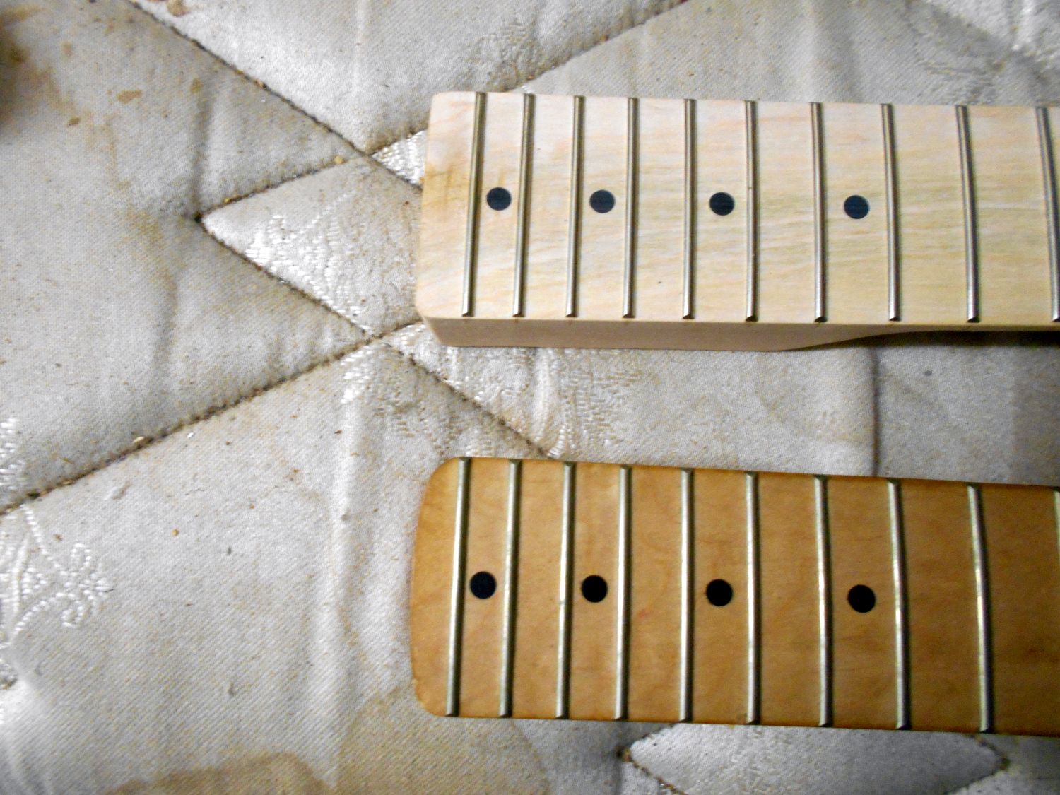

    Yep, but more to the point, the heel of the neck is straight whereas the neck pocket has a curve where the neck heel is supposed to fit, I think someone at the factory was either a bit tired, not concentrating, and, or, a bit hungover.
    Here's another pic with the old and the new neck so you can see how the heel of the new neck should have been shaped, the old neck is the darker coloured one:

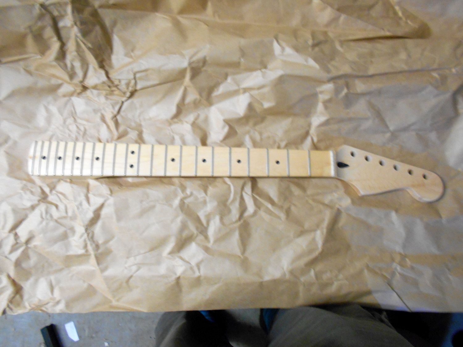

    Look what just got delivered to my front door today, yes, it's the new Mighty Mite 22-Fret Maple Strat Neck I bought on eBay specially for the rebuild/refinish of my Gold Standard Strat:
Name:	New 22Fret Neck_resized.jpg
    The new Mighty Mite neck is a bit loose in the neck pocket, but I'm going to use it as the main neck anyway, firstly because the nut looks like it was cut really well and I won't have to do any tweaking to get the 1st-fret action right, secondly it is set up with a 9.5 Inch radius, thirdly, it's already got a satin finish on it, so I only need to re-finish the body.
    The other Maple PBG neck is going to be kept as a spare one, I might clear coat it with some White Knight Clear Gloss Acrylic later on this year after re-shaping the heel and headstock.

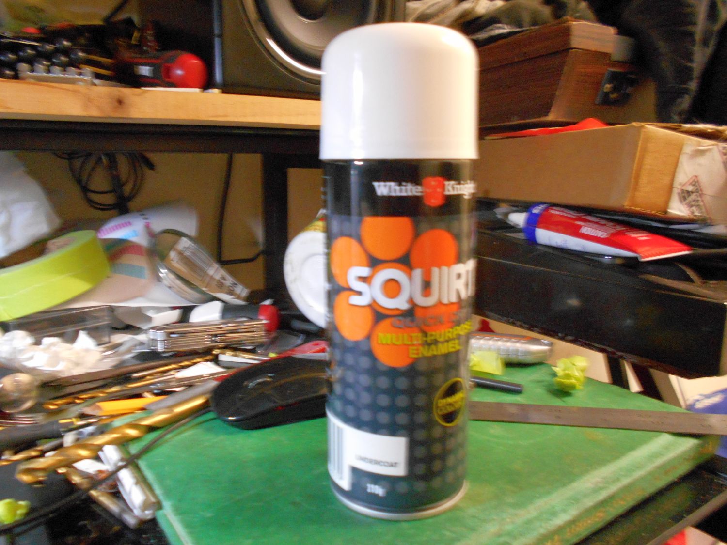

    Okay, so here's a pic of the White Knight White Undercoat paint I bought on Friday, as long as it doesn't react with the remaining traces of Dingotone, I'll be happy:
Name:	White Knight Undercoat_resized.jpg
    It does say on the can that it is suitable for use on most surfaces including Timber (ie, Wood).

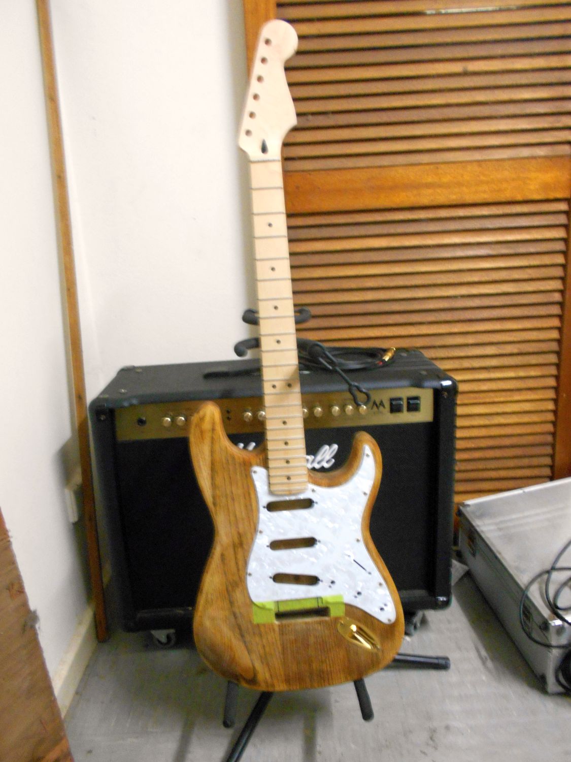

    I was having a bit of a hard-time getting to sleep, so I thought I would go ahead and drill the mounting-screw holes in the Maple Mighty Mite neck I decided on using on my Gold Strat, I think I managed to nail the alignment of the neck before drilling the holes cause I checked the alignment using a 600mm steel ruler, everything looks cool, I'll see if I can post a pic of the Gold Strat as it is, so stay tuned.

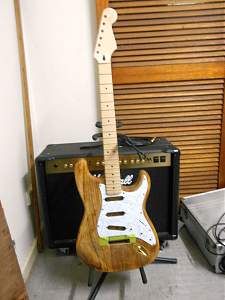

    Here we go, here's what it looks like with the new 22 Fret Maple Mighty Mite neck attached to the body:
Name:	MM Neck Attached 2_resized.jpg
    The light-green piece of tape on the body was put there so I could check the alignment of the neck, I placed the 600mm steel ruler against each side of the neck and used a blue felt-tip marker to mark on the tape where the edge of the ruler lined up with the bridge-route, it looks pretty centred to me.
    Note: That's my Marshall amp behind the Strat, with it's new set of casters installed to make transporting it much easier.
