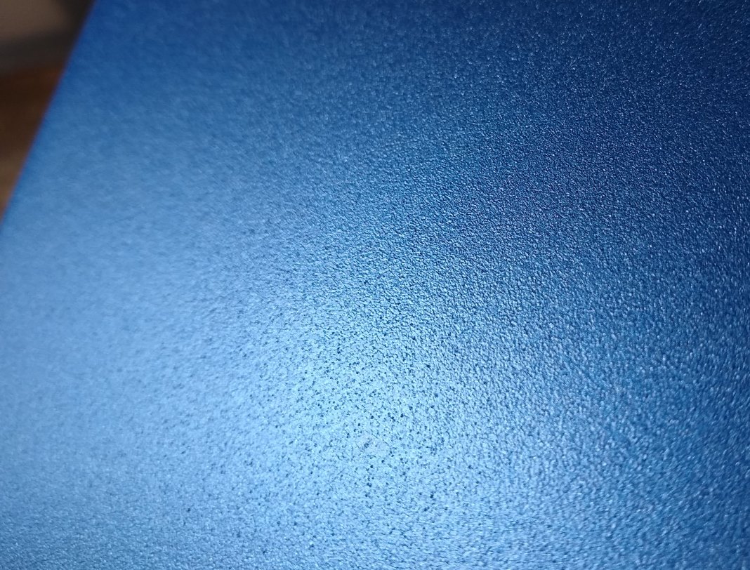

    Here are some photos (lighting not great, sorry), but you can see the large difference in glossiness between the sides:
    and the top (back is same as top for the most part):
    Looking at that photo close up it's easier to see than in real life. To me it looks like a combination of orange peel and the dried paint particles from spraying too far away. But I really don't know which is why I am posting the photos here.
    Also, I will test the clear lacquer over the poly on some scrap wood.
    For a good accurate test I would suggest making sure the coats of poly are completely gassed-off (ie: can't smell any solvent when you sniff it up close) before you spray lacquer over it or you will definitely have a problem. And your poly "base coat" wants to be as if it were a proper finished coat, not just a couple of light passes that basically get absorbed before they begin to build.
    re: The pics - sides do show minor orange peel. I've had worse and got it to level & polish well. And top does looks like over-spray/dust causing the dull appearance.

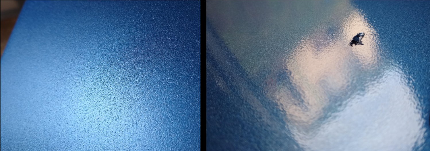

    OK, so I sanded lightly with 320 and then did my second respray (is that a rerespray?). Holding the can consistently closer made a big difference. Less coats applied but much better coverage and the finish is now glossy. There is a lot more orange peel and a couple of runs, but at least that should be manageable as I finally have a solid clear with consistent gloss levels over the body. Here's a before (left) and after (right):

    Forgot to mention, the two photos are in approximately the same part of the body (but for some reason I cropped the bridge earth wire hole in the first).
