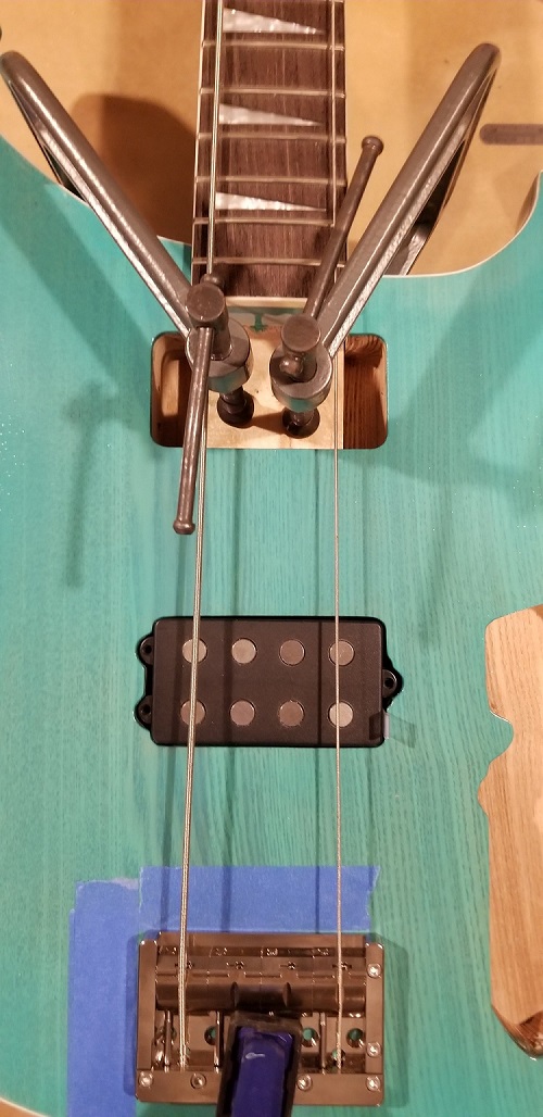

    Well... the deed is done. Glued in the neck. Cleaned up all seepage as she sat all clamped up. Once the nut is filed and set up, I think the action will be good. The MusicMan Humbucker bridge pup is a bit wider than the string spacing. Maybe been placed too far off the bridge. I positioned center, and shimmied the pup towards the E string. The G string sits a bit off center of the pole. 24 hour wait. Then clear coat when the weather allows.

    I still used a laser level. Found that it confirmed my indecision's. I did go thru and mount my E and G tuners, measured 34 inches from inside nut to 3/4 FORWARD bridge travel on the G string saddle. I strung line down across the neck, bridge. I'll add I purchased the KSM Full Contact Foundation bridge, clamped down, and measured, measured and measured. Clamps move, strings pull stuff out of line to be sure. My hope is I'm good.

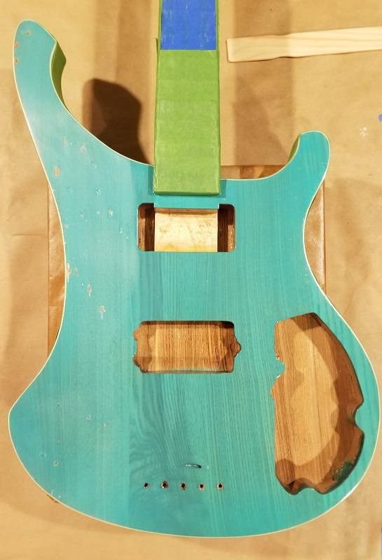

    Well, I guess my prep work from the beginning was subpar.
    Major setback. I used the recommended Mohawk Seal and Sand after sanding and staining. Apparently I didn't get enough product over the top to properly fill subsequent grain holes.
    It looked GREAT!
    The color coat went on fine, satisfied.
    The layers of lacquer from a rattle cans went on fine.
    Then, as I went along, bubbles appeared. And appeared.
    I drop filled and lacquered over and relatively corrected with good results.
    On the 3rd coat of clear lacquer, the bubbles were huge! They ate down to the grain. I realized I'd never get the open grain holes to fill.
    I watched as I dropped fill my color into the holes just bubble like Champagne.
    I got to strip the top down and start over.
    Heartbroken.
    The color changes in different light.
    I got a bit of bite when clamping in the neck, I think that can be repaired with lacquer as I go along.

    NOOO! Ah that sucks man, but such is building. You live, you mess it up. You learn.
    at least you’ll get to do more sanding! 😬😡
  10. #100
    Member OctoberBassRCA-4's Avatar
    Nashville, TN, USA
    106
    Yes Frank, I made every mistake. But it looked good.
    Too hot outside, too much lacquer build, my impatience got the best of me.
    Now I need to know how to preserve the back and neck which look GREAT! Is taping off along the binding (my saving grace) the proper way to save what's good? Is there another mistake waiting for me, probably.
