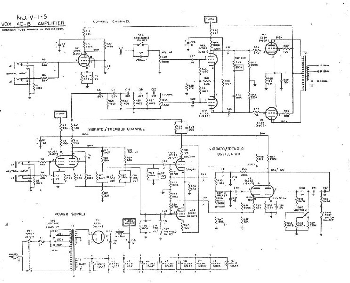

    For the few of you still following this thread I thought I'd share the circuit I used as a guide to build this animal.
    I used the AC15-60-02 and AC15-62-02 diagrams from 1996 for the build. I have made some changes to the high voltage distribution due to using a non-VOX power and output transformers, and not used the reverb circuit of V2 and V3, but the guts of the audio chain is unchanged. The EF86 (6267) addition will be lifted from the 1959 era NU.V-1-5 drawing with some additional switching to be able to select between the EF86 and the V5 ECC83/12AX7. Hopefully I'll somehow work out how to be able to make the tube changeover switching a noiseless remote function on the same hard wired foot pedal box as the tremolo on/off.

    I built myself an AC15 styled amp with the EF86 preamp, however, I added a parallel ECC83 input feeding into the EF86 and used two 6V6GTA instead of the EL84s. I must admit, I love the sound of an EF86, but trying to implement it into other designs is a headache.
    Have you read any books by Merlin Blencowe? His website is also really helpful (http://www.valvewizard.co.uk/)

    Hi IK7,
    No, haven't read any of Merlin's books, and have only just read some of his web site of which I'd agree 100% with. It doesn't matter if it is tube or solid state there is always a lot to consider when building amps. I find for myself that tube is easier to understand probably due to when I learned electronics in the '70's it was taught better by those who knew nothing else.
    What I did find interesting was a few of Merlin's comments which sadly (or it could be a good thing) will nag at me in the back of my head on any future amp build. On my previous builds the topic of grounding has been a big issue, and now after a quick read of Merlin's site this EF86 topic has developed a few new dimensions that I hadn't considered previously. Maybe I will not simply copy the AC15 input on this build upgrade, but be a little more inventive and adventurous.
    If you can get a copy of his book(s) they are well worth the money.
    The other thing I wanted to try of Merlin's design was his Morph control, which basically has a small signal pentode (EF86) and connects the screen and cathode together via a pot, so you can go from 100% pentode to 100% triode and everything in the middle. Having another valve feed into this could have some interesting results, especially if it's in cascade system.

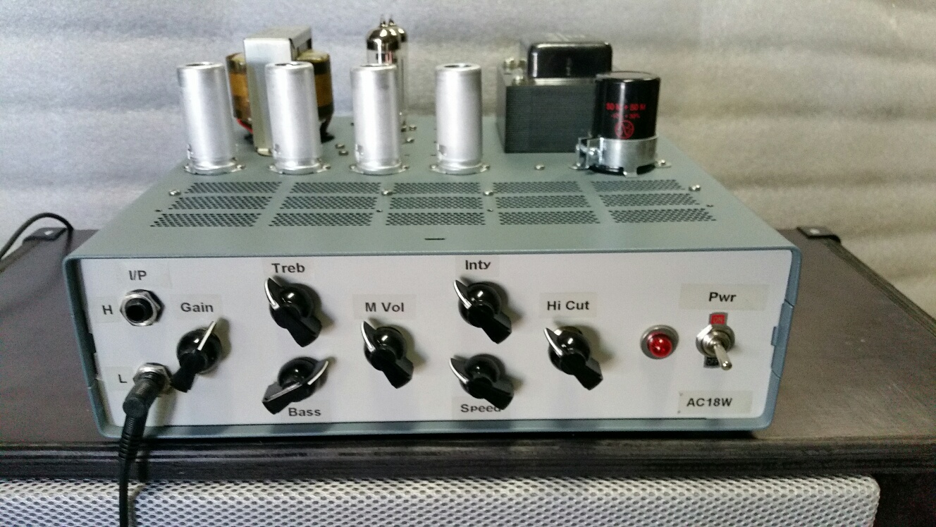

    For those that are interested a quick tally of the parts that have gone into building this amp comes to AU$690.85 which is a lot more than one would expect for what amounts to only a 15W amp.
    A case, the two transformers, $18.50 for each 12AX7 and $45 per EL84, sockets, nuts and bolts, pots and knobs, light and switches, electros and other caps and resistors. a IEC power receptacle and a few other minor bits like rubber feet etcetera. Then you can add to that about 20hrs of my labour to drill/cut/mount/solder & test, which at 'best mates rates' starts at $45/hr.... so, for about AU$1600 I can build you one 'head only' unit and I'll come out about even....
    BUT... it is hand made, a unique 'one of design'... and ... all that sorta good blurb....
    Somehow I don't think I'll sell many....lol

    I don't know. Put it in a nice looking case, improve the looks, get some well known guitarist to use one and you're halfway there. Then just go and live in China where you can live on $4 an hour and get cheap parts, and you might just crack it!

    Or you could just go out and for a bit less than AU$900 buy a Fender Blues Jr. IV and get essentially the same amp with a spring reverb and with a nice 12" speaker all done in a quite pretty and very portable box... with Warranty...
    I think it's all a bit too competitive out there for a small guy like me in the far flung from the big smoke Aussie bush to start up an Geetar amp making business... I'll just stick to modifying my own and fixing for others.
