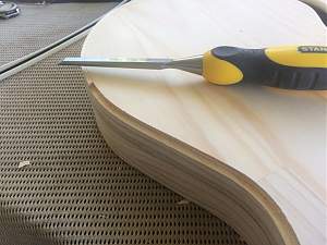

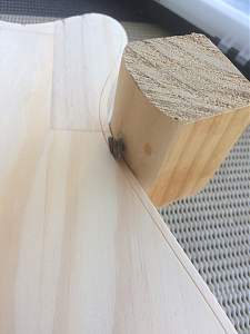

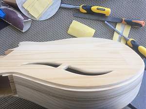

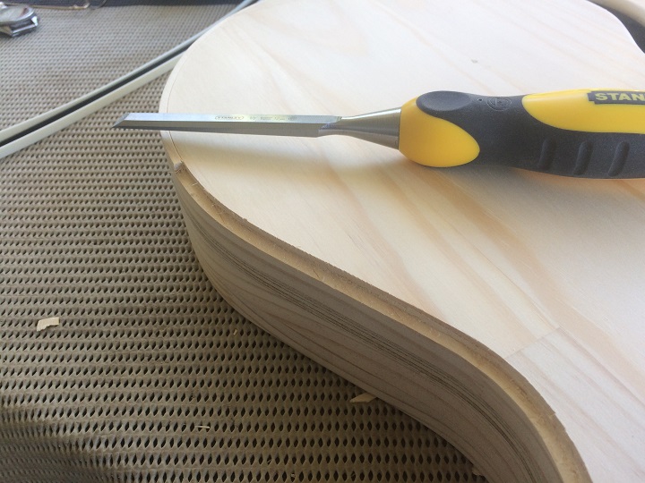

    First step in binding is to cut a rebate.
    Anyone who is familiar with my previous build will remember my “poor man’s” Beading Tool. So out it came and once again. Its simplicity, accuracy and effectiveness made scribing the cut line a piece of cake. By lightly filing down the head of the screw it ends up with a nice sharp edge and it cuts fairly deeply into pine and leaves a great line for the chisel to follow.
    After a few hours with the chisel the job is basically done. I still need to go over it with some sandpaper just to make sure the levels are spot on, but that can wait for another day.
    My next job will be a bit trickier. The binding itself.
