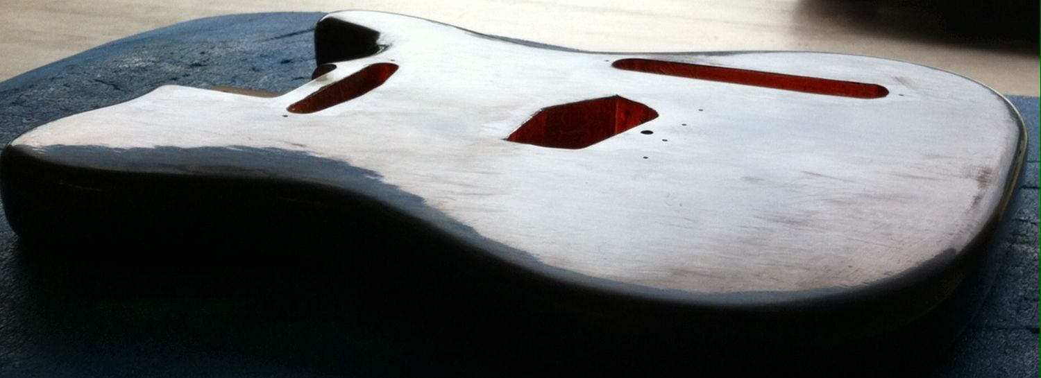

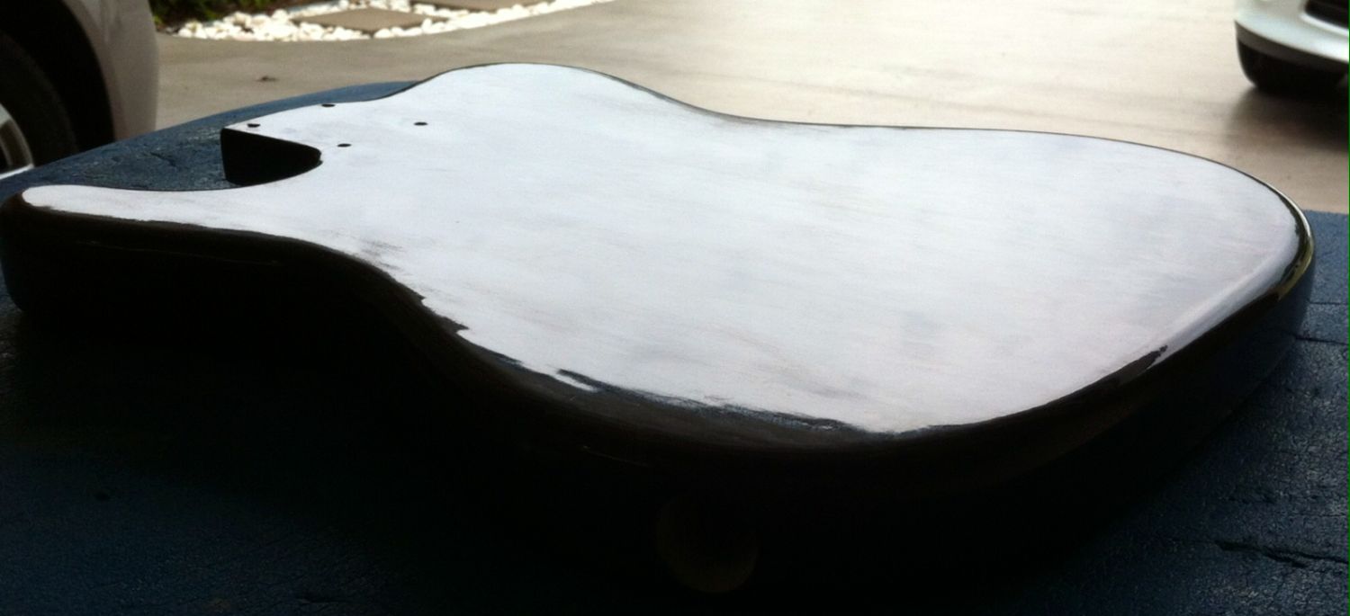

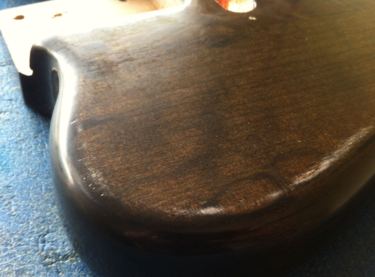

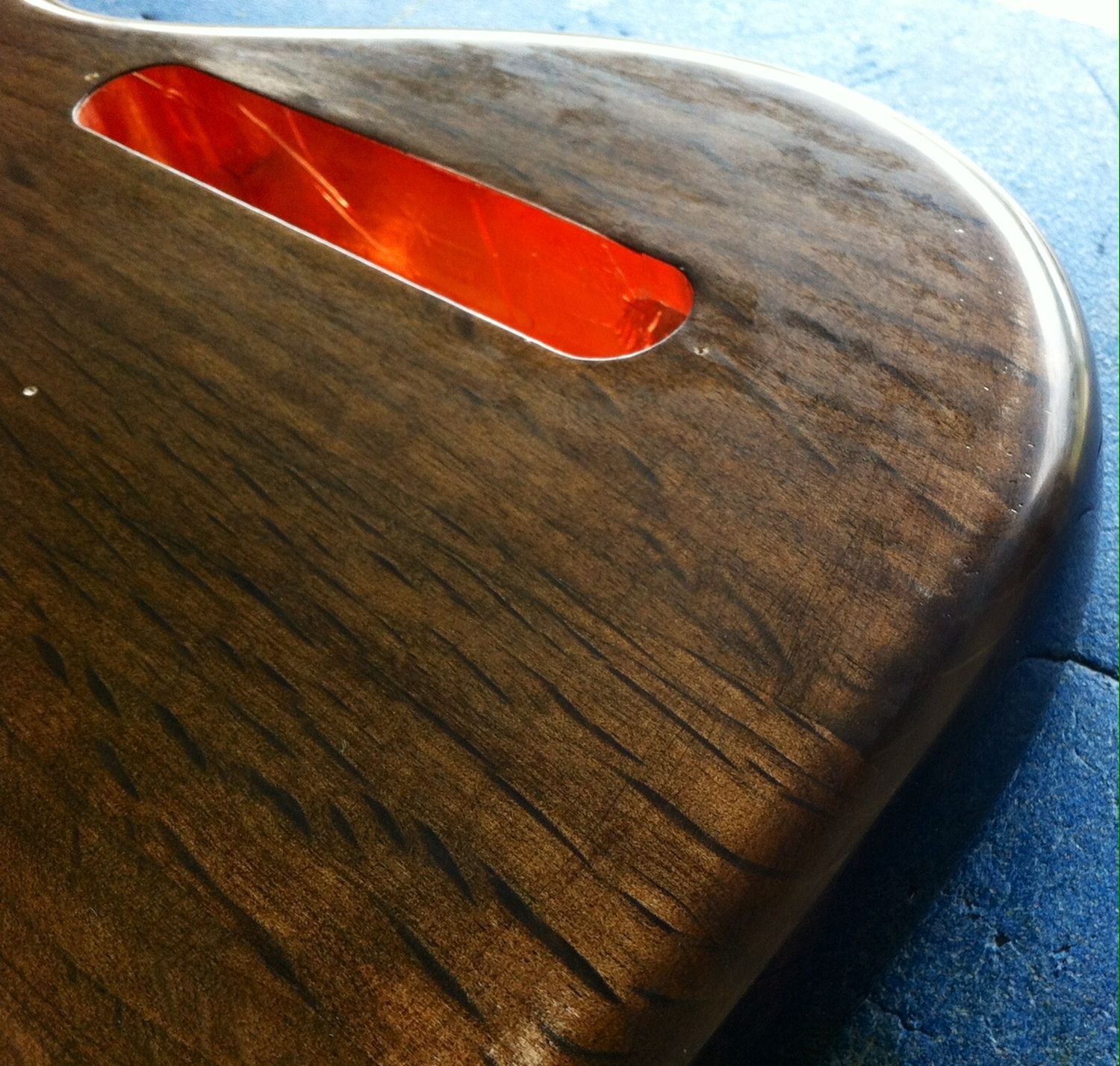

    Yeah Andy,
    It went something like oh $#!& then @%*! it.
    Totally dumbfounded and here is the evidence......back undamaged
    Nice and glassy with just a few touch ups happening around some of the rounded edges.

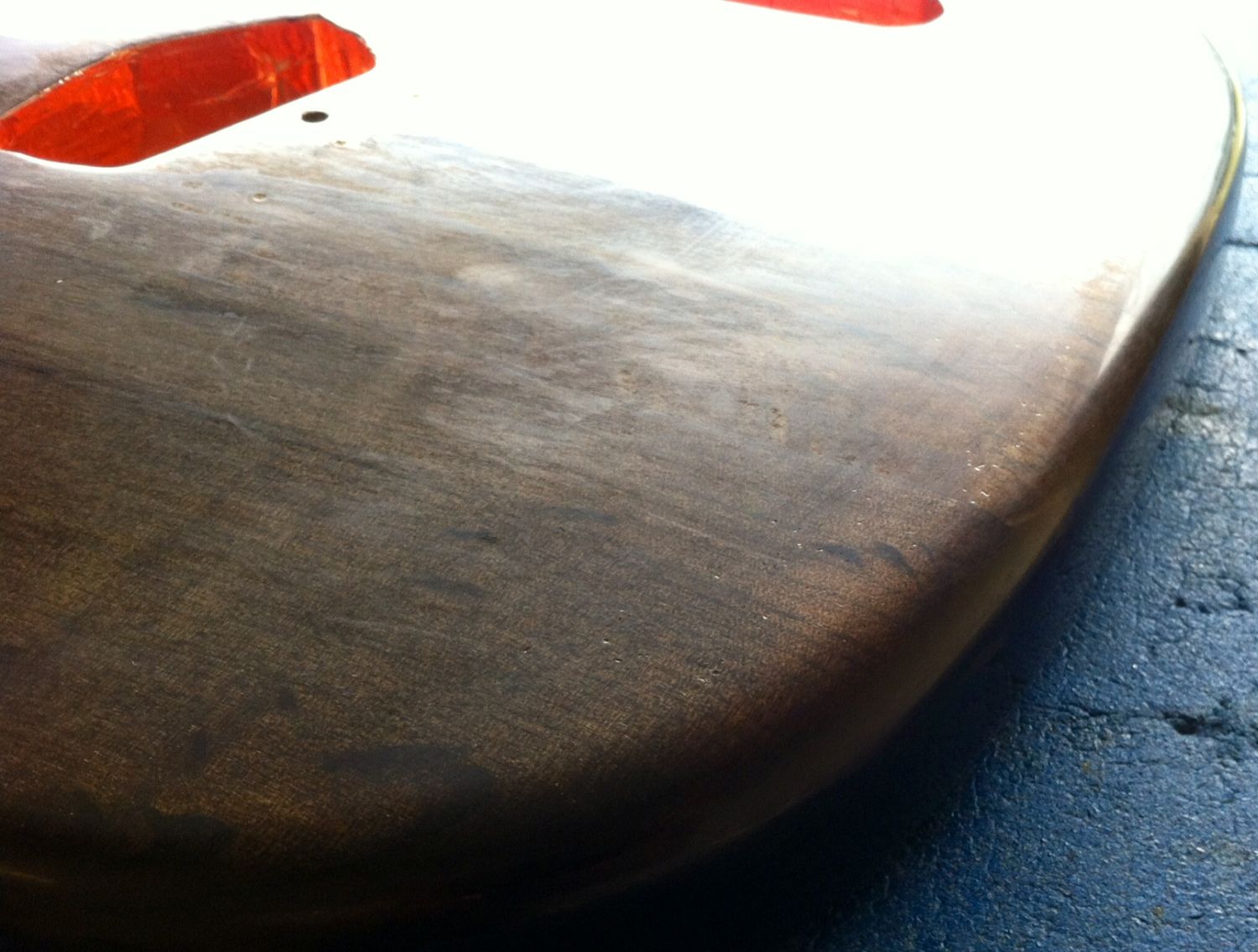

    Here are some shots after the wet sanding session. Unfortunately some dings are quite deep and cannot afford to sand any more as it was already starting to hit bare timber and strip some of the chemical wash.
ID:	19181Click image for larger version.
ID:	19182Click image for larger version.

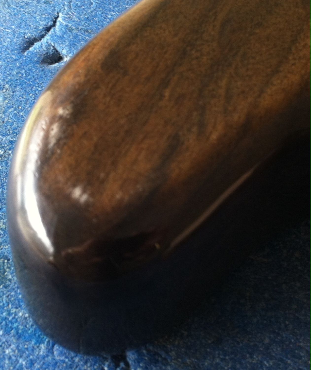

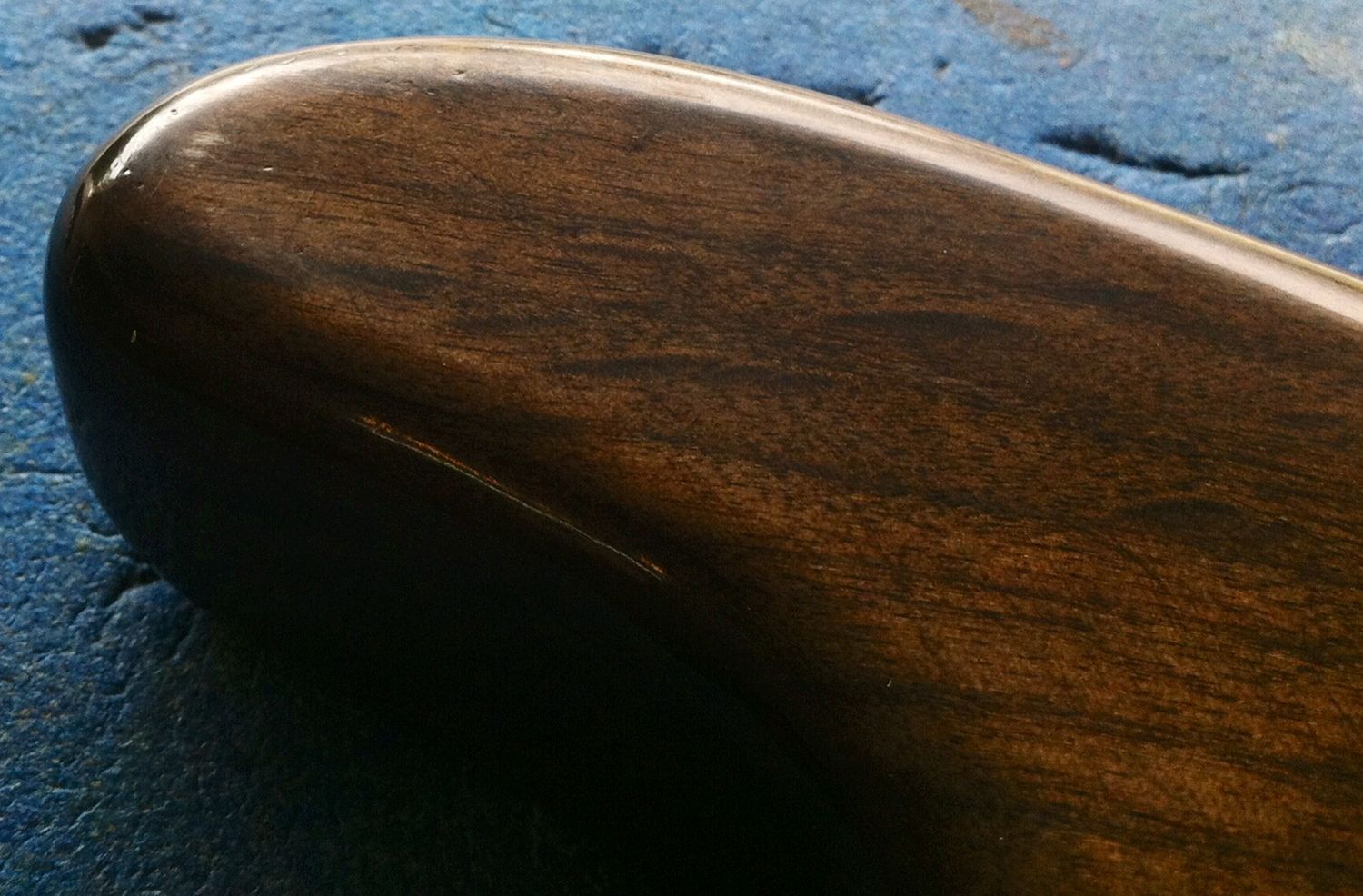

  10. #100
    Extremities seemed to cop most of the fall...
Name:	Lower horn 1.jpg
ID:	19185Click image for larger version.
Name:	Lower horn 2.jpg
ID:	19186Click image for larger version.
    Put on quite a thick TO coat about an hour ago and hope to put down at least one more later in the day. This has probably set me back another 10 - 14 days and the upside is there could have been lost more damage so I should be grateful for the minimal amount there was.
