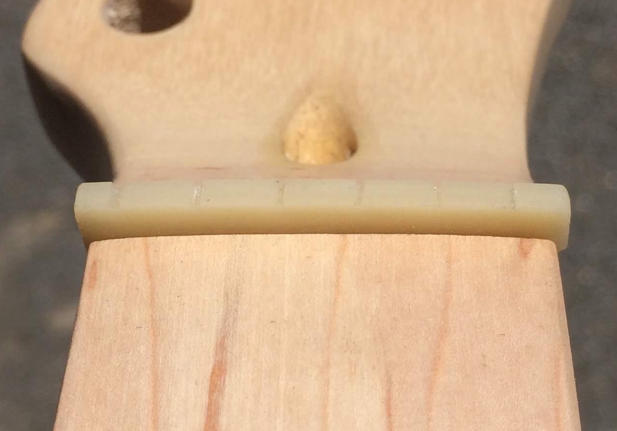

    Okay so I’ve filed down the bone nut to fit the slot. It’s obviously a bit long as well - do I just try and take an even amount off each side until the edges are flush? And should the edges be square, or taper to make nice curved ends on the top? Click image for larger version.

    Typically you leave it long and unglued until you finish the build, as string tension will hold it in place once it's strung up. Once you've got everything sorted (intonation, action, string position down the neck etc) then you can mark the ends of the nut with a pencil, loosen the strings to slip it out and then sand/file it down to size. Sand down, test, sand down, test etc. until you get a nice smooth match with the sides of the neck, and then use a drop or two of glue to fix it in place.
    I normally do this as the very last step, usually a couple of weeks after assembly and setup, once everything has settled down and I'm certain I don't need to adjust anything else.
  7. #97
    Thanks Scott, that makes a lot of sense. It's still really quite tight in the slot so I'll have no problems with it staying put.
