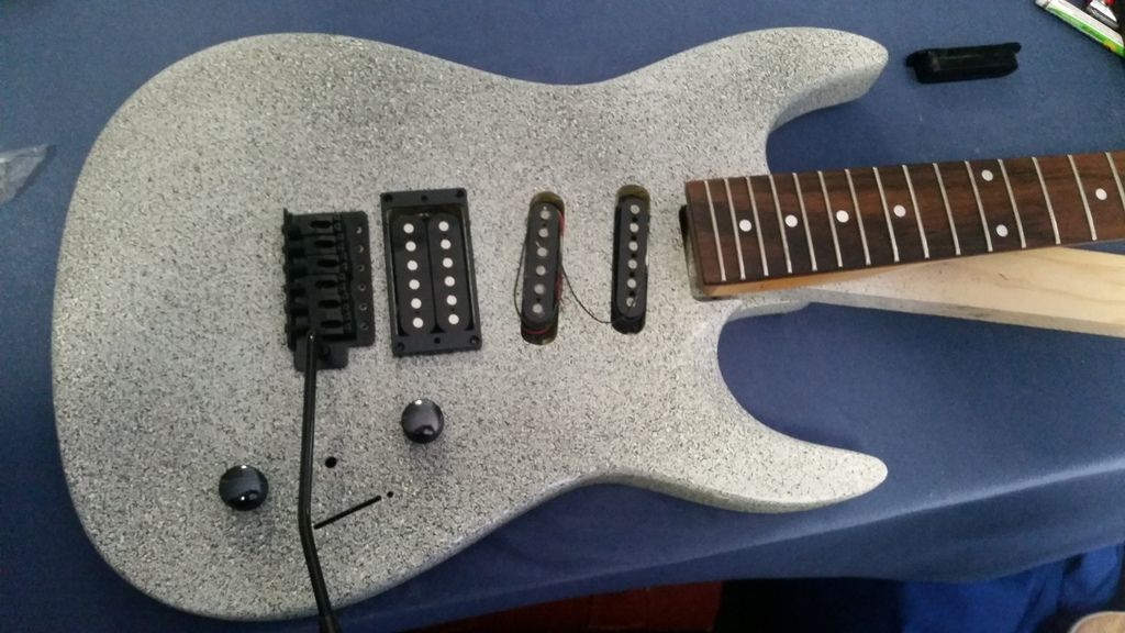

    I did a quick mock build this morning. Doesn't look too bad at this stage, but I have applied a second coat as well, and it has darkened up a bit more.
    Before placing the bits in place, I gave the body a very light sand, and it knocked the high points off pretty well, and making it less prickly, and more like the pebblecrete you mentioned. Around the edges though, I removed it completely, so it is pretty fragile. The second coat filled everything in nicely, so you can;t even tell where I stuffed up.

    Sounds good and the splatter effect might just work and you can find cheap acrylic stuff in Officeworks, Spotlight or any craft supplies store.
    Again, as always, test on scrap before attacking the project guitar and also apply some clear top coat to see if it reacts with stuff used for splatter effect. If no reaction you should be good to go as I presume your spray cans are acrylic anyway?
    EDIT: Just saw your mock build and love it just as it is. I reckon run with the minimalist approach here where less is more on this one.
