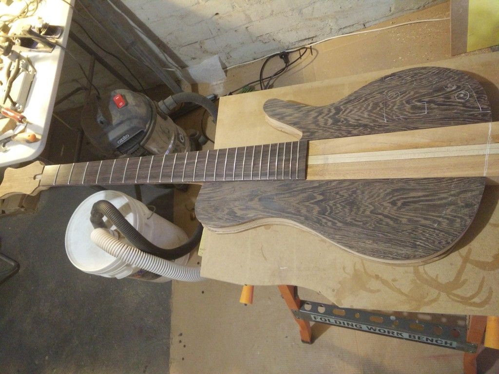

    Cut out the body wings. Couldn't resist a mockup.
    I'll show the process of how I managed to get clean edges without having to create an additional set of templates soon. I can't get perfectly straight edges because my jigsaw struggles on thick pieces and the blade bends outwards and the bottom always ends up thicker.
    wow thats looking wicked Simon, will you be able to reach the high frets with the massive tele style upper horn ?
    what are the wings again is that wenge or walnut top ?
    Thanks woks. The upper frets should be okay to reach. I can always reshape it later on.
    The top is wenge.

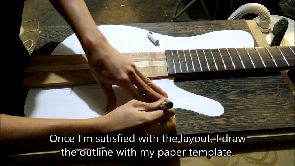

    So I started off by choosing the best figure on the wenge top, which is 10mm. Then I used my original design plans and traced them out on the wenge.

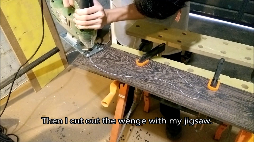

    Cut it out...

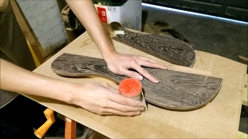

    The ideal way would be to glue all pieces, true the edges and cut the shape out with a bandsaw, and fine tune the edges with a random orbital spindle sander. However, since I don't have these equipment, I thought the best way would be to use the wenge top as a template. If I were to make another bass with the same shape I would've made a custom template.

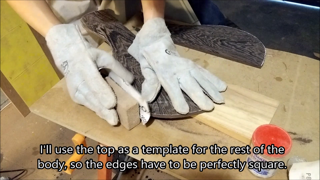

    This means I'll have to get the 10mm top perfectly flat on the edges. I placed the top on a shooting board and sanded the edges. Ideally a spindle sander would be of great help.

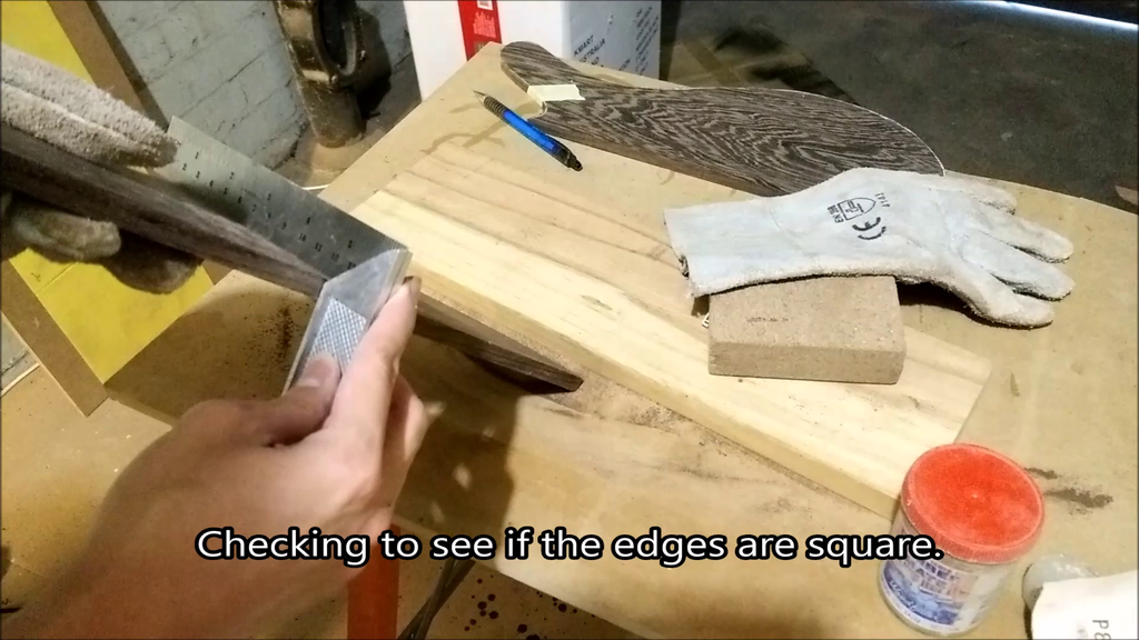

    And I regularly checked to see the edges are squared. This is important if I'm using the top as a template to route the entire body.
