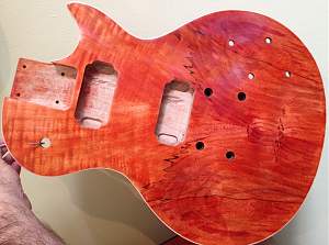

    Thumbs Up
    Ok so I rubbed it back with 0000 steel wool. I then applied a couple of layers of the Intensifying coat (I was all out af the stain coat thanks to the Darl getting her hands on it and doing a little craft work.. ).
    I think I may have lost a little of the colour intensity, but it still looks ok. It's just put my build back 5 or 6 weeks however.. I've still got to reapply the finishing layers, so I am at least a month off putting it together sadly....
    PS.. Happy and Safe Easter everyone
