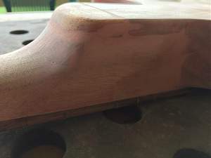

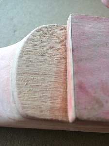

    In more cheerful build progression, the neck gap block has been timbermated and sanded.
    From this:
    To this:
ID:	4956Click image for larger version.

    And the alternate concentric pots and knobs (suggested by WierdBits who kindly demoed their installation on a 6mm fascia) have arrived. This means adding one more hole to the control area and there'll be a 3 pos switch and two vol/tone pair pots.
    Then some contraption to hang it out in the shed and I can begin the spray.
    - Sam
    IB-6S - done.
    The neck heel looks a lot neater, nice transition.
    Just need to remember to install the strap pin back from the edge so it is not pulling on the glued in section. Just to be cautious.
    - Sam

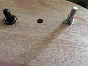

    Drilled the holes for the controls.
    Switch for neck (up), both, bridge - then tone (top) and vol for neck - then tone and vol for bridge.

    The allparts switch 5/16" thread is a fraction too short so I expect to get the switchcraft version which has 11/32" thread. Might still get to use the black washer and nut.
