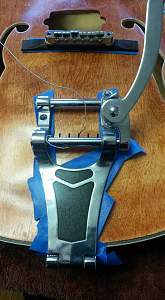

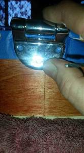

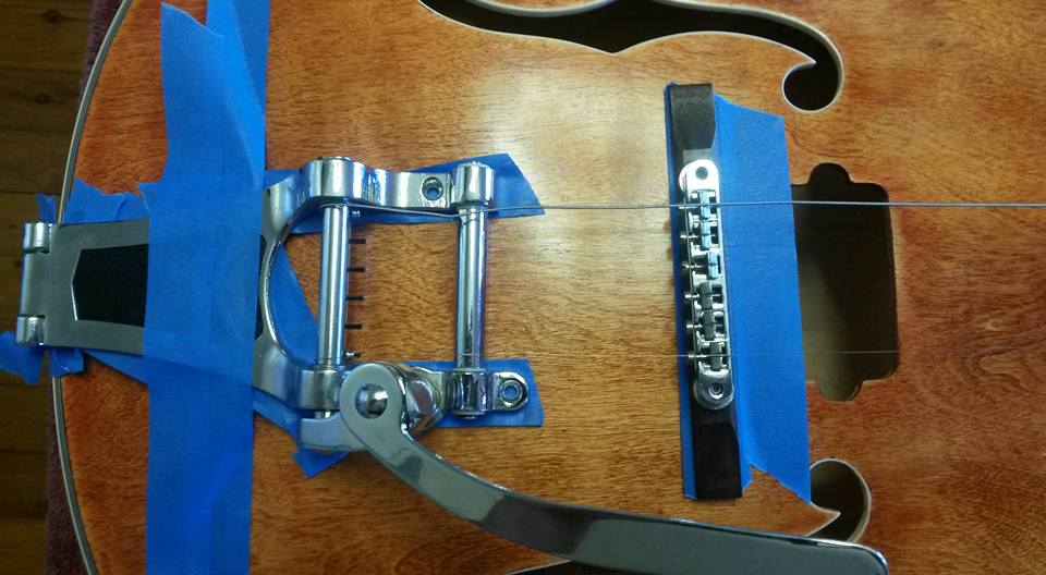

    1. Mask back of the bridge temporarily so when you slide things around you dont scratch the finish
    Temporary floating bridge.
    2. Tape bridge and tremolo in place temporarily.
    3. Line the strings up from trapeze, over bridge, along neck.
    4. Mark trapeze holes on the body. Laminate is not necessarily the centre.

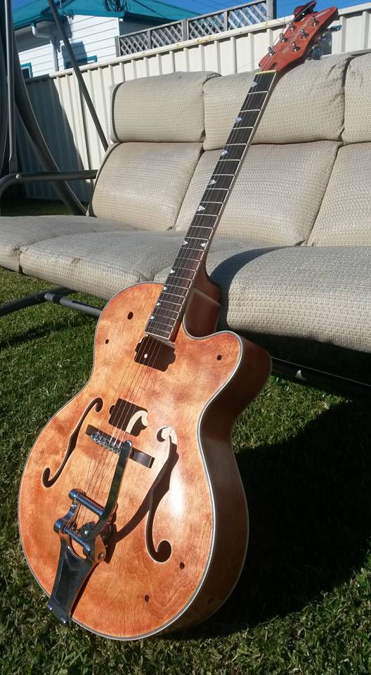

    I was bloody stoked.
    It plays ok.
    The strings dont buzz on any frets.
    The strings dont fall off the neck.
    Bigsby style trems are still horrible.
    I'm waiting on a floating roller bridge which may improve things.
    The action is way too high at present, but the neck angle seems good.
