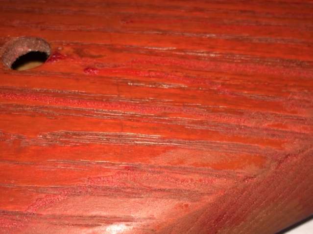

    Time for another intensifying coat on the body.
    The last one seemed to streak a little.
    The streaks seemed to originate at the edge of the cap. Perhaps I overlapped and built too much up when I did the front and then the side.
    I sanded the streaks off with steel wool. Gave it another coat.
    The coats don't seem to be leaving an even colour. The bottom half seems lighter than the top half - and there are some patches that are much lighter.
    Looking at the photos of the body before sanding I don't see any obvious reason for that patch to be coming up lighter.

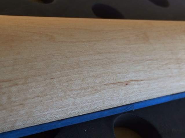

    Also, another neck top coat done.
    Not really seeing anything build up here yet. Still just looks like the bare wood.
    - Sam

    You can go over the lighter patches again Sam on the next coat, dunno about the neck!

    hey Sam, sometimes different parts of the ash wood take more stain than other areas. Might be worth rubbing it back lightly with about 600 or 800 grit paper and try and even out the colour a bit more.
    Also DB recommends you wipe over the body once and don't over work the stains.
    How many clear coats are on the neck ? I'd just keep applying and steel wool in between hopefully will build up over more coats.
    Also keep the coats thin and allow plenty of curing time about 4+ days in the cooler weather

    I only gave it a single wipe for each coat that I've applied, except I think I may have overlapped at the edges. It's also possible it gathered in the join of the cap and ran from there. I'm all out of intensifying coat now, so hopefully I'll be happy with this latest coat.

    Wasn't really a problem I was raising about the neck, I was just commenting on how it can't really be seen. I expect to do a couple more coats there.
