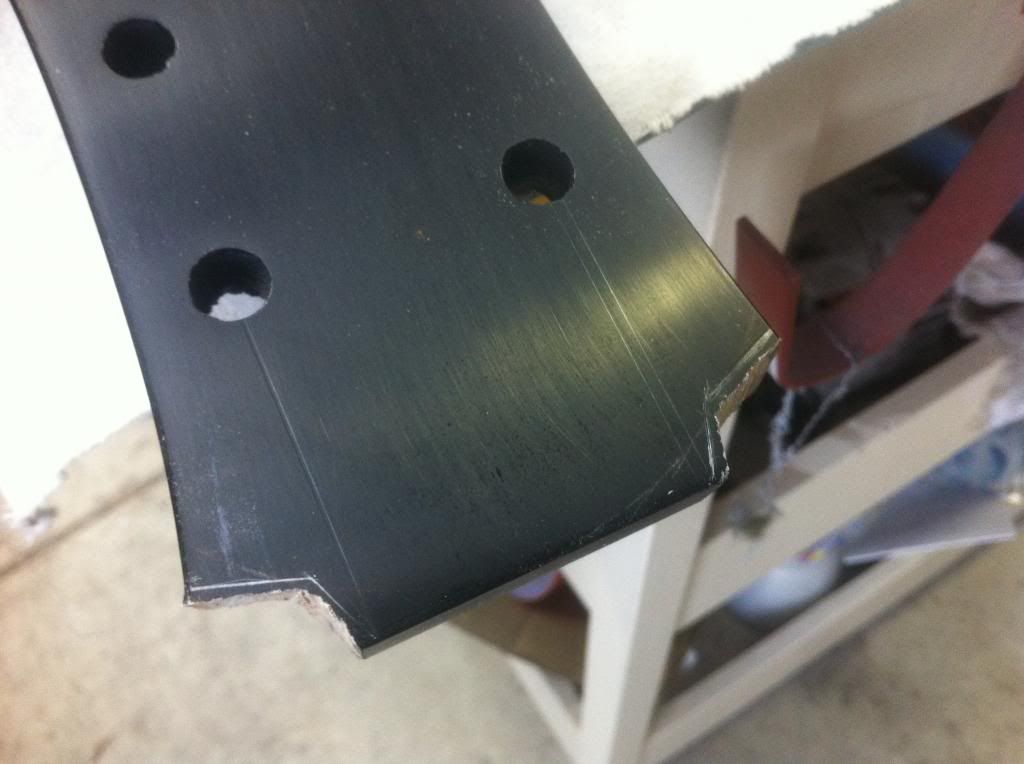

    So, it was time to shape the headstock.
    Mark it out using rulers and pencils and stuff, cut with a hand saw (as I did, but you can also use a jigsaw, dremmel, laser, termites, whatever), but leave a bit to finish by hand. You could also use a paper template, tape, whatever works for you and gives the result you are after
    You get the idea. Leave enough fat to trim some off, otherwise , the smallest mistake will wreck the headstock - make a big enough error and you might need a whole new neck. (I'd try other fixes first, however Sod's law states you will destroy it...)
    So you end up with this, ready to be hand finished (I used a dremmel to get closer, then filed by hand):

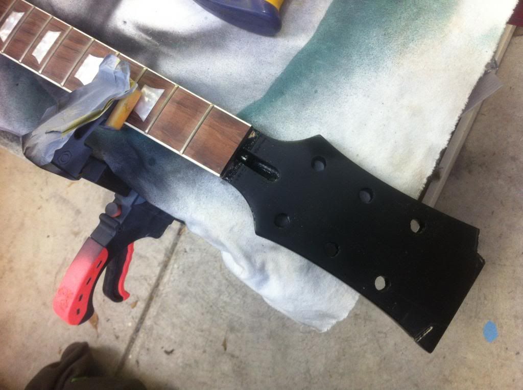

    NOW: here is the reason I have to keep refinishing the back. Notice in the pic above the neck clamped to the bench to keep it in place whilst I cut? The pressure has caused the fabric (an old cotton sheet) underneath to leave an imprint on the paint.
    This neck has only the satin black, no top clear. Acrylic. Helped along with a heat gun well after it was touch dry. In fact about a day after. The last coat was put on about 2 weeks ago, and the neck has been hanging in the shed since then...
    WTF! This is expensive Upol aerosol paint. It is good stuff. this does not come from the green shed that remains nameless. This has been sanded with high quality automotive wet and dry (wet sanded) between coats left a day apart between coats. It has been cold, but I am warming the paint and the piece to be painted.
    Now the body isn't clamped at all, it was just laying there whilst I did the top on a nice clean cloth (careful inspection of any overspray on the cloth in other shots will reveal the essence of the top colour...)for about an hour.
    All I can say is AAARRRGGHHH!!!
    Happy to hear from any of the paint gurus for this one. Can I put it in a cool oven?

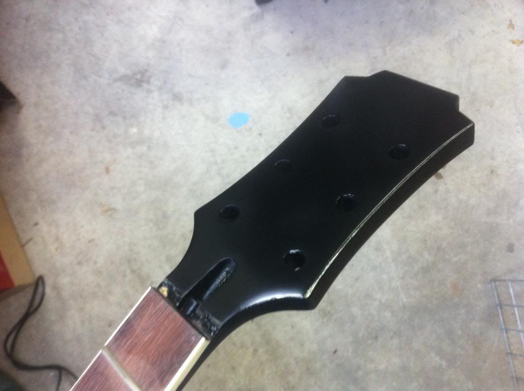

    Anyway, fixed this, hung the neck up, and here is a look at it - not fully finished, but you can see the result:

    I can't say I've seen anything close to that on a LP headstock before but it really works man, that satin's gonna look insane.
    Making progress now!
  8. #98
    Nice headstock Stan - simple and effective! Well done.

    If the paint is thick Stan it can take along time to cure.
