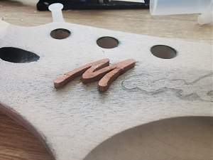

    Welp, that seems to work. A bit of a mess up close, but have happily embedded the M. It broke again, of course, but that's okay. So the plan now is to complete the "routing" for the inlays and then CA glue them in. Then I'll pare off the excess and fill all the tiny chipouts and mistakes with maple wood filler.

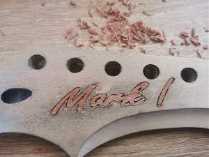

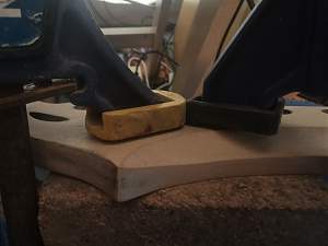

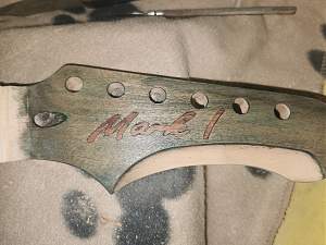

    It took a while but I successfully hand routed the cavities with scalpels. Overly successful in fact as you'll see. I glued them down with CA glue and clamped with a cork sanding block under the headstock. The CA didn't take successfully in a bunch of spots, so I had to run more in. I was hoping not to get any CA along the edges so I could fill the gaps properly, so this might mean more work in the future.
    I have a backup plan if this all ends up looking awful.

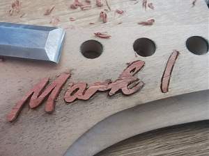

    Everything is glued in now and my chisel is pretty sharp. I started paring away the top to level it all down. You can see how badly the hand routing came out. With way more practise and time I think this is entirely possible, but I'll never be doing it again. I've ordered a set of 0.6 - 1.5mm dremel end mill bits and a precision router base.
    Pared pretty flat here. Loads of gaps on the edges. Not really very happy with it to be honest, but I have a couple of contingency plans available.
    I've gap filled and washed the entire headstock with a very watered down cedartone wood putty to try and get some colour consistency with the gaps.

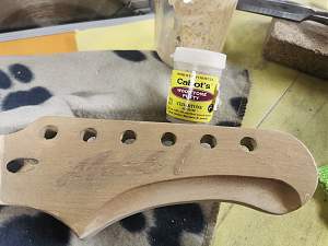

    There are some issues that will need to be addressed, I still need to sand flush and likely stain with the putty again to see how it looks.
    The main contingency at this stage is to impress a small channel around the lettering to embed brass wire or thin sheet into.
    At the end of the day I'm planning to paint the headstock, so it might not look too bad when all is said and done.

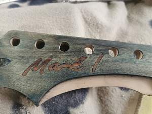

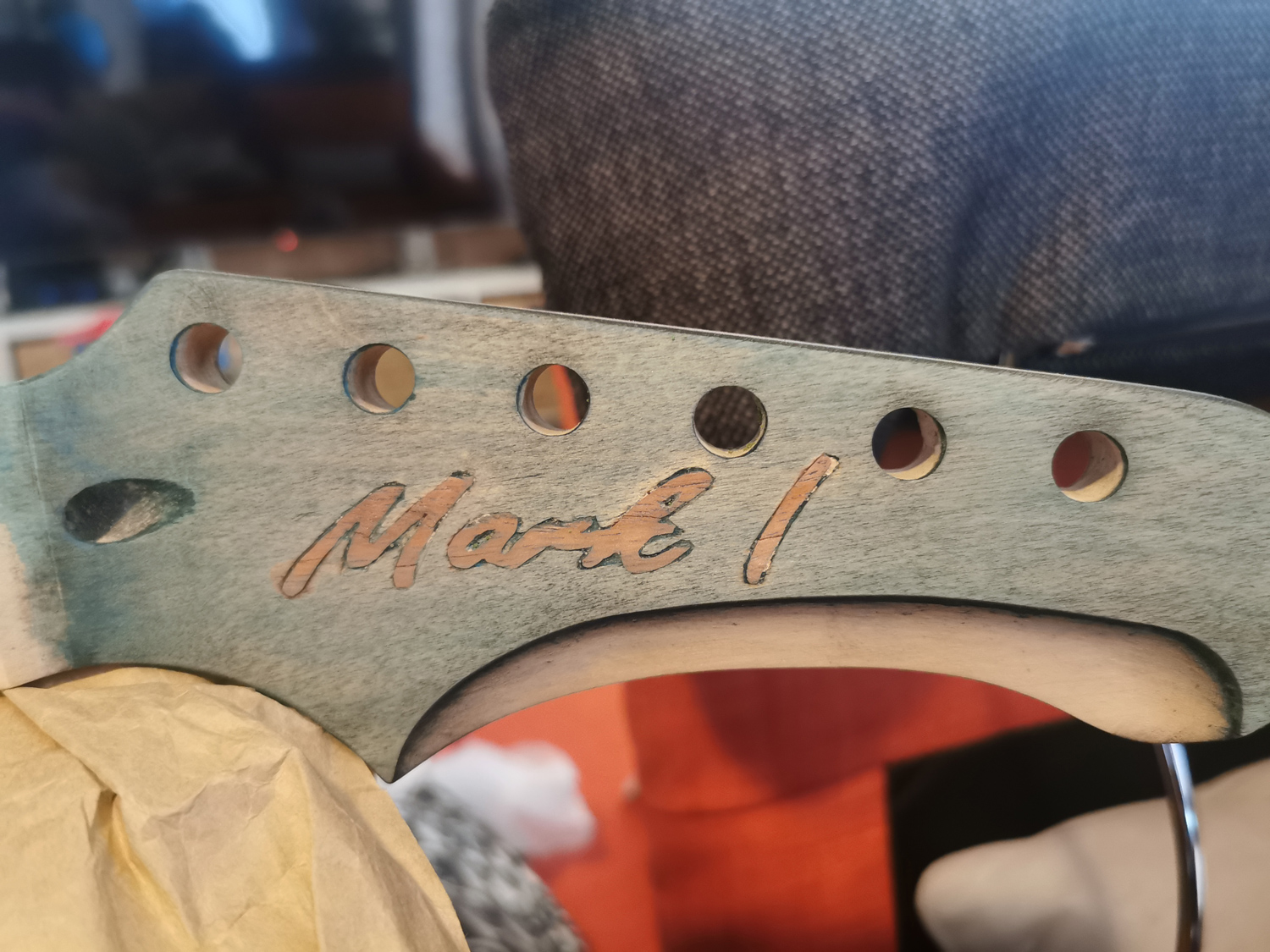

    Welp, I may have stuffed up slightly. Yes the dark wood is a good contrast to the bright maple. But it's a crappy contrast to the paint which matches the body. I tried various combinations and strengths of the paint, including even sanding the inlay with a fret eraser, and no bueno. Me no gusta.
    So, I'm down to two options. The first thing I'll try is a brass wire outline for the lettering. If that doesn't work I might veneer the headstock.
    Option three is to get/make another neck I suppose =) I was considering making one anyway, just so it could be a "complete" scratch build...
