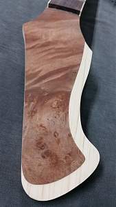

    Well, after some scraping, sanding and swearing (lots of swearing) the first veneering attempt has been removed. Might need to have some Turkey 101 on hand for the next attempt.
    On a positive, have shaped and glued the veneer to the HS. Used the tape and super glue trick to stick the veneer to the caul I made and sanded it to shape, carefully, then used a putty knife to separate the pieces. Then used painters tape to mark the position for it on the HS, thought that if I used pencil to mark the outline it could be a problem to get rid of the marks after the veneer is on. Seemed to work well. Will look a bit strange if I don't get the body done as well.

    Hide glue is good, just be aware that it has a short open time so you need to be super organised..
    I would only do one half at a time to make sure the glue isnt setting before you lay the veneer.

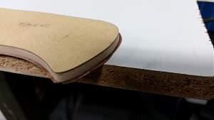

    More adventures in applying veneer. Got hold of some hide glue and had a go at the control side of the body. Trimmed the straight edge back to straight and taped into position. Applied the hide glue, lay the veneer in place, slid into the vac bag and used the vac bag to pull the veneer flat. Then a sheet of melamine on top, old socket set and bbq gas bottle for weight and left it for an hour and a half.

    Took it out of the bag and the mid section wasn't quite flat onto the body. A layer of wax paper, some timber and clamped it all down. Left that overnight and looks to have worked.
