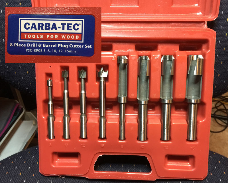

    I bought me one of these sets for exactly this reason.
    nice one Muzza, what are the PBG tuner holes, does a 10mm plug fit ?
    At least you can use the offcuts from the shaping of the headstock.
